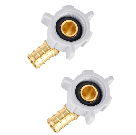

I also just recently had to replace the water manifold which was a big PITA. I needed a bunch of flair it swivel seals that had to be replaced when repairing those PEX connectors like these:
I’ve been able to repair many poor connections in the bathrooms, kitchen sink and water heater.

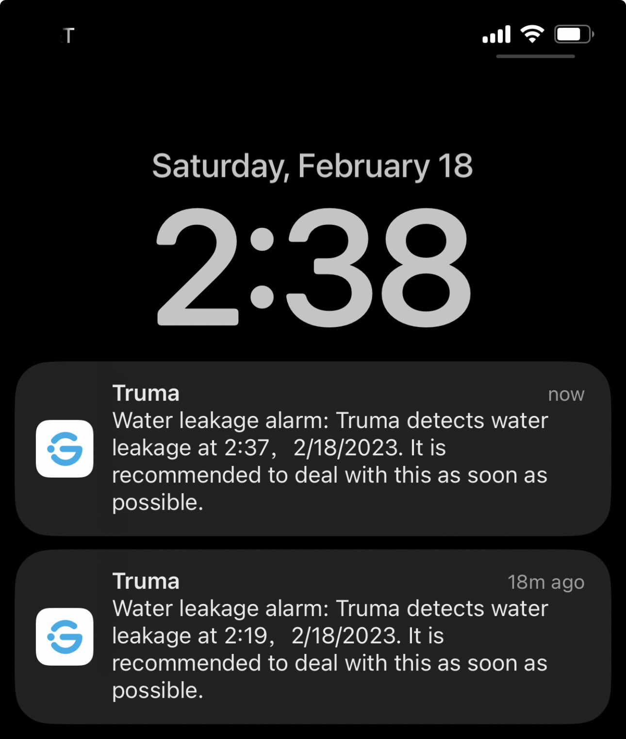

I had a lot of leak issues the first year we were full time on the road but fortunate for us and thanks to Govee water detectors we never had any kind of saturation. Once I received the alarm every time just had a drip or two and opportunity to make the correction. I had around 15 sensors in the rig at every point where water could gather or under high opportunity areas. Nice thing about Govee is you can adjust the volume level of the alert or completely silence it at the device and depend on the phone alerts both while in the rig or out to dinner. Not promoting the Govees just saved our behinds many times. The screenshot I attached demonstrates my leak alert at 2:38 AM one morning.

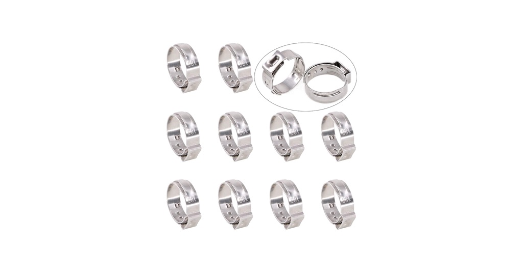

If you are looking for the correct crimps for the white hose you can try these:
Swpeet 35Pcs 15.3-18.5mm 304 Stainless Steel Single Ear Hose Clamps, Crimp Hose Clamp Assortment Kit Ear Cinch Rings Crimp Pinch Fitting Tools Perfect for Automotive, Home Appliance Line

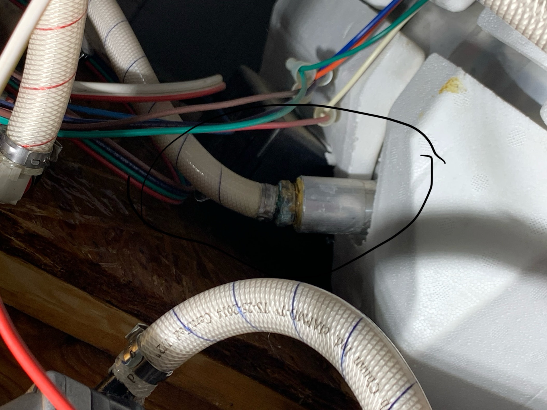

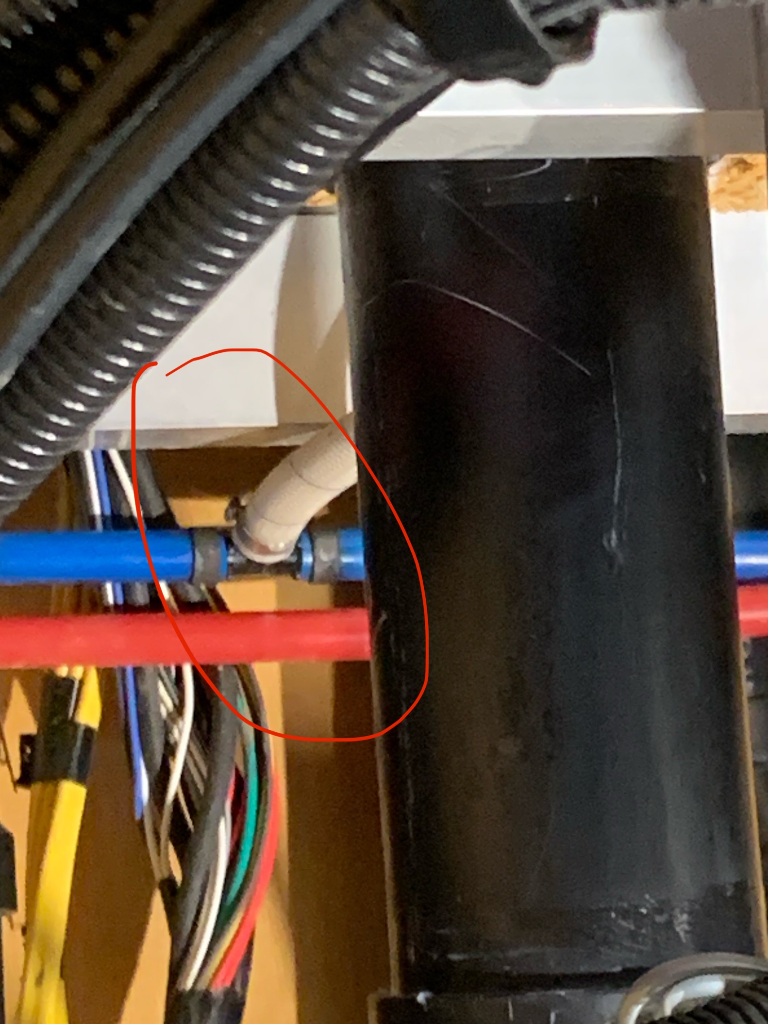

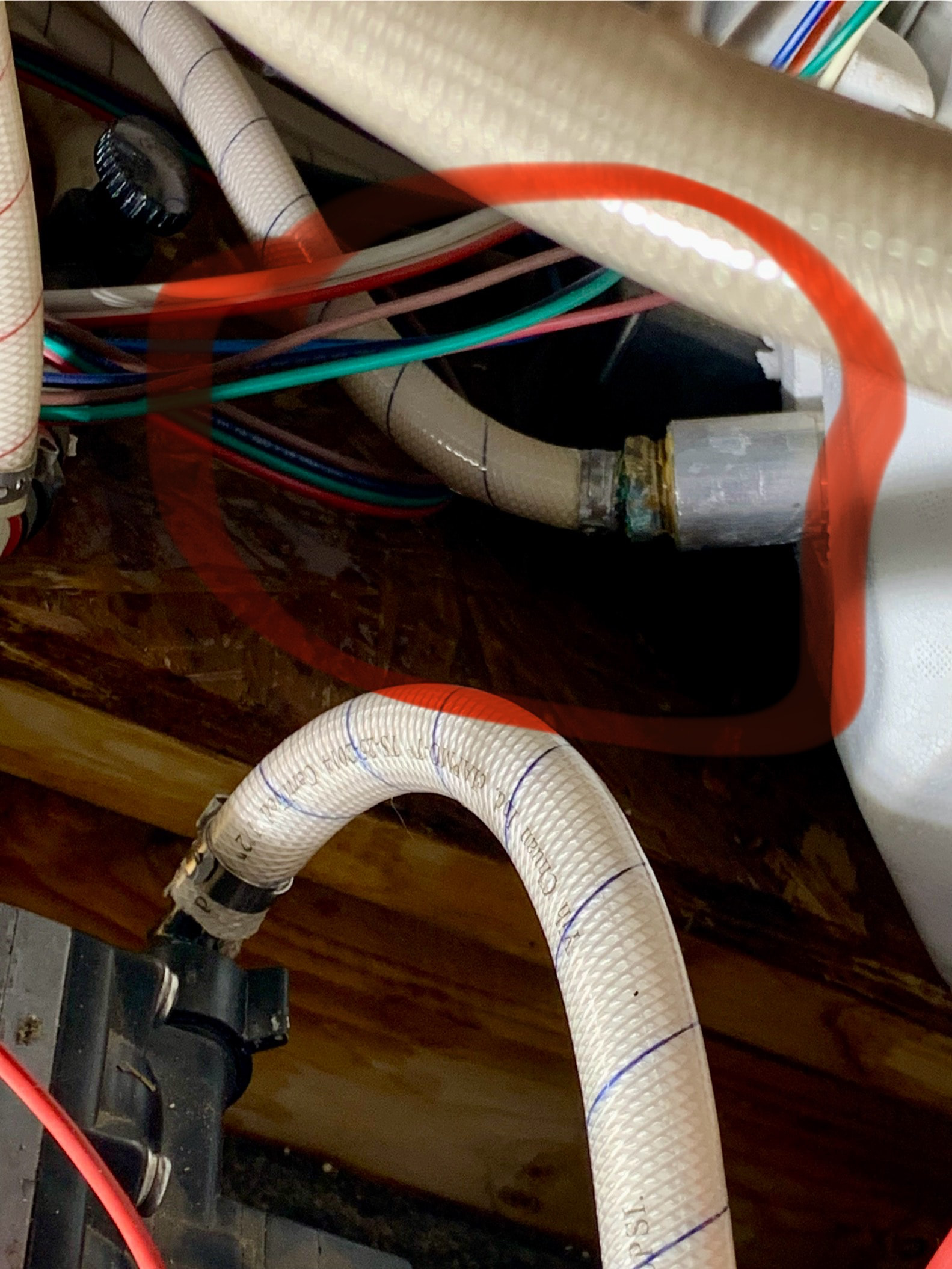

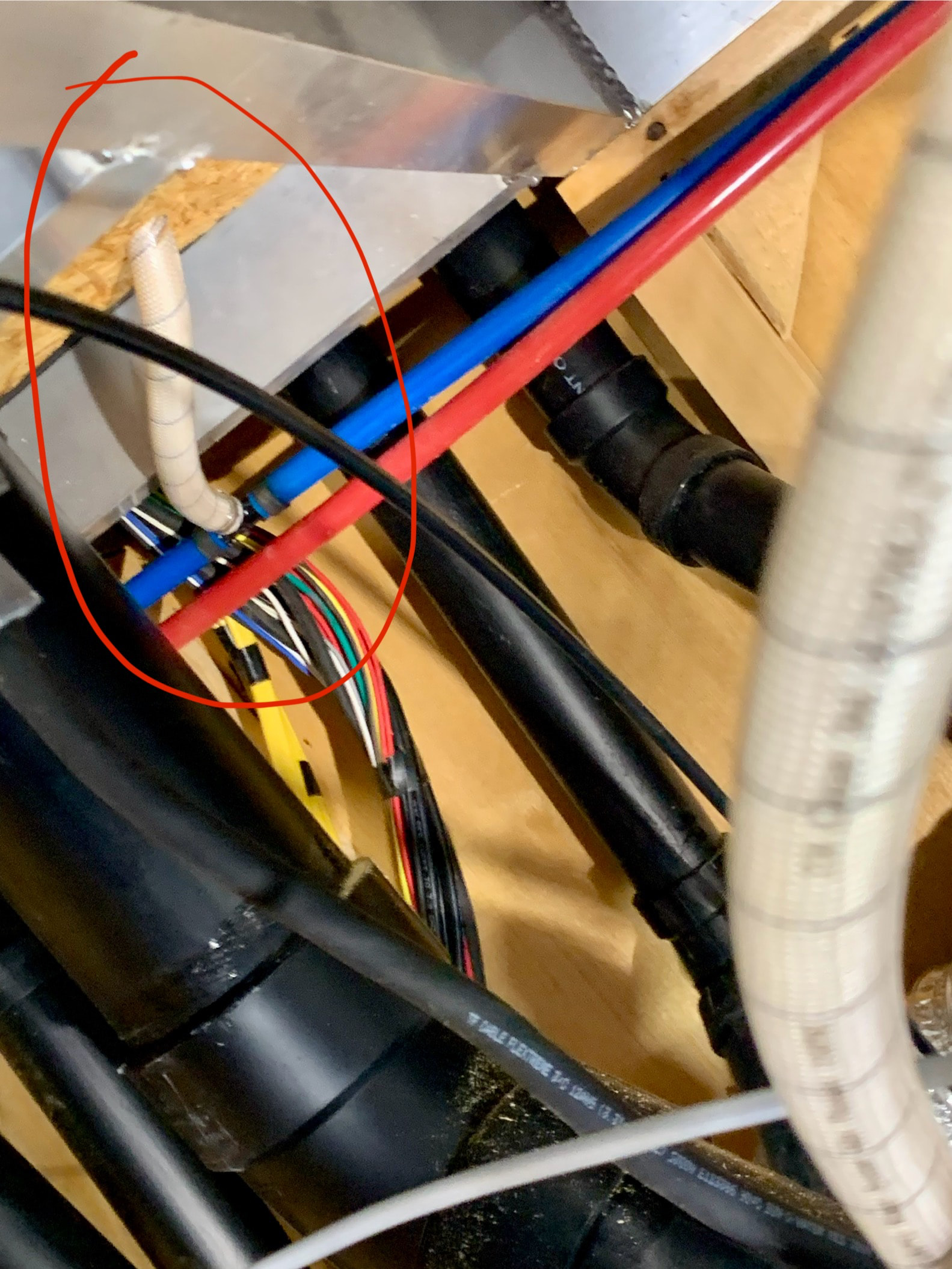

Hi Ralph so story goes my water heater connection burst a leak so I ended up having them replaced for pex which does look cleaner and hopefully no more leaks.

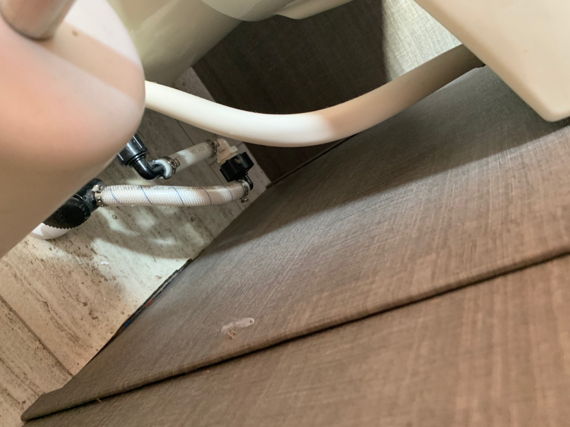

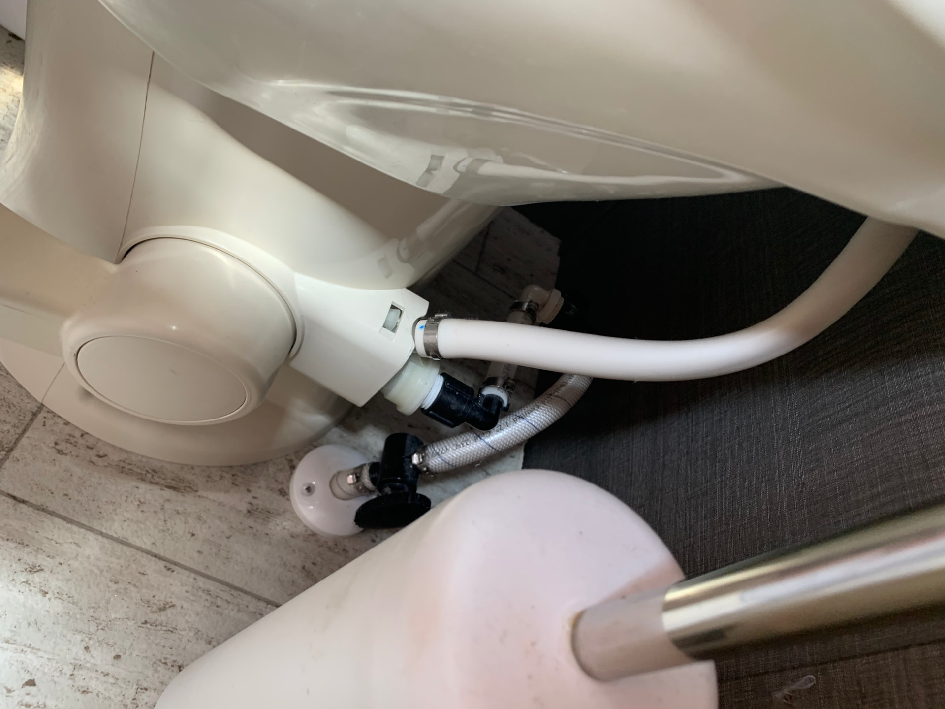

I do have a question for you how did you connect up to your toilet as I have a pex then a converter back to flex piping to the back of the toilet and to be honest the pex always get loose around the toilet. Pictures of possible thanks
Lynn Im having some challenges can you let me know the shopping list for you to replace all of the above and especially how you did the toilet pex to flex pipe
Actually the connection was made by the factory. The pex goes through the floor and I will have to investigate it further later.

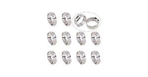

I had a pex crimp ring tool, I did not use it much because it was to awkward in tight places. I mostly used the stainless steel crimp rings you pictured above.

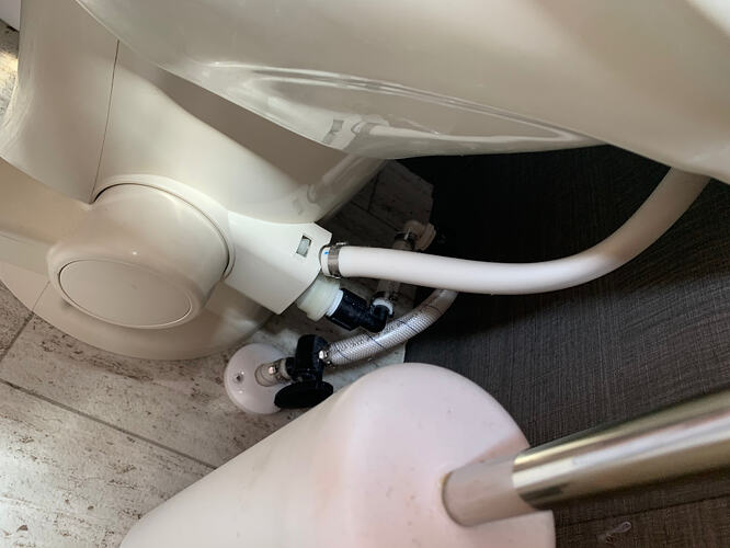

If I do anything with my toilet, I would probably buy a braided stainless steel line, attach it to the toilet and drop it through the floor to the basement and connect it to pex.

Are you using a male to female connector transitioning from pex to the flex line? Maybe, depending where your pipes run, you could fasten the pex pipe to something to keep it from moving around.
Great idea with the toilet go stainless I’ll send a picture of my connections

The great toilet connections may be an upgrade for next storage as Im on the road suggestions appreciated as the pex behind the toilet always come loose
toilet connections
