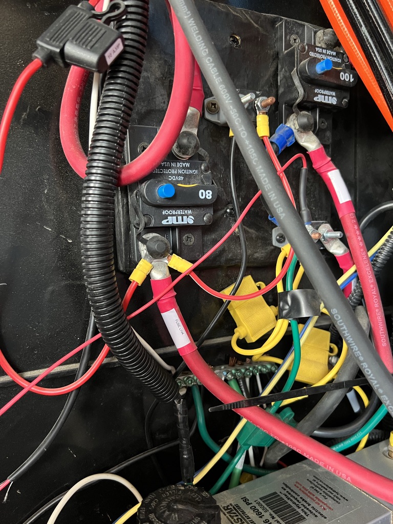

I know you mentioned the fuses had been checked, but did that also include the 80-amp breaker in the front compartment (generator area)? Those are resettable breakers in case it had tripped. You mentioned the touchscreen panel was black, is the mini control panel on the front outside non-responsive as well.
Hydraulic breaker for slides and leveling
