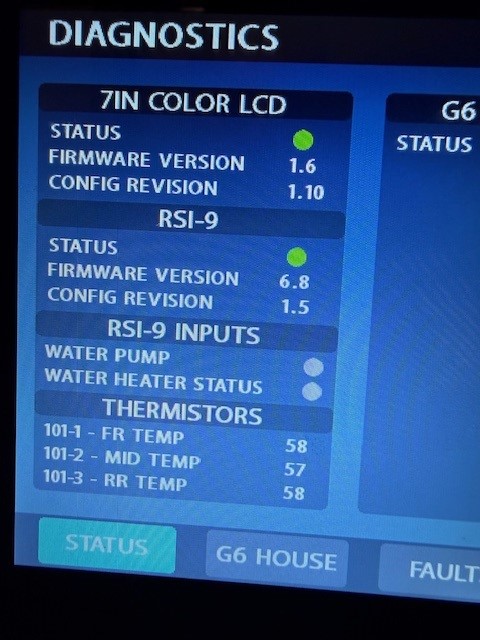

Both the Bluetooth Mira and WIFI Eclipse modules should be plug n play on the G6 from my conversations with Firefly. It wasn’t a standard installed option though. You may need to upgrade your software versions. I had to take photos of my touch screen displays and email them to firefly tech support. They noticed that my GUI version and RSI-9 versions needed updated, From Tech Support email: “Mira is not compatible with the software revisions you have on your screen or RSI-9. The minimum requirement would be GUI 1.11 and RSI-9 config 1.6”. They sent me the updates via email. I had to put them on a thumb drive and plug into the back of the touch screen to upload. After doing that and installing the mira module it worked. I had gotten a used mira module from my coworker that has a tiffin bus. It wouldn’t work properly. I sent it to Firefly and they flashed it back to OEM for 89.06 with return shipping. With software update and fresh flash it connected and worked perfectly afterward.

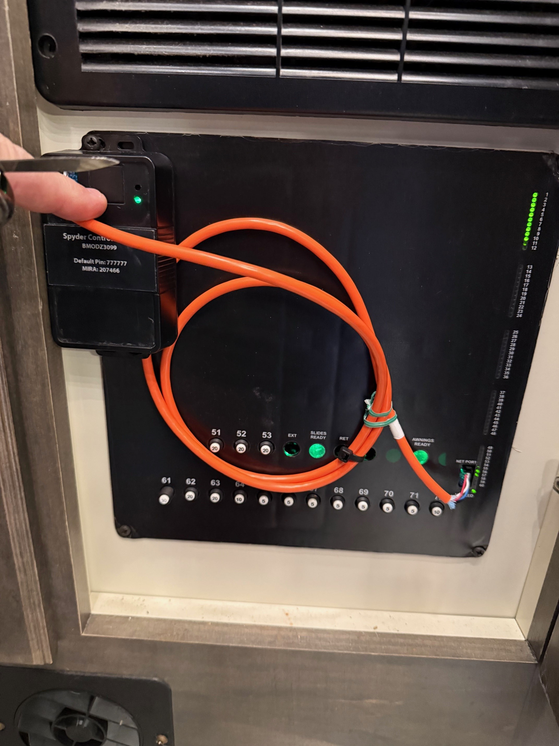

Below is a photo of how the modules install on the G6

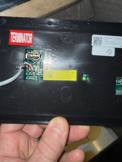

On the back of the touchscreen you will see a usb port. This is where you insert the thumbdrive to update the software.
The diagnostics screen will show software versions.
