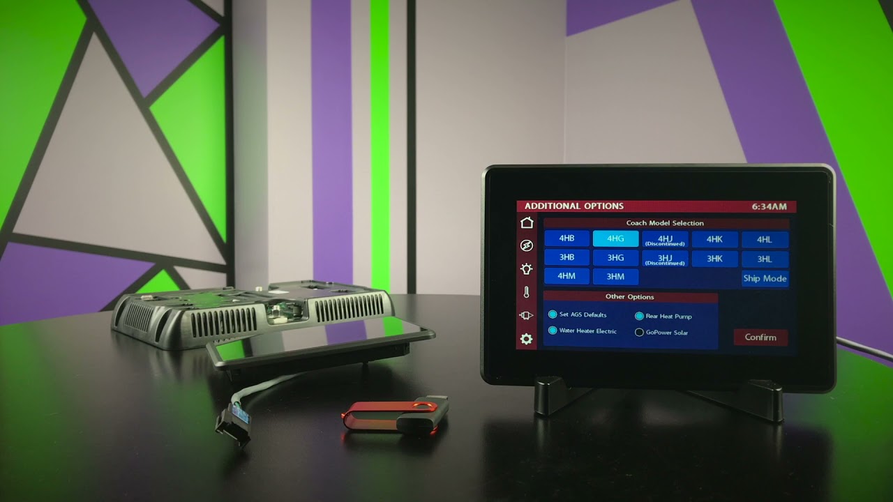

My coworker just upgraded to the wifi module on his Tiffin 401p. He brought me in his BT module and cable to try out. Is it as simple as plugging it in as shown in the photo? I know how to turn on MIRA in the touch screen. He brought me the non ethernet BT MIRA module and the orange cord.

When I bought my Eclipse module (wifi) in 2021 for my 21 Beacon Firefly sent me a thumb drive to update my G6 before plugging it in. I didnt have the option in my screen to turn it on either before or after the upgrade. I didnt try it without the upgrade but since then I have seen those devices be resold over and again and owners plugging them in with success.
If you already have the option to turn it on - I would reset the Mira using a paperclip to reset the PIN, download the MIRA app and plug the device in. I am betting you will have success. Let us know how it works.

@RyanB I reset the module. Got the mira app turned on. I connected reset pin and it couldnt automatically detect my rig.
i called firefly tech support. He gave me the manufacturer code 782832 i entered that and it brought up options for v1 v2 v3 v4 v5. He told
Me to use v4 it didnt work correctly.
I clicked on v3 selected 320 it loaded. All the light controls work correctly but missing sconce and closet lights.
All other options worked.
Except the app controls the incorrect ac units.
Maybe i need an update or maybe the module is in correct for my rig?
I dont think the module could be incorrect - they use the Mira and Eclipse interchangeably across all installations. I was in a Brinkley G series today and they use the same Mira module that came standard on the 23 Vanleigh units. I am sure if that device hasnt already updated it is needed but likely not going to correct those things that seem amiss. My Eclipse module seemed to require an update often.
My 21 34RLB closet lights were only turned on with a physical switch built into the light and the same as the sconce light in the living room. I would venture to guess that if your 320 has firefly switches for those that it was not updated in the Spyder in that model year.
As you have experienced the guys over at Spyder are extremely helpful I think I would hit them up on the AC swap issue.
These are all things I didnt experience with the install of my module. They gave me a thumbdrive that I placed in the back of the screen and went through a couple of prompts to load it and it was off to the races. They did give me this link to a youtube video to use as a reference during my “install” but was not relevant. They package they gave me must have had all of the options configured for my device.
I sent an email to support at firefly. Explained what all
I have done. Sent photos. Ill see if they have any solutions.
@RyanB Firefly emailed me back. After looking at all the photos I provided of my spyder touch screen settings. They said I need to update my spyder software to a newer version. They provided the software update files at no charge along with instructions.
