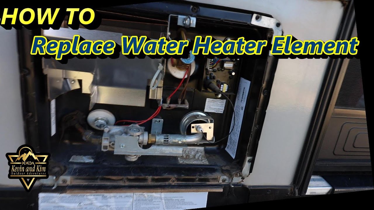

Hey Ralph - sounds like you checked the wiring and voltages and thermostat already. If the new control board doesn’t prove to be the solution, it could be the electric heating element itself going bad. This can go bad especially if they are used without water in the tank.
Another thing to check would be to see if there is excessive scale buildup inside the tank and the heating element. If you have a endoscope you could drain the tank and use that to view the interior of the tank to confirm. Then give it a good cleaning and flush.
If that doesn’t work, the solution is probably to replace the electric heating element. Here’s a video showing the process to replace the element.
Okay thanks Stuart, I had ohm checked the element and it measured good. I had done a flush on one of the earlier failures. I think I will try the board and if not the relay or vice versus and see how that works. I will report back once I am sure it is reliable.
