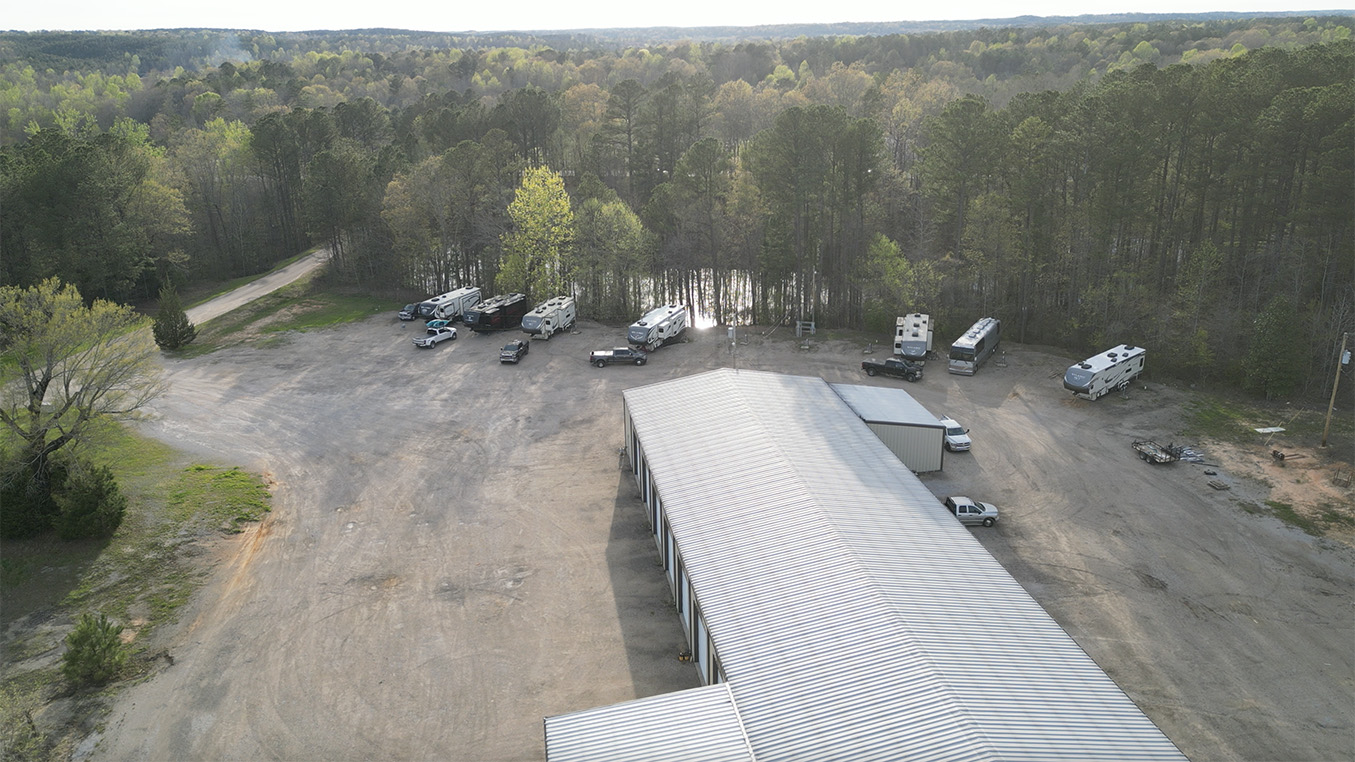

Thanks for thinking of us. I am probably going to make a trip to Tish this spring. I need to call them for a date. Can you recommend a RV Campground there?
If you’re going to Tish they have hookups on site
That is one of the great things about Tish - full hookups onsite and while they work on your rig if it needs to stay in the bay overnight they do have water and power in the bay. Tish was one of the major reasons we purchased a Vanleigh knowing that we wouldnt have to work with a dealer for repairs and planned on doing an annual stop there.
Danny had said that he changed up his procedure for the buckling from what was historically done at Tiffin however after hearing his process compared to the outlined procedure they seemed very similar. I am betting Le Mesa may have missed a few steps.
Good luck - those guys at Tish will get you corrected. They do some great work over there.
Thanks to Ryan and Jon. I looked at a google maps view of the area but didn’t realize they were hookup spots. This is a really good customer service to allow you to hookup while waiting. Thanks again.
