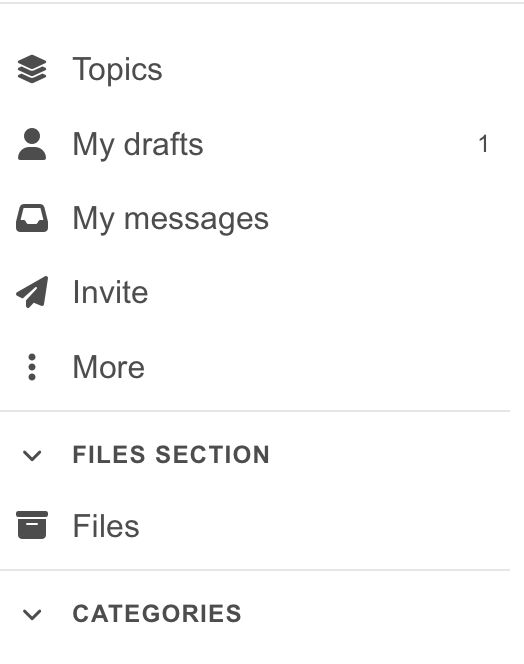

There’s also a list of the later model years that show the location for each model. It’s located under the Files section of this forum and the file name is 22-23 Spyder VanLeigh. That might point you in the right direction.

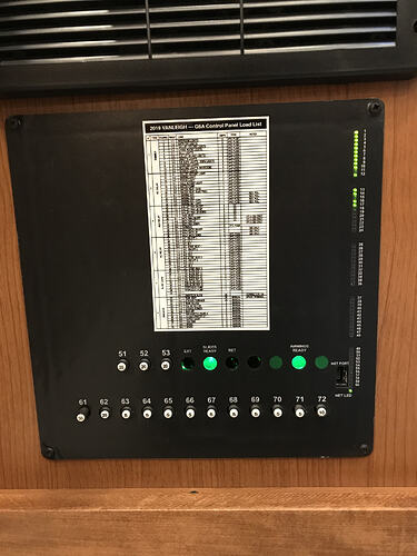

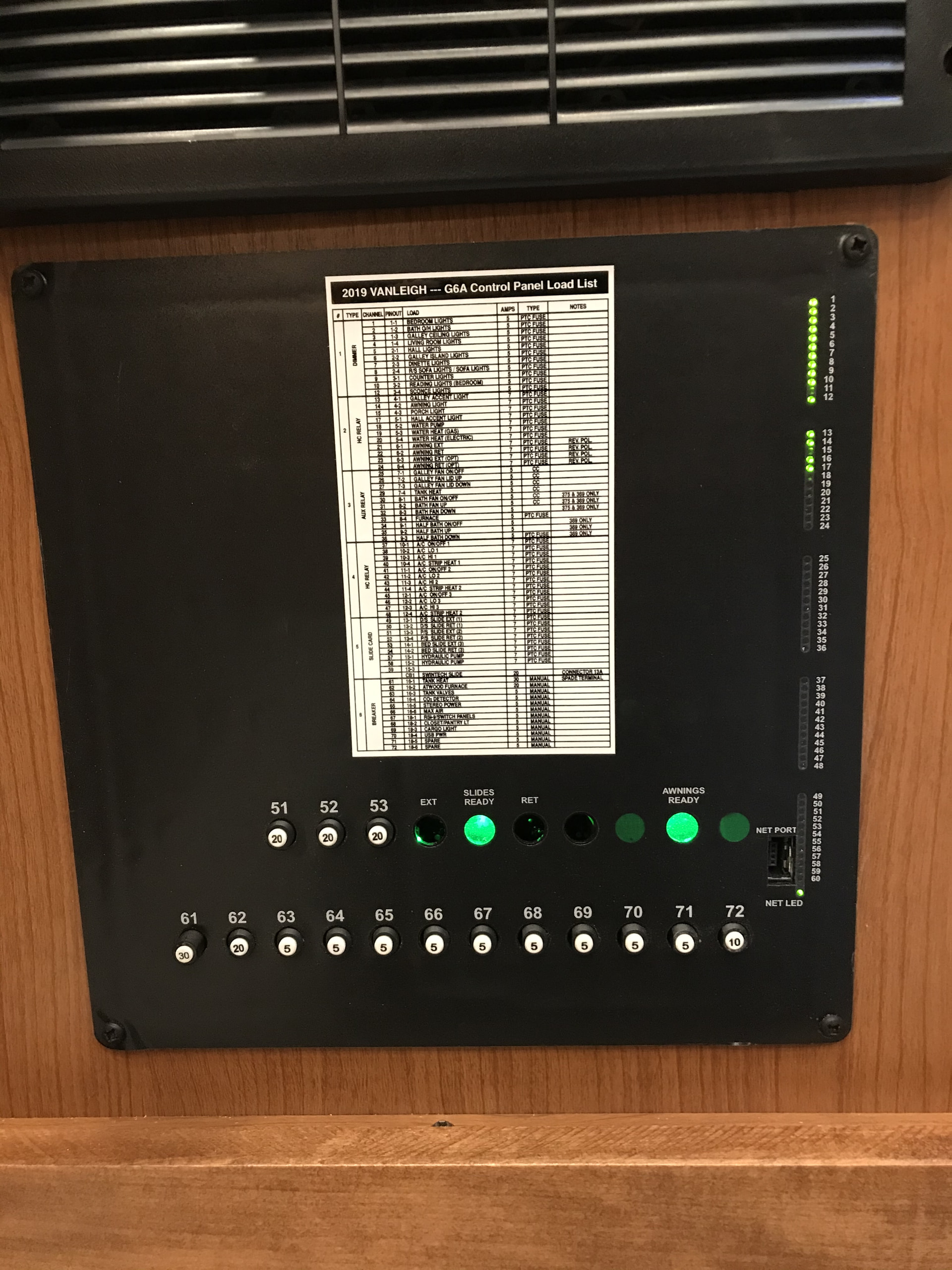

The panel by the 120V breaker panel is the G6/G12 panel. Should look similar to this (our G6 panel):
The connectors for all of the 12V circuits are on the back side of that panel. That’s where I connected my SeeLevel so it shows on the Spyder display. If you don’t need or want it to show on the Spyder panel and just use the SeeLevel display then there’s no need to connect to the G12. There’s also a bluetooth version of the SeeLevel that allows you to use a mobile app to view the tank levels.

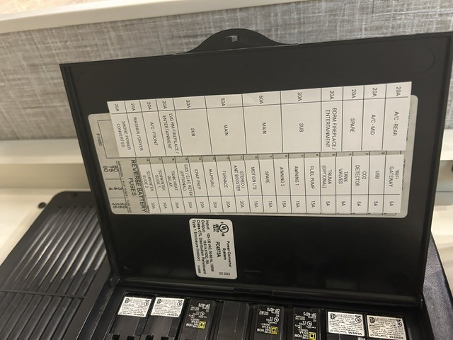

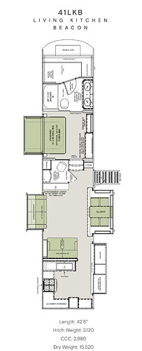

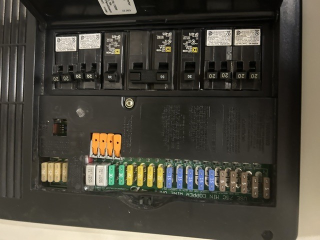

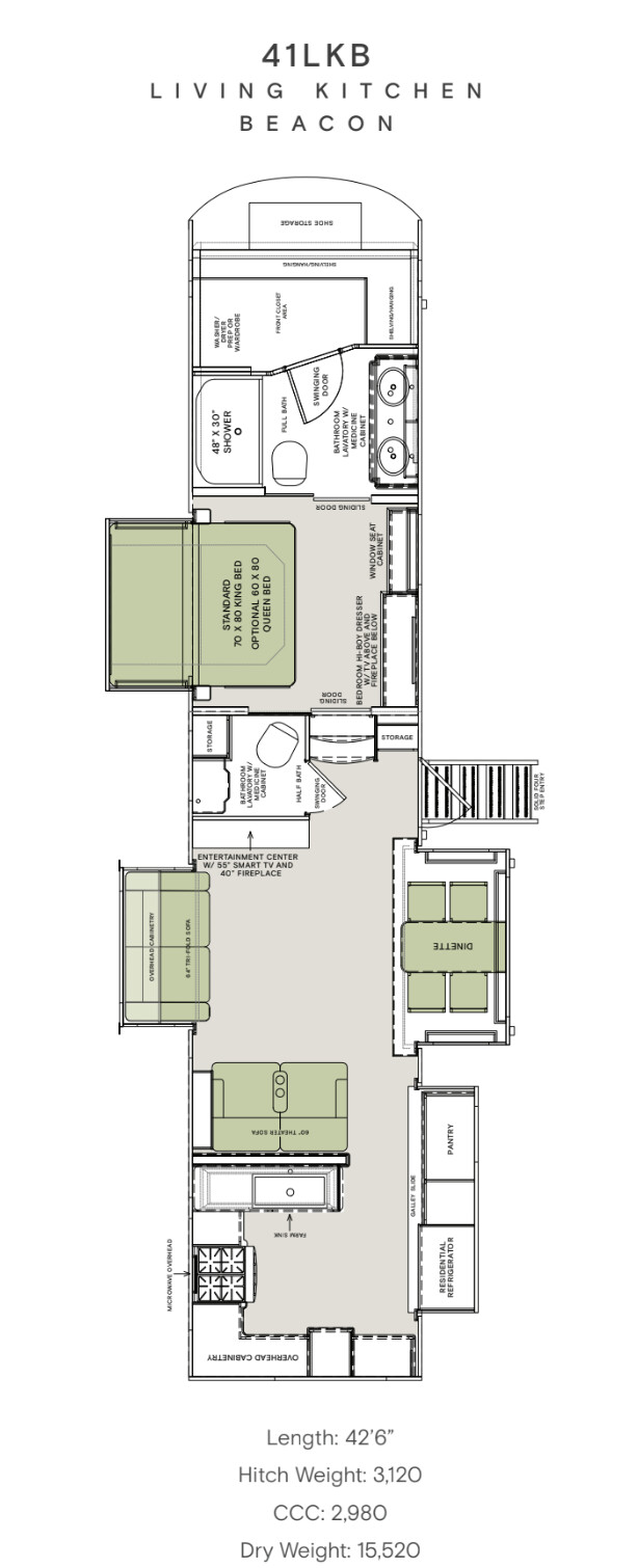

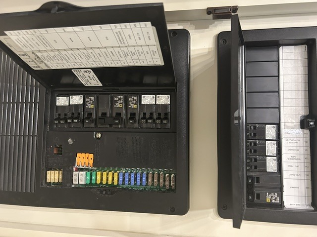

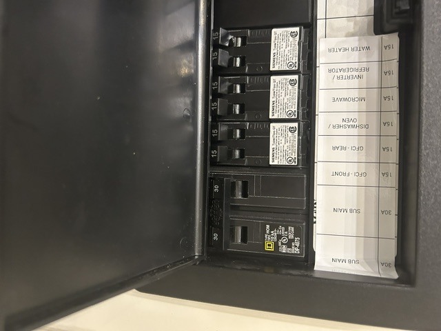

I haven’t found anything that looks like the one in the picture. I have a cabinet hext to the entry door that has 2 panels in it. One has several breakers in in and the other has both breakers and 12V fuses. Here are the pictures of the cabinet and the panels. There is a panel below the 12V panel that I took off but only thing behind it was wiring. Sorry they are all rotated 90 deg. Not sure where to look for the G12.
That’s different from what I’ve seen in the prior model years. Maybe they changed things up in 2023 since they went out of business not long after. Normally the G12 panel isn’t too far from the Spyder control panel. Where is your Spyder display located in your model? Where are those electrical panels located?
The G6 has the panel with the resettable fuses as in Stuarts picture but the G12s do not have that front panel and instead are two modules. From what I have seen on other models - Vanleigh had tucked those into a closed up area where the G6 used to be.
I tried to find pictures that @ERamsey has posted previously when he cleaned up his G12 wiring but couldn’t locate that post. The 41LKB used to have the G6 mounted to the right as you walked into the door. On the 23 models they kept the same wiring path so I am guessing your G12s are just behind a panel there. Maybe Eric will jump in with a pic of his setup to give you an idea of what to look for.
The panel under your 12 volt/120 volt panels is where your G12 modules are located. All those wires you see are attached to them. If you are electrically inclined, then take a day and clean up the mess. I found my modules were just stuffed into the pile of wires, not mounted to anything. 2023 41LKB. Email me if you need assistance, I will do what I can for you. Eric.Ramsey.Sr@me.com

The Spyder control panel is located on the wall where the steps go up to the bedroom on the side where the storage is. The electrical panels are located in the storage area right by the door. The lower cabinet is where the panes are.
Thanks for the info. I opened that panel and all I saw was a bunch of wires. I didn’t see anything that looked like a module or anything I could connect to. I didn’t move anything around so probably missed the modules. I will open that panel again tomorrow and do a lot more looking around. I’m not very electrically inclined so probably won’t try to do much cleanup.
