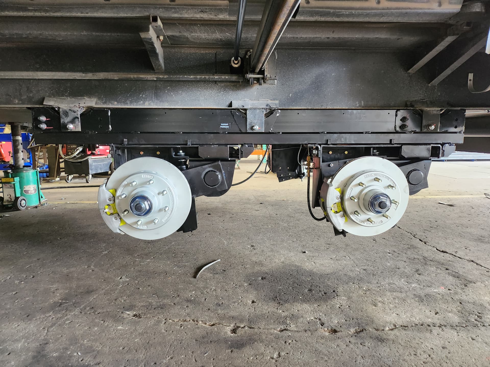

Hey Jon - I just scheduled my installation for the MORryde IS for early January. They have a special going on where if you get the IS installed in Jan, Feb or March, you can also choose an additional product for free (Rubber Pin Box, Step Above steps, etc.)
I had been researching this upgrade for some time. I had wanted to get the IS installed by Vanleigh, but they didn’t offer that as an option when we ordered ours. We did have Vanleigh add the 8K axles and disc brake options on our order. I also looked at some of the upgraded MORryde traditional options like the CRE 3000/LRE 4000 and even the competing Roadmaster system. None of those options got rid of the springs & equalizer. The IS just seemed like a much better option for a longer term and better ride.
You’re right about the MORryde being more expensive, but I was able to save some by already having disc brakes installed and they’ll re-use those when they install the IS. The cost will around $6-7K, but I think it’ll be well worth it and perform a lot better than the spring & equalizer systems.

Just one other thing not mentioned often about the IS system, you get a true alignment. I had mine installed in 2023, I have 35,000 miles on the trailer since then and very little wear on the tires. I did switch to LR ‘H’ tires on 17 inch rims at the same time. My system was a bolt on.
