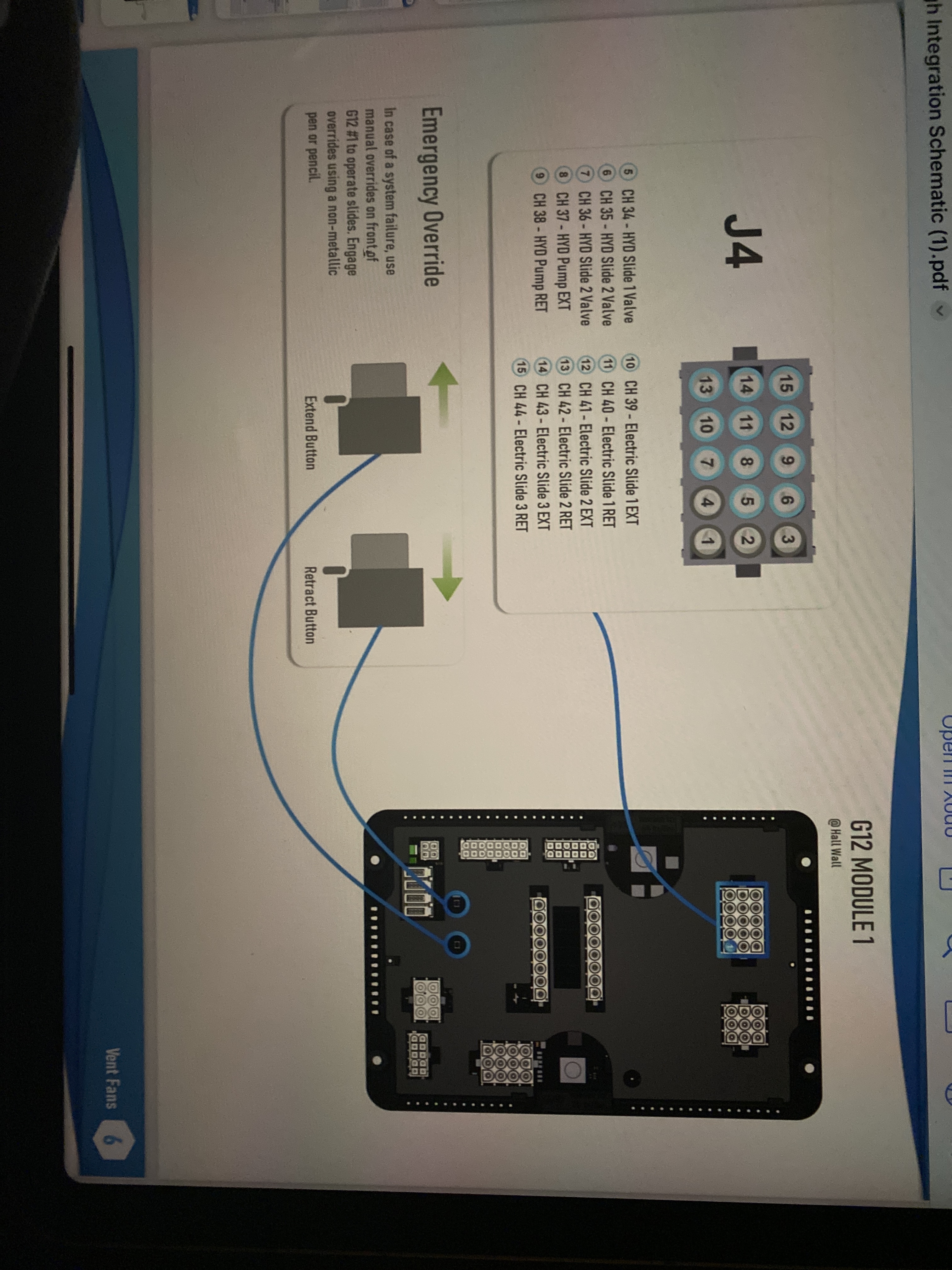

Just a note on the G12, it does have two override buttons on Module 1 for slides. One is for extend and one for retract.
