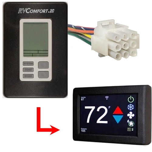

  • If you just want AC controls and go without the other options you could also go with the Micro Air RV Thermostat. I dont recall the thermostats in the earlier Vanleigh models but there were several people in the Vanleigh Facebook groups that used Micro Air instead of the Firefly solution. They are a pretty easy 1-1 replacement with the standard thermostats you find in RVs but your 2018 might be a bit different.
    The EasyTouch RV WiFi Thermostat | Bluetooth Smart Control | Micro-Air – Micro-Air, LLC

Please check my work but I believe this was the thermostat used in earlier Vanleighs and then the associated Micro Air Thermostat.
