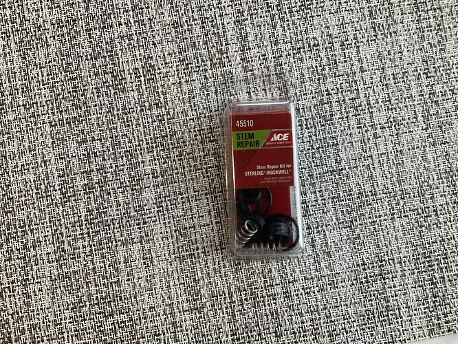

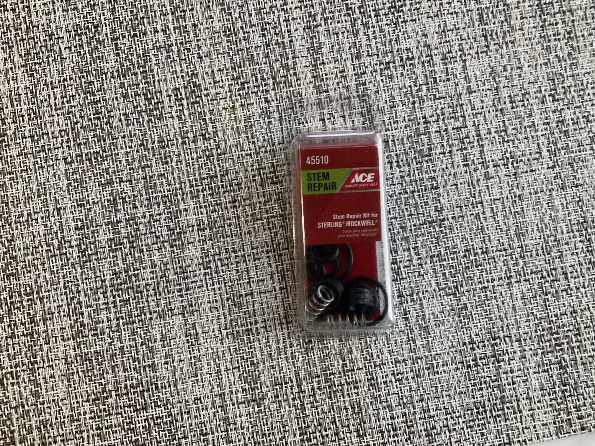

To close the loop on this, ended up calling Tiffin and they sent me a new faucet for about $20… Used this as a parts source as did not want to just replace and dig behind the shower. This issue ended up being two little hollow washers on springs that the inserts push against at the back of the faucet. The washers on the inserts were fine. See attached pic for the parts.
