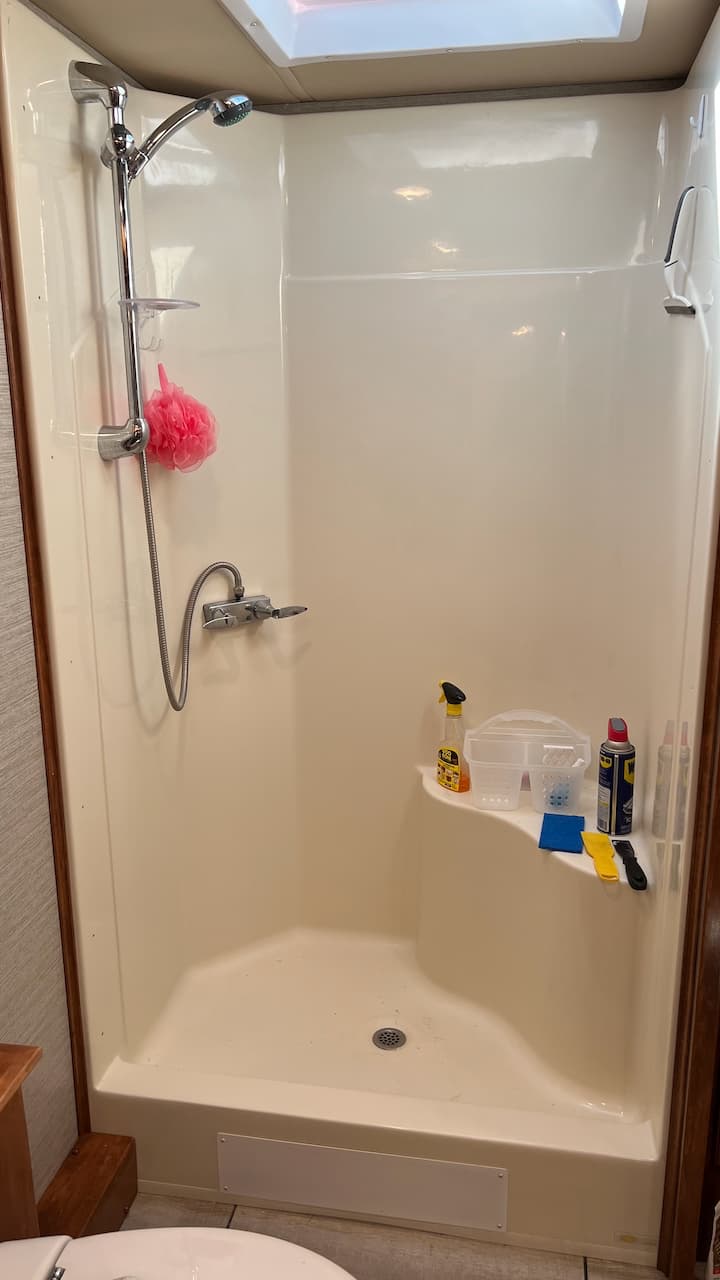

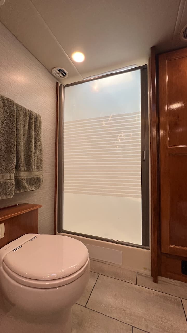

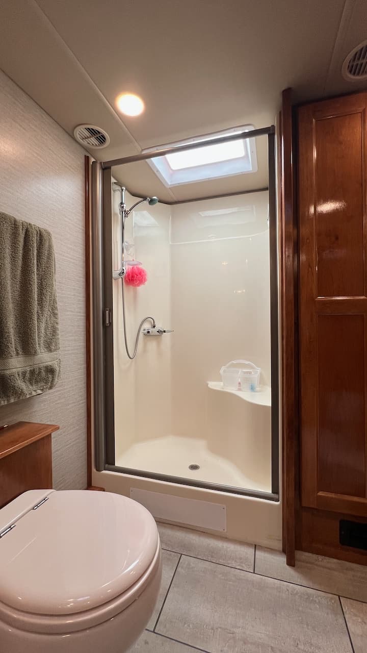

Here’s some photos showing the enclosure after the original was removed and the new Nautilus door installed.
Old door removed
Excellent upgrade!
