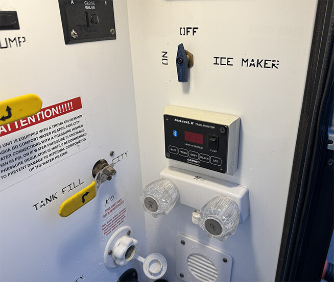

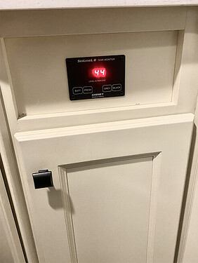

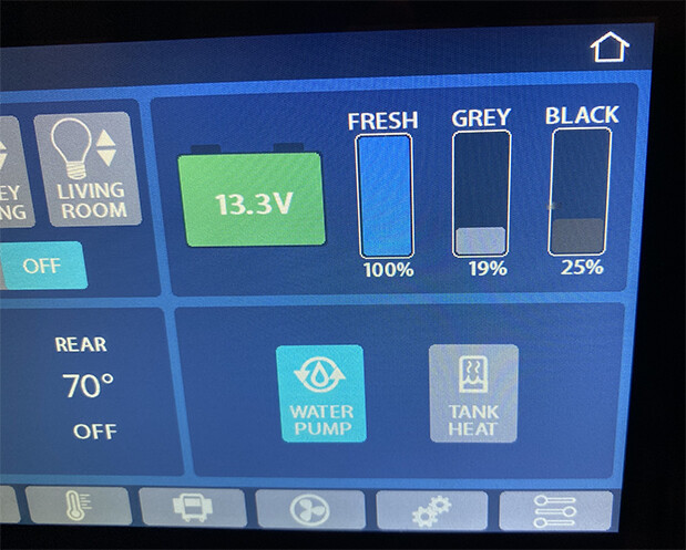

Just a comment about the displays; I believe I have a post in the group about my installation. I installed a display in the wet bay and one in the bathroom. The bathroom display is a RVC unit and plugged into the Spyder RSi-9 board. I worked with Spyder to have the tank sensors on the Spyder display read what See level was providing.

Ryan, I like the standoff mount you have in the wet bay. Was that from SeeLevel or did you get it somewhere else?
I didn’t want to cut a large hole for the monitor into the wet bay to accomplish a flush mount. The monitor has an extension piece on the back to protect the circuitry and then the pigtail extends past that. I instead opted to drill a small round hole for the wire loom to fit through and then raising the monitor with a small sealed wood frame. My intention was to replace the frame with a 3D printed frame when I was back at “home base” but it worked well enough that it has stayed the way it is.
Ralph I do like the bluetooth and in the end there are many ways to check on my tanks. Spyder screen, Eclipse app (which displays Spyder panel), Garnet app for SeeLevel, monitor in the wetbay and monitor in the bathroom. I had been prepared to tie the Seelevel into my Cerbo but this was mainly for historical data in VRM ( I nerd out on data).

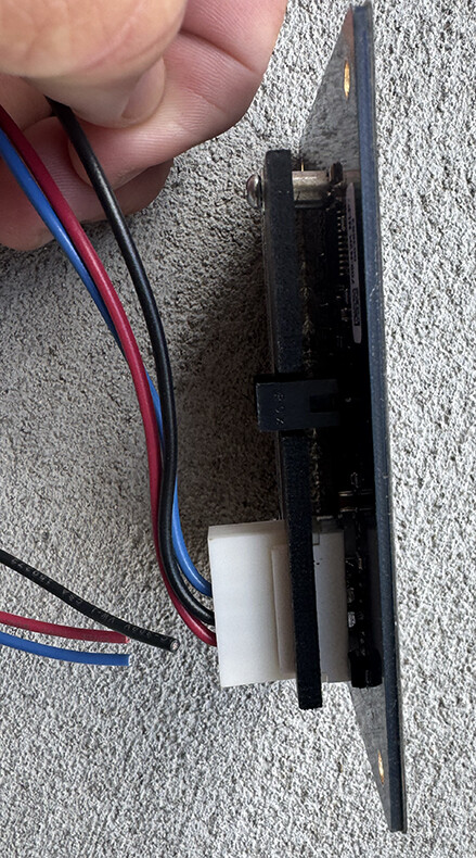

This is a picture of the monitor and you can see the components on the back side. I tried to be the least intrusive but if you don’t mind cutting the hole no need for the frame.
So Ryan you made the frame for the display, you made it look very good in the photo. Do you want to make another??
