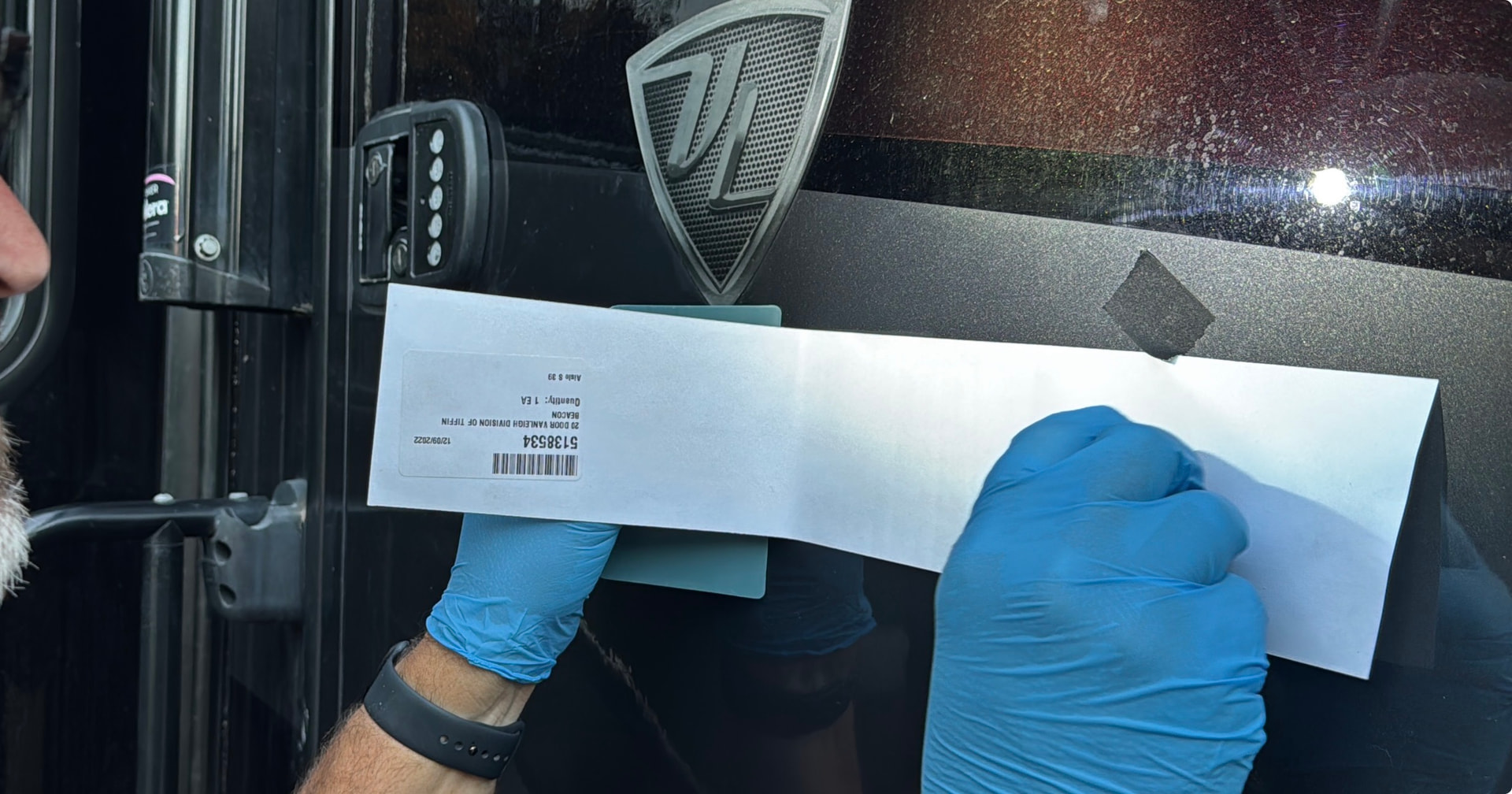

What is the procedure to install these?
Hey Chuck - I was able to pick off my labels mostly with my fingers however their were some parts of the logos that were baked on and I used a heat gun lightly in those areas. Cleaned with alcohol and then applied new logo.

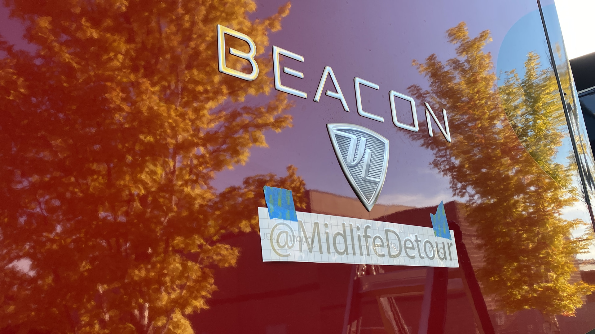

The good thing with the Vanleigh door / cap logos are they are small making it easier to apply. I always use some painters tape to place the graphic where it needs to go and then work from one edge slowly pulling off the backing and making sure the vinyl goes on smoothly pressing it with a large flat spreader - I prefer a 4" body filler spreader to work the backing down before I remove the outer paper.
Here are a couple of pics of what I am trying to explain:

lol, I’m still in the removal stage. They have adhesive are installed dry, correct?
They are adhesive and the ones from Tiffin I have applied both wet (with a soapy spray bottle) and dry. The size makes it easy to work with dry however the small amount of soapy water may give you some more grace being your first attempt.

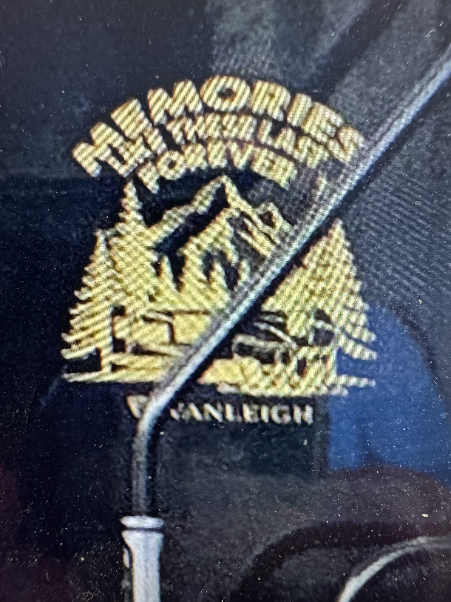

Thank you Ryan , anyone been able to find the one they put on the slide side wall next to entry stairs that says “Memories like these last forever” pictured with forest and a fifth wheel with Vanleigh written along bottom??
I think that sticker must have been custom by an individual. I was at the production plant a lot and the repair center almost as frequent and have never seen that sticker before.
