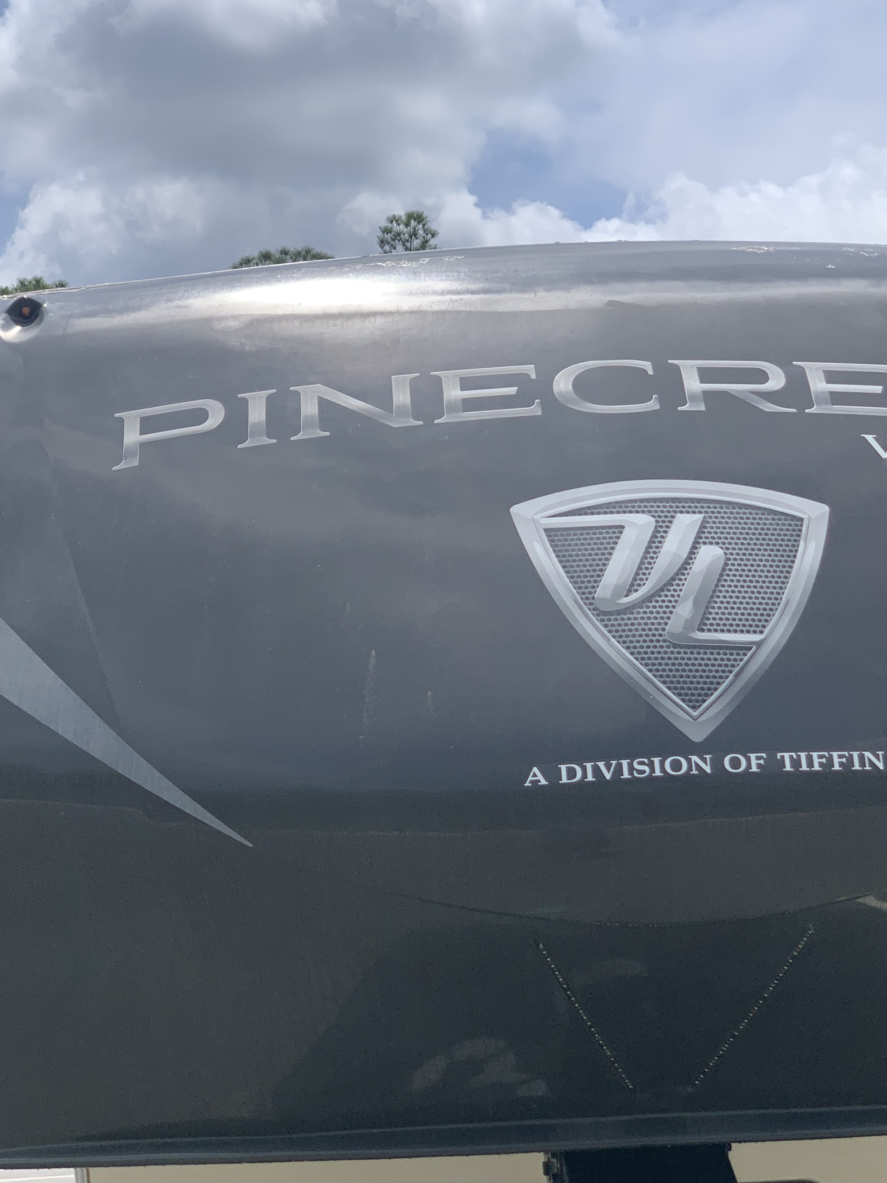

Nose cone top coat peel again
Has anyone had any experience with any UV wrap for the top 3 inch of there nose cone, I just had to re surface my top again around the lights and all the way along the front and was hoping to put a UV strip over it to protect it better or find a front nose cone protector any input appreciated .

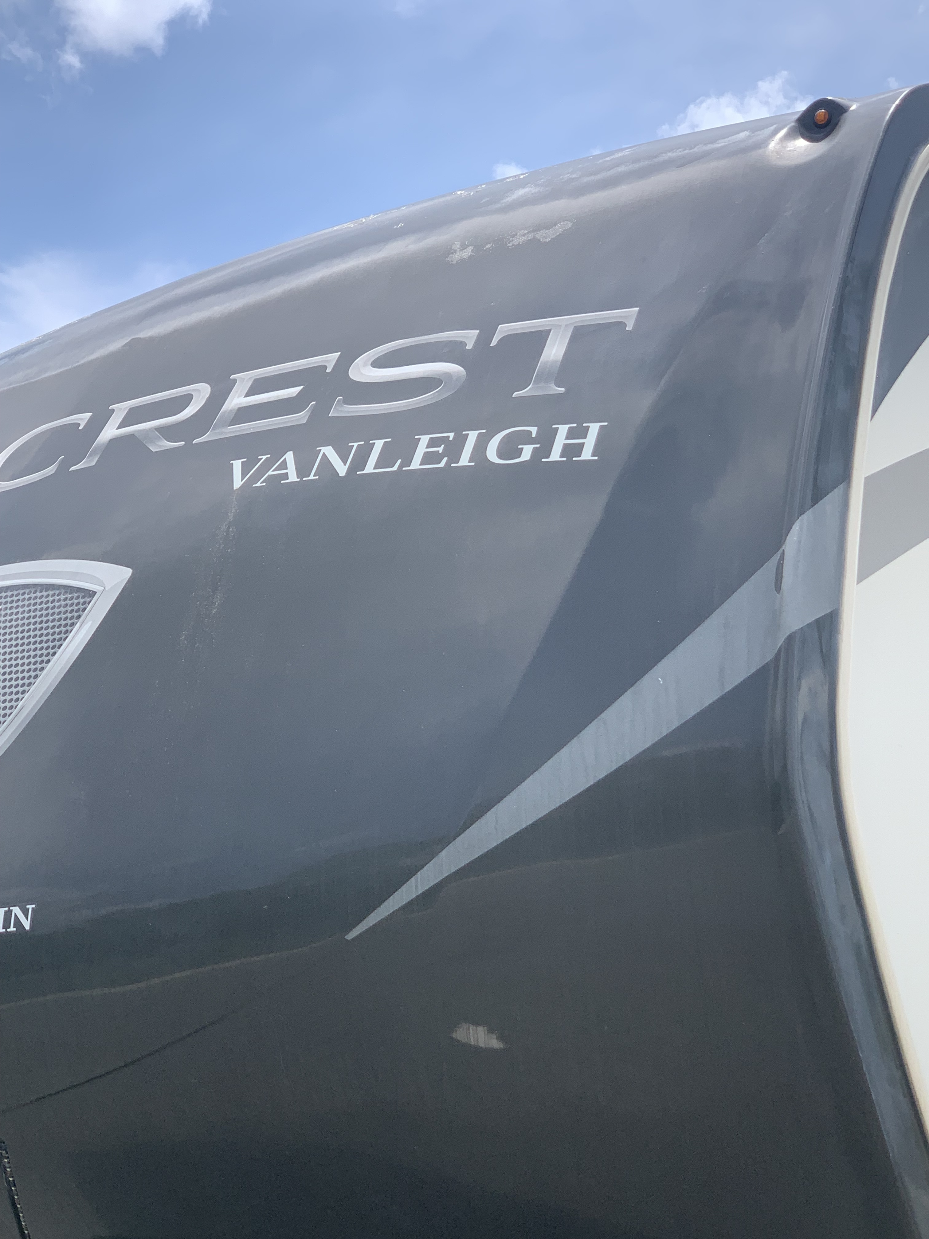

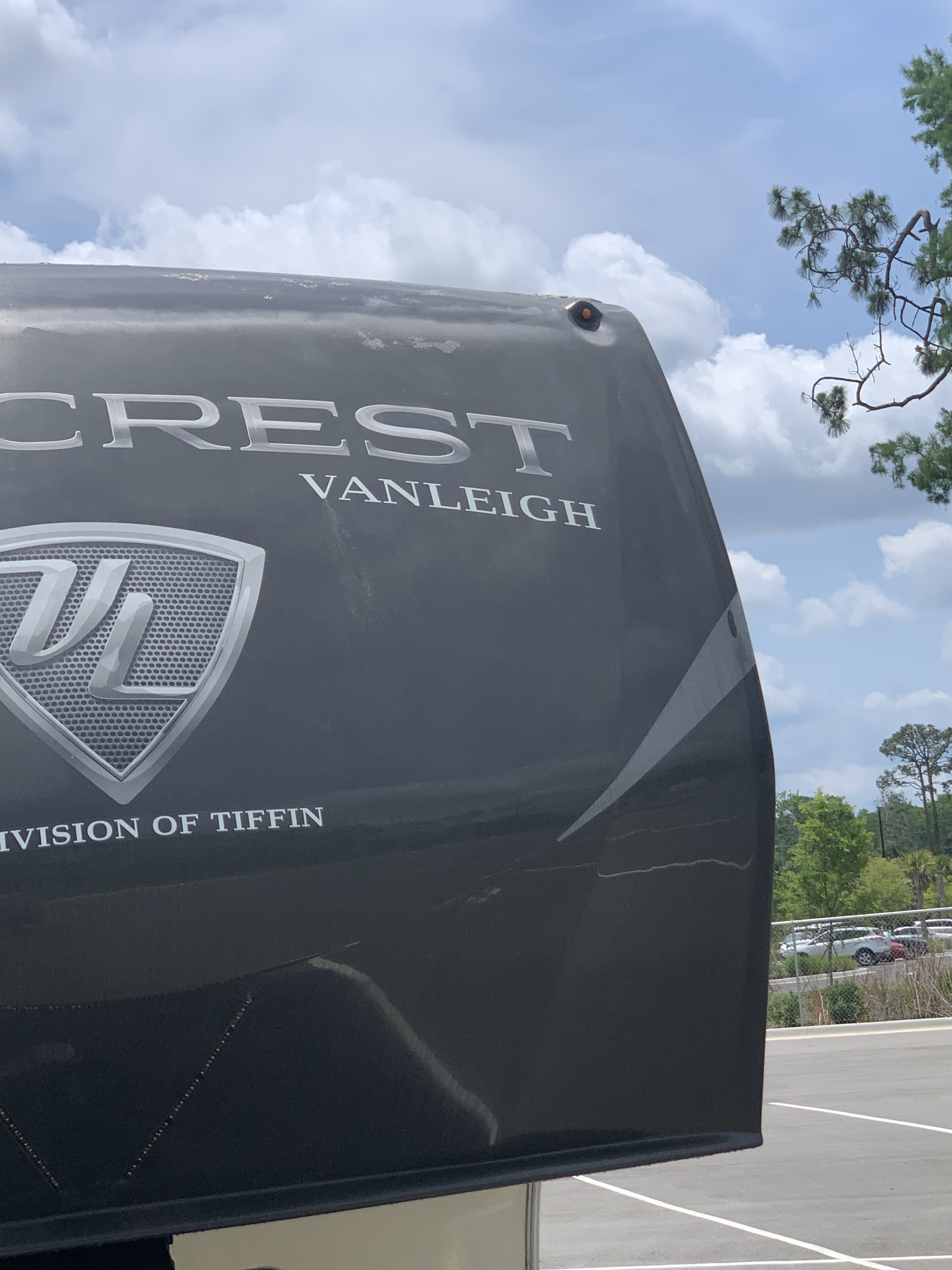

Hi there I’m revisting this as the nose cone brown has peeled in the right side front around 3 inch patch down to the yellow undercoat.
My questions are
  1. Does anyone know the color of the brown
  2. Suggestions to repaint the 3inch top of the nose cone.
  3. A cover which 2 people can install with ease thanks

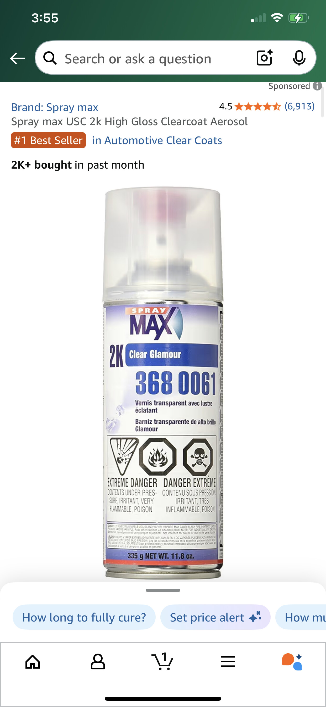

Old thread getting ready to uncover and re spray the top coat which is peeling
any suggestions on clear cost the one below is one off Amazon and also the color coat would anyone have a suggestion of the color
this will be the 2nd time due to the UV taking off the top coast each time I’m going to invest in better paint rather than the auto store quality
suggestions appreciated on best quality of paint to buy
  1. top coat - gloss or satin
  2. Color match

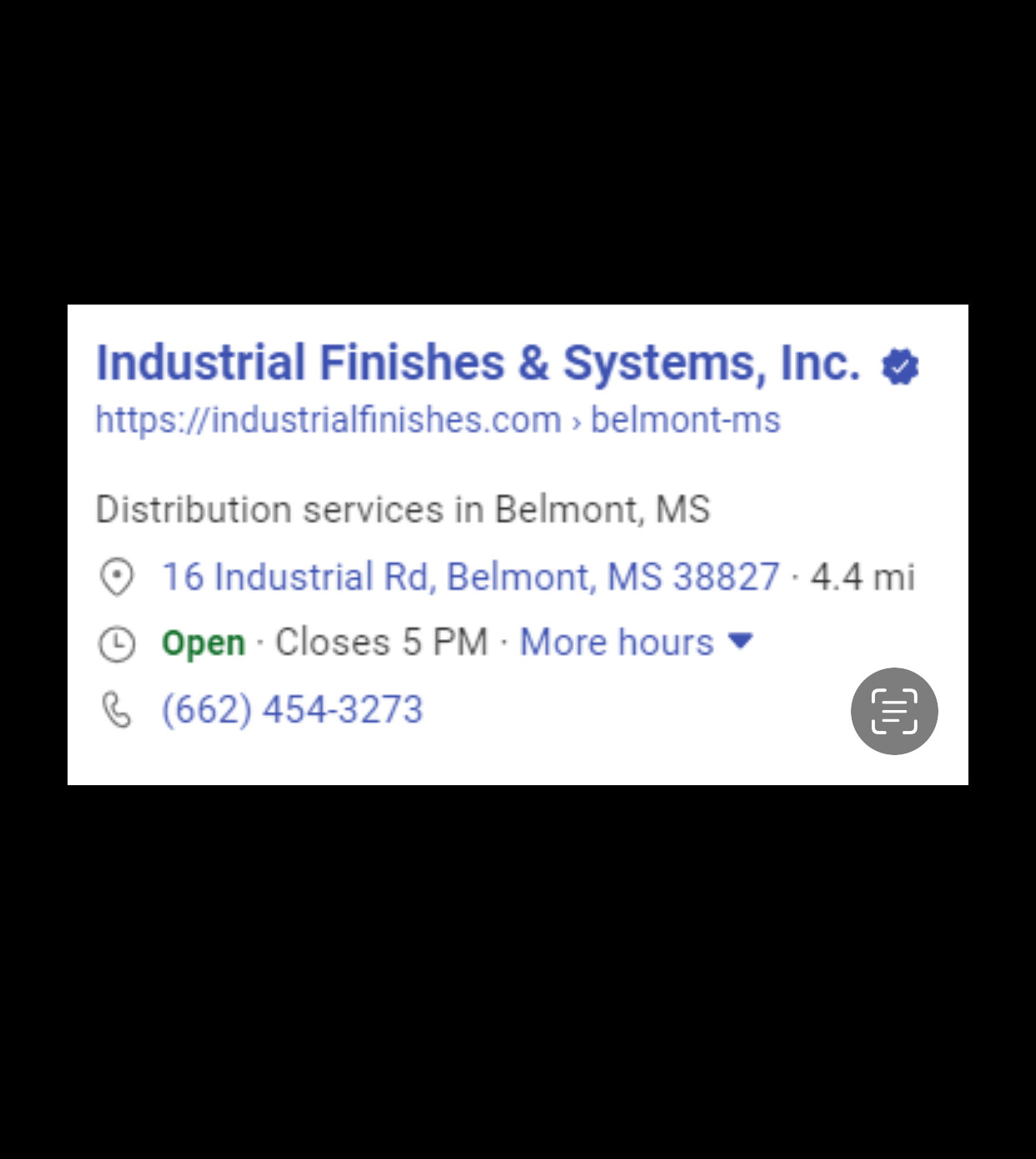

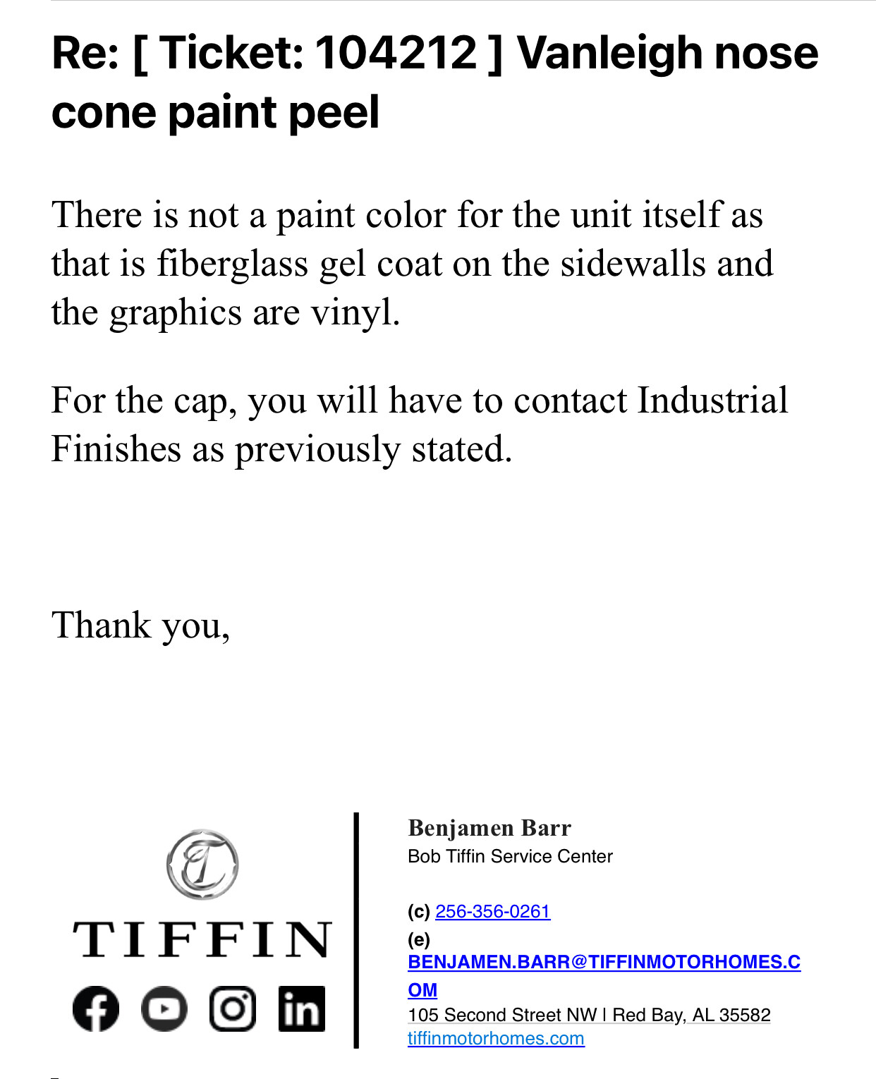

Quick update 3500$ for a nose cone repaint and decals need to be sourced i also found the pain manufacturer below

I dug into this and looks like the original paint for the Vanleigh Vilano / Pinecrest came from Belgreen Coatings (thank you Danny at Tish for that answer). Sounds like they later switched to Industrial for the final two running years in which Pinecrest were no longer produced.
Larry at Belgreen said Vanleigh called the color on the unit “Templer Brown” for the Pinecrests with the brown caps. The earlier Pinecrests were black. I inquired about that paint color he stated he only supplied a small amount of paint for the black ones since they were a short run and didnt have the code info for the Metallic Black.
The paint is a Lusid Paint so can be mixed anywhere Lusid is sold. Belgreen will sell it to you but since they are mainly industrial (now contracted with Tiffin for their production) they wont take electronic payments from a consumer and only accept a check and current price per gallon is $135.86. Belgreen is located in Russelville AL.
With all that stated you should be able to go to any shop selling Lusid paint and have them mix up the Templer Brown using the code: BC3B832248. https://www.lusidtechnologies.com/
As far as the graphics - Tiffin on last check still was selling the VL badge that is center of your cap although I understand they were limited quantities. As of this morning Danny stated he can still get the badge. Any vinyl shop can recreate those graphics of course at a cost of design. If you wanted to be true to the original the font for the “Vaneligh” under the Pinecrest and the “A Division of Tiffin” are easily reproduced with that font - I have recreated the logos for the Beacons and those files are in the files section. The same font could be used for those portions.
