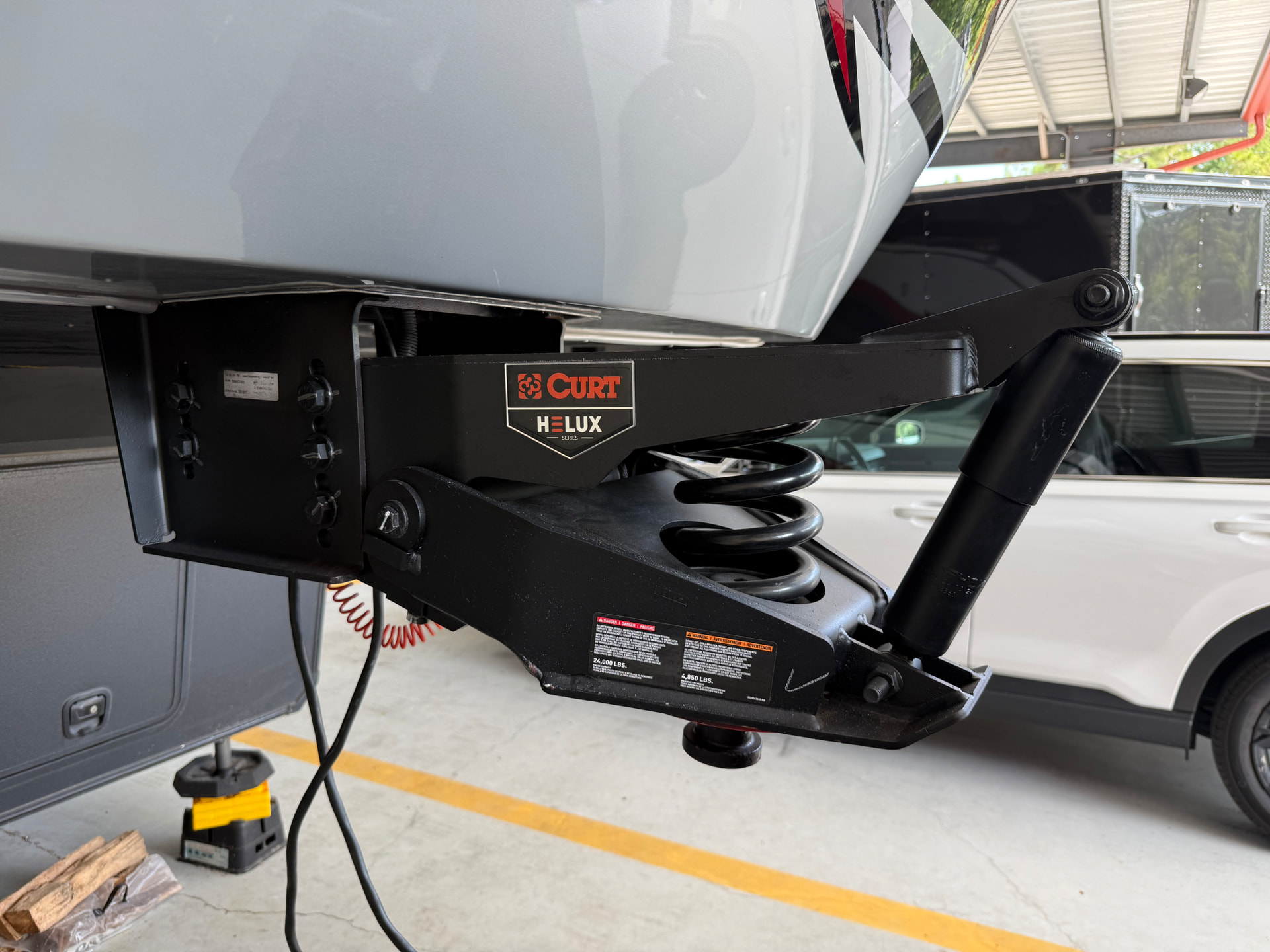

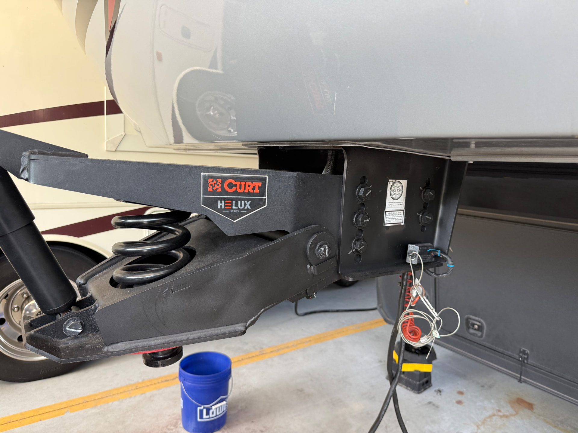

I just switched to a Curt Helux. Was looking for a little bit of suspension in the front end. haven’t towed it yet.
