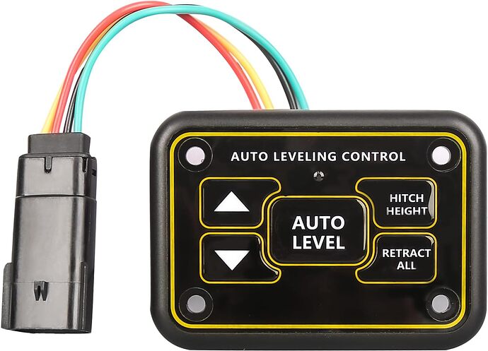

The outside leveling mini touchpad on my 2020 Vilano has stopped working, it will not turn on.
We usually just touch the up and down arrows together to get it powered up but no go. Can anyone advise me where I can find the model number for the touchpad. It’s labeled Lippert Leveling System but going to Lippert they only show a model 421484 as a replace for many of their touchpads, (so says Lippert). We can control all leveling at the main station in the basement but that’s almost a backbreaker to get to.

Thanks to Stuart and Ryan, I did find a blown 20 amp fuse but the touchpad still will not power up. I am going to order a new one on amazon and change it out. Again thanks,

Had the same issue spent 8 hours over two days with Lippert customer service and they couldnt figure out the probvlem they sent the whole sysem in parts. Anyway it ended up justy being the external touch pad needed to be replaced. Which once all the parts showed up I put the new pad in and it was good to go. Been working fine for two years ever since and I have lots of spare partts I hope I never need.
Thanks for the info. Went out yesterday and replaced the touch pad with a new one and WAALAA. Working fine and it actually comes on.

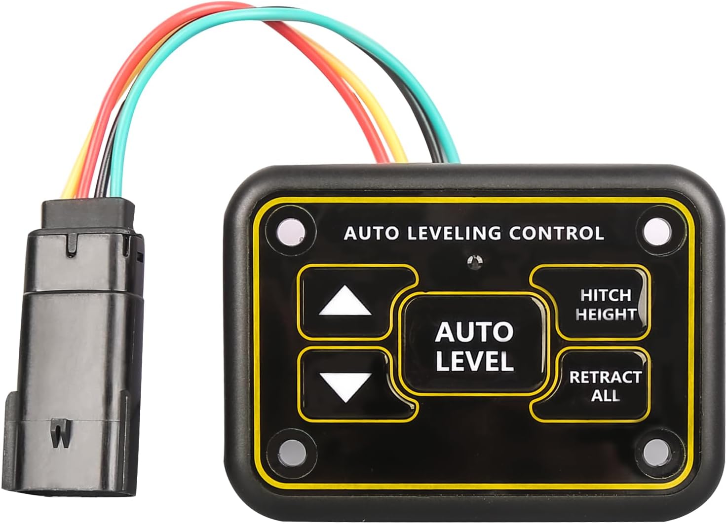

@SubSonar Can you share the link for the amazon item for future reference.
Sorry for the late response. this is the link from Amazon for the replacement touchpad.
