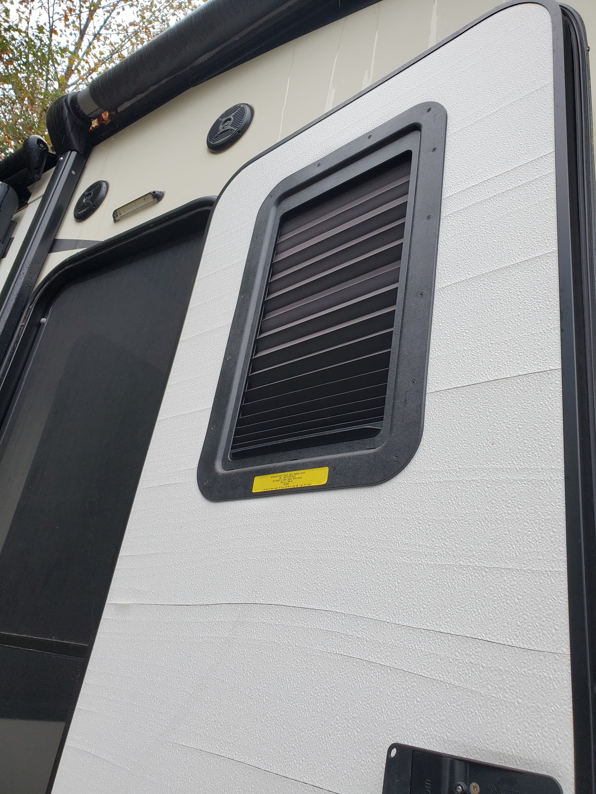

We have noticed that the interior skin of the exterior door (2019 Vilano 370GB) has cracked all the way across the door in numerous places (you can see the door insulating foam through the cracks). Has anyone else had this happen? I did a topic search on this site and didn’t see anything. I will contact the door manufacturer and see if the interior door skin can be bought as a separate item.

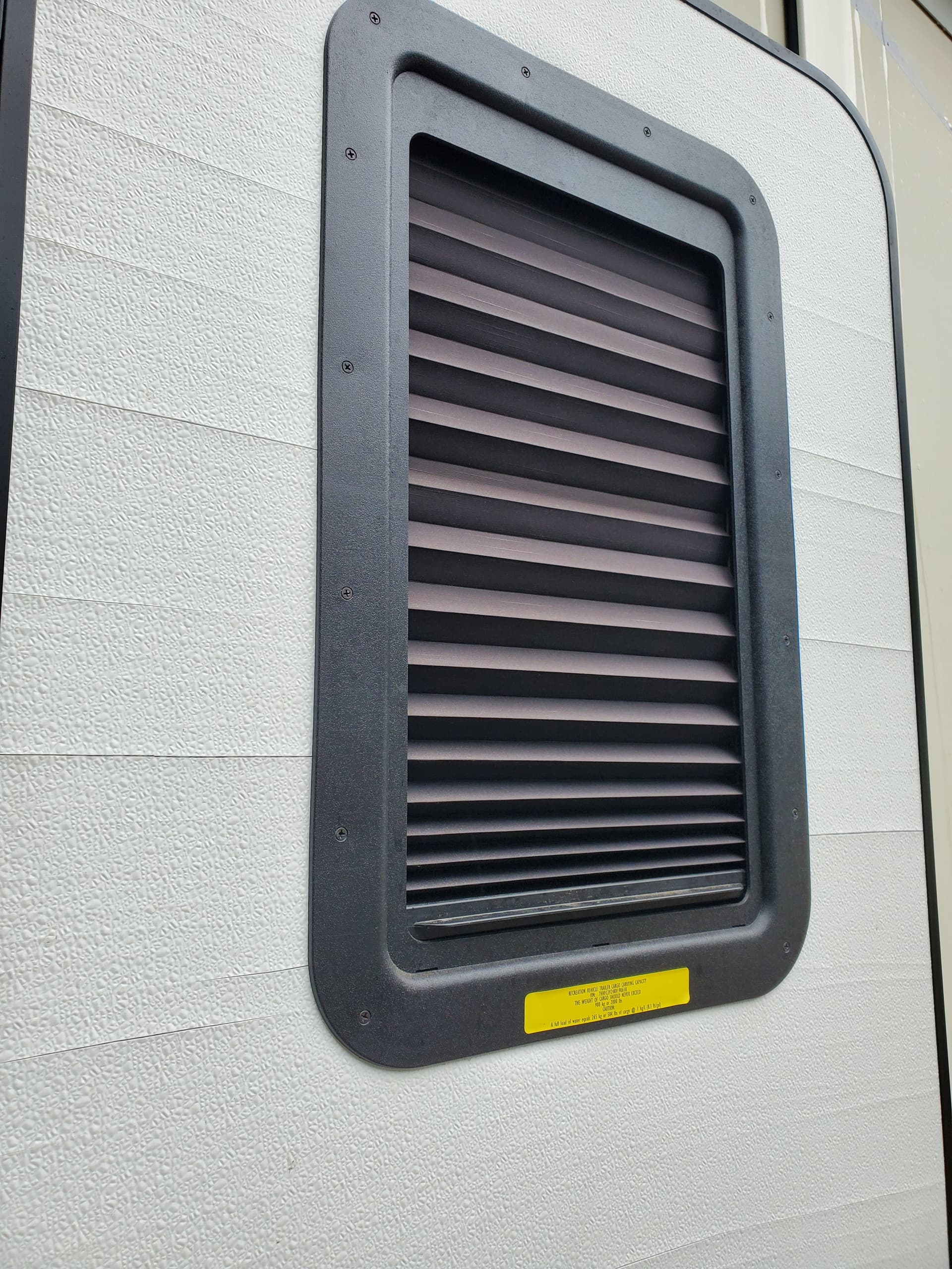

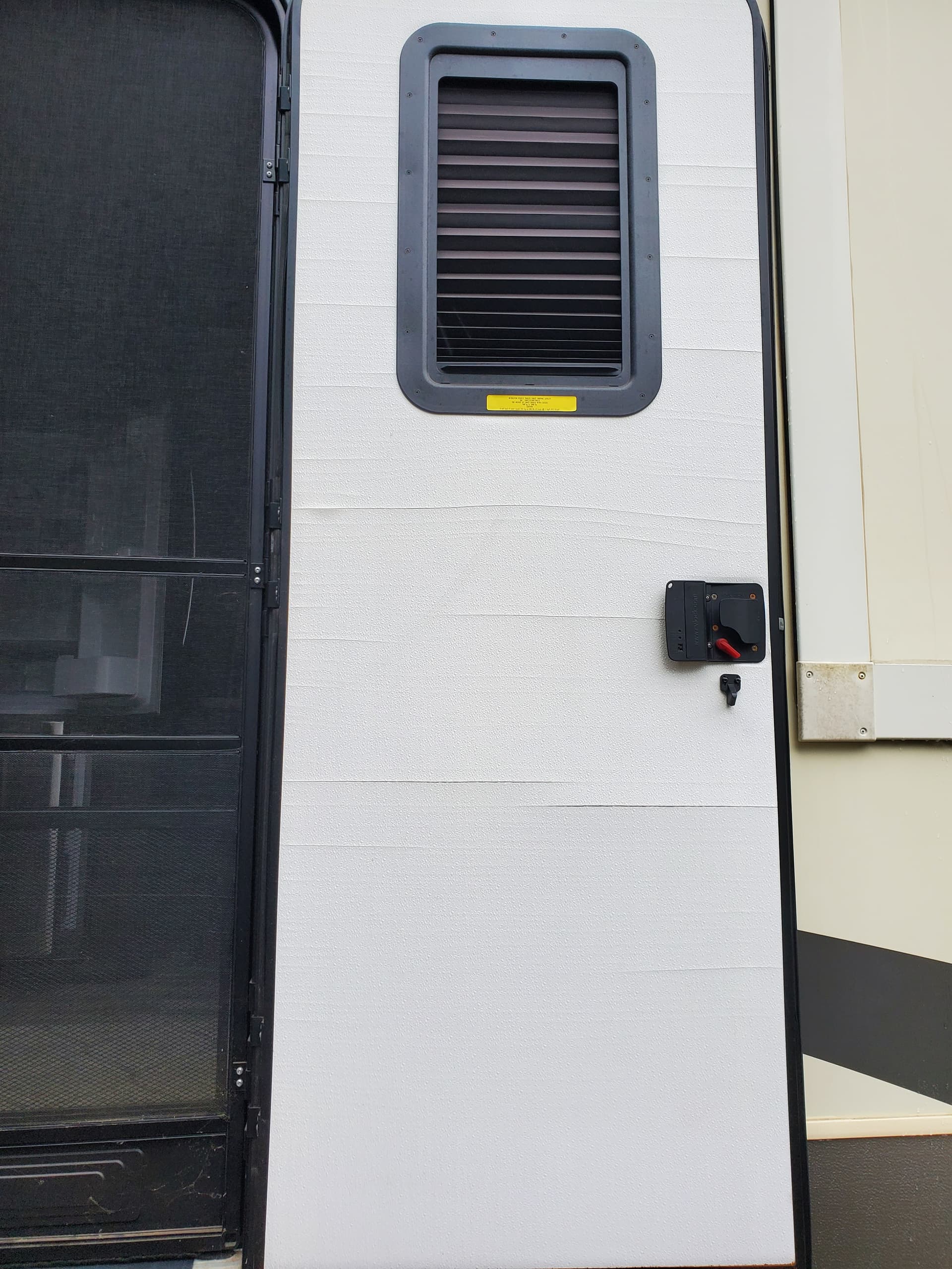

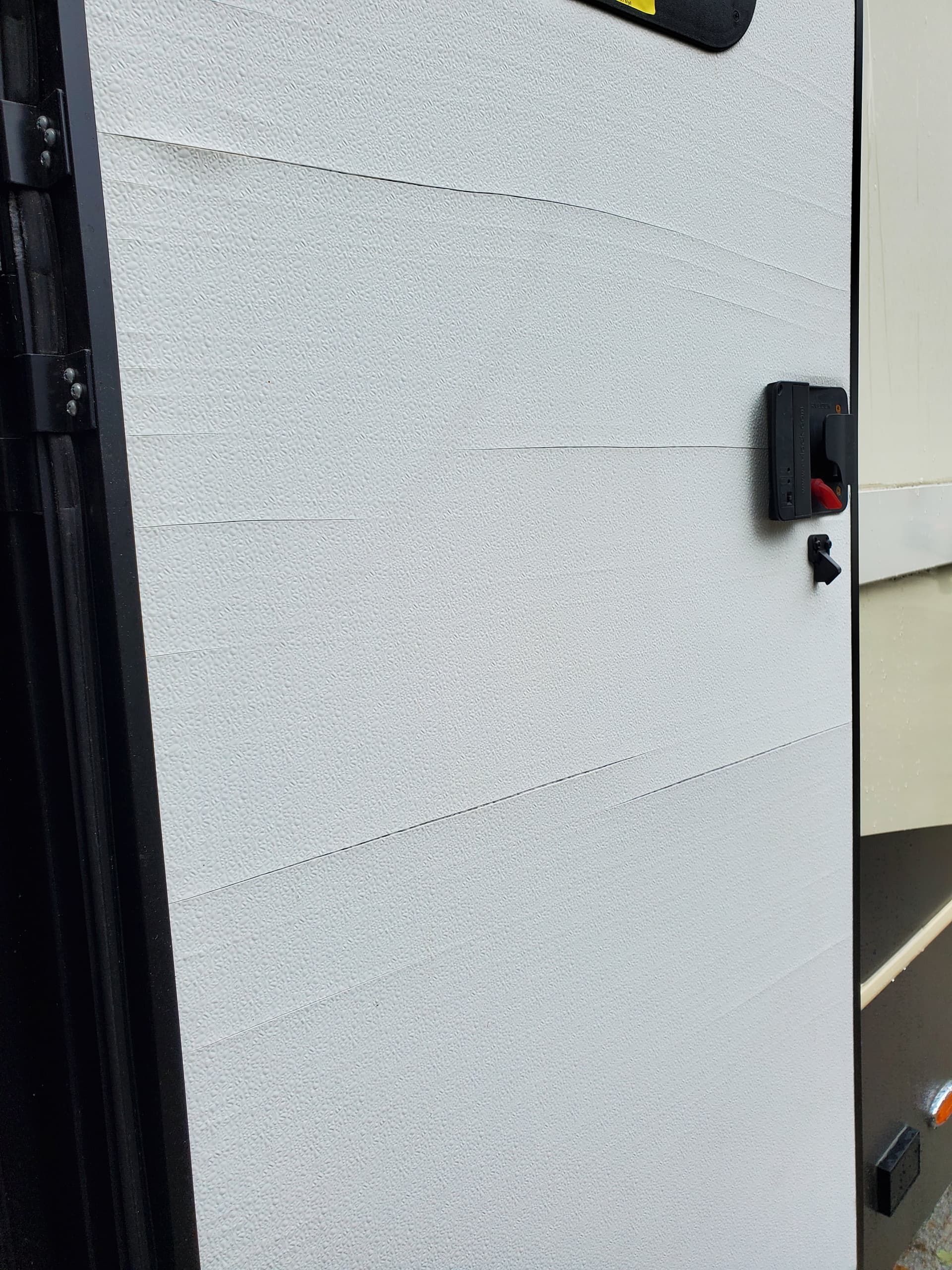

here are pictures of the interior front door skin cracks.
