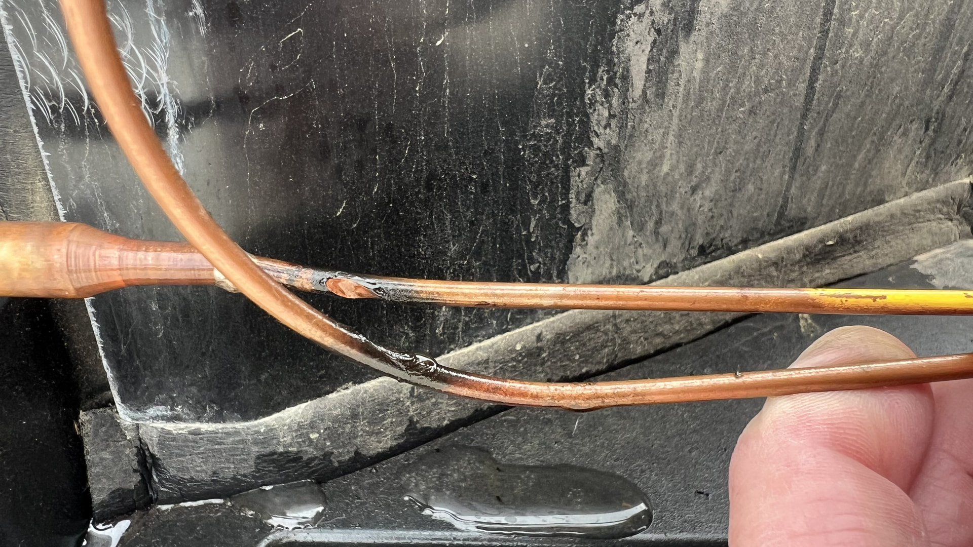

We had the new AC installed Monday. The old one had sprung a leak in the refrigerant lines. Looks like they had been rubbing together and eventually rubbed clean through allowing the refrigerant to all leak out. The replacement unit uses the new R32 versus the R410A the old one used. They say that is supposed to be more efficient.

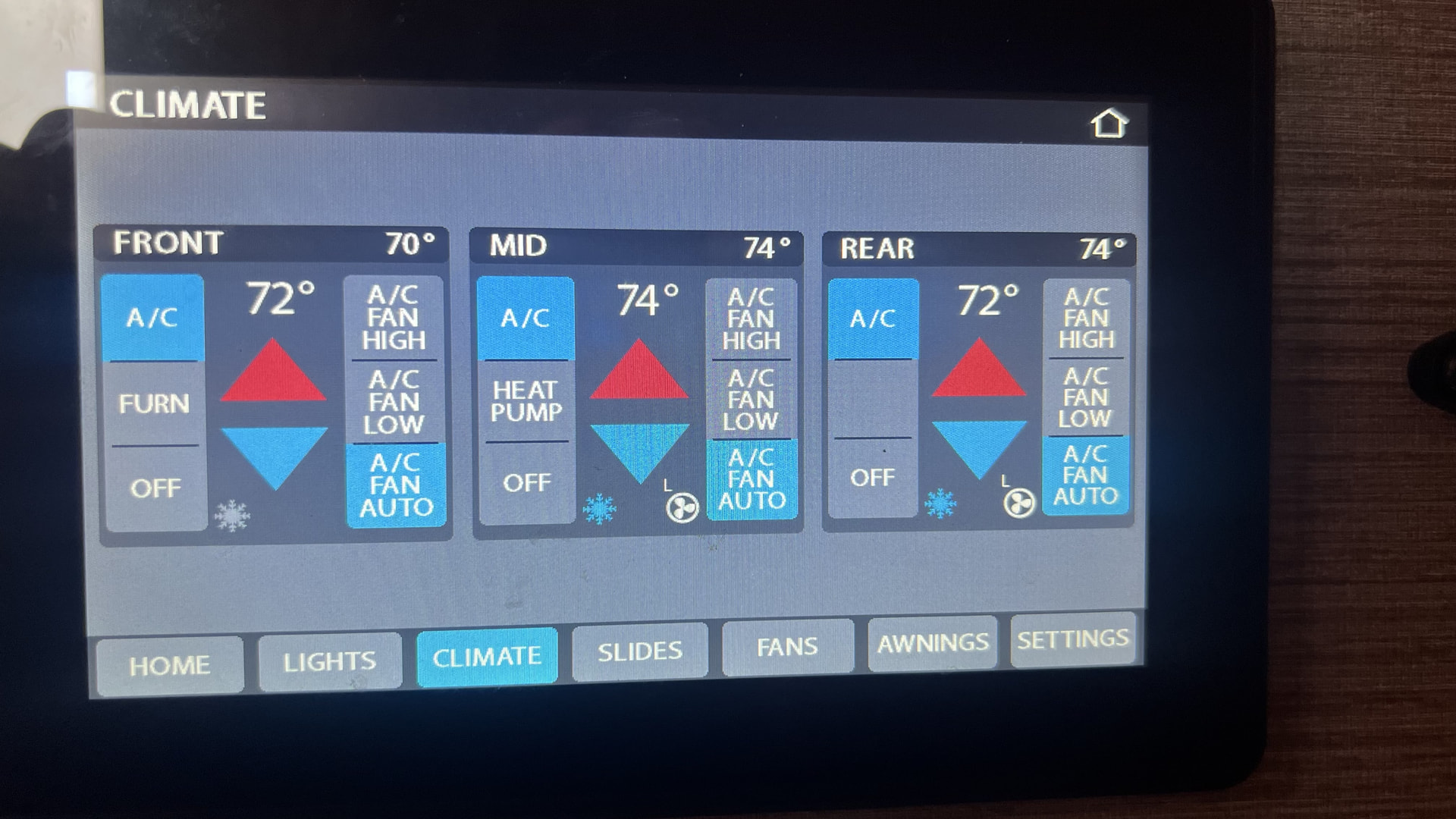

I also got the new unit with a heat pump and am curious as to the expected behavior and operation. I enabled the heat pump option in the Spyder system so I now see that option for that AC. When selecting heat pump, the icon changes to a 3 vertical wavy lines and turns red if there is a call for heat. It just doesn’t seem to do anything. I don’t hear the compressor or fan running and don’t feel any air coming out warm or otherwise.

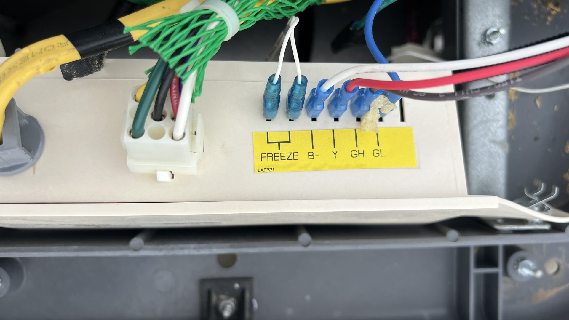

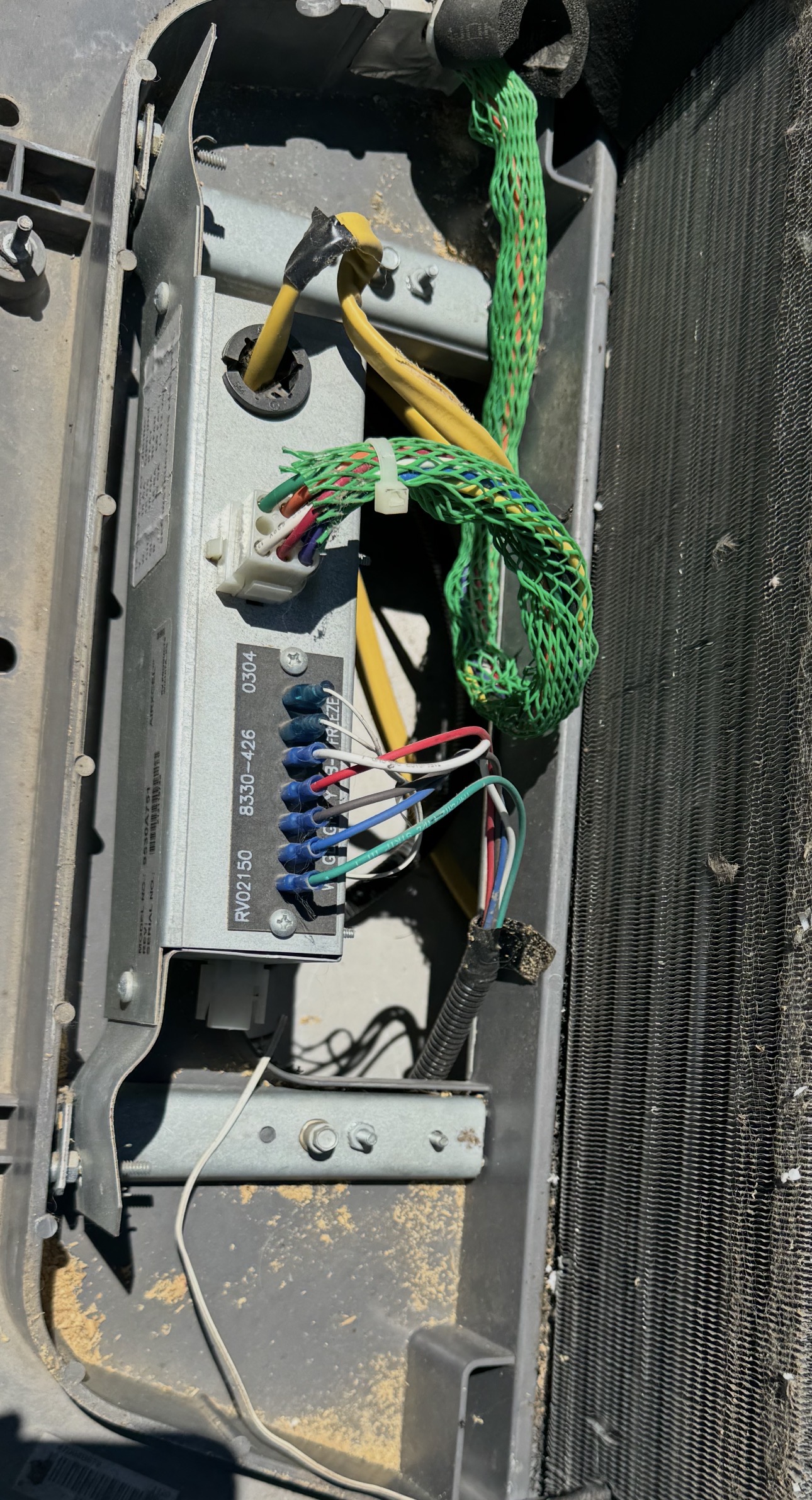

Been thinking about this and now wonder if maybe the control box on the roof in the unit has to be setup to enable a heat pump unit. The control box on my 3 units all look like this -
So maybe that last unlabelled slot was for a heat pump control wire? I think the GL & GH are the fan speed control wires, the B- might be the compressor and the Y common. (Just guessing lol)
If anyone has a working AC with heat pump and knows or has a pic of their control box it’d be nice to confirm if I’m missing a connection. It does look like there is an extra green wire bundled with the other 4 that is not connected to the control box, so not sure if that is part of the puzzle or not.

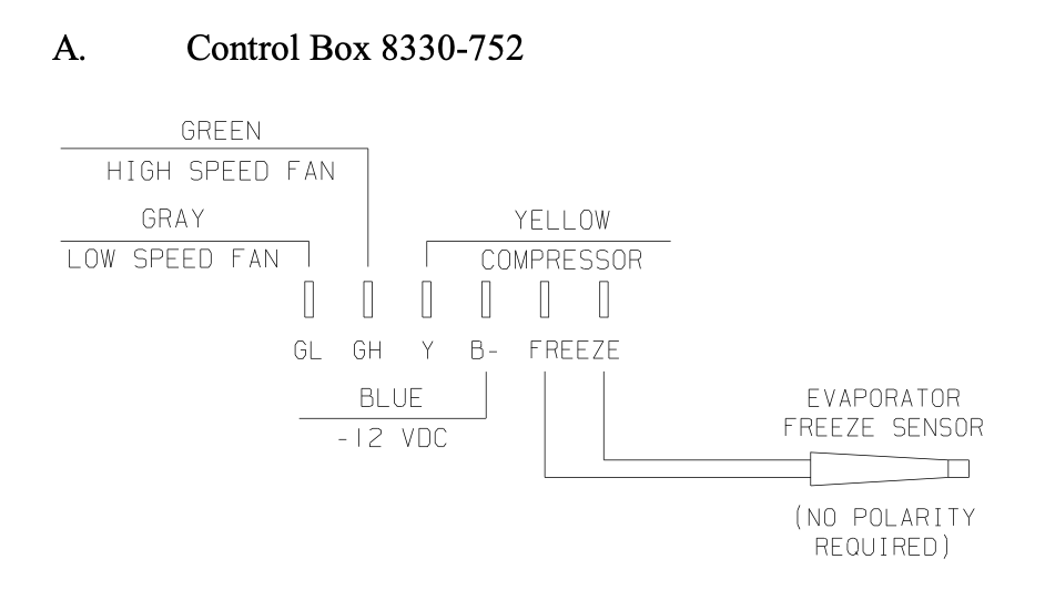

I dug a bit more and found wiring diagrams on the manufacturers website and think I answered my question.
Wiring diagram for the control box installed. All 3 have this model control box and is referenced as a cool only control box.

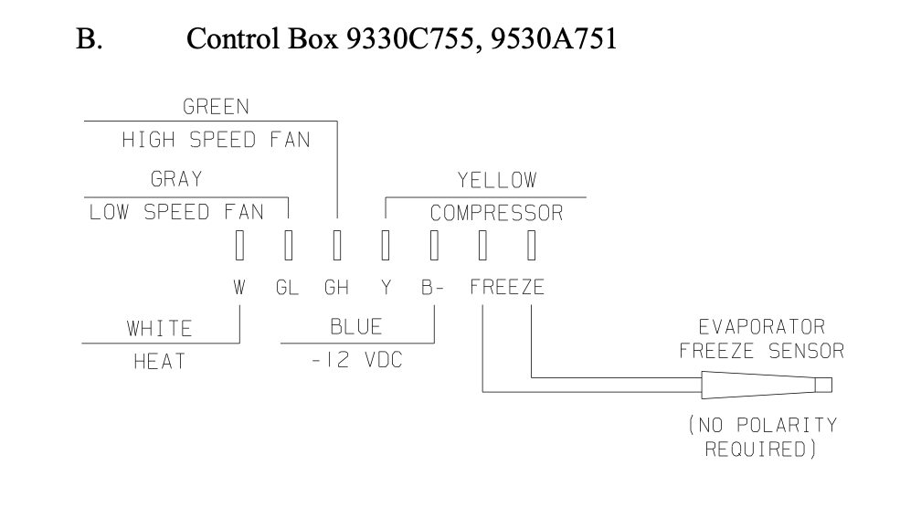

This control box looks to be the one I need as it has additional wiring for heat options. Now I just need to confirm with the manufacturer and purchase if it’s not too expensive.
