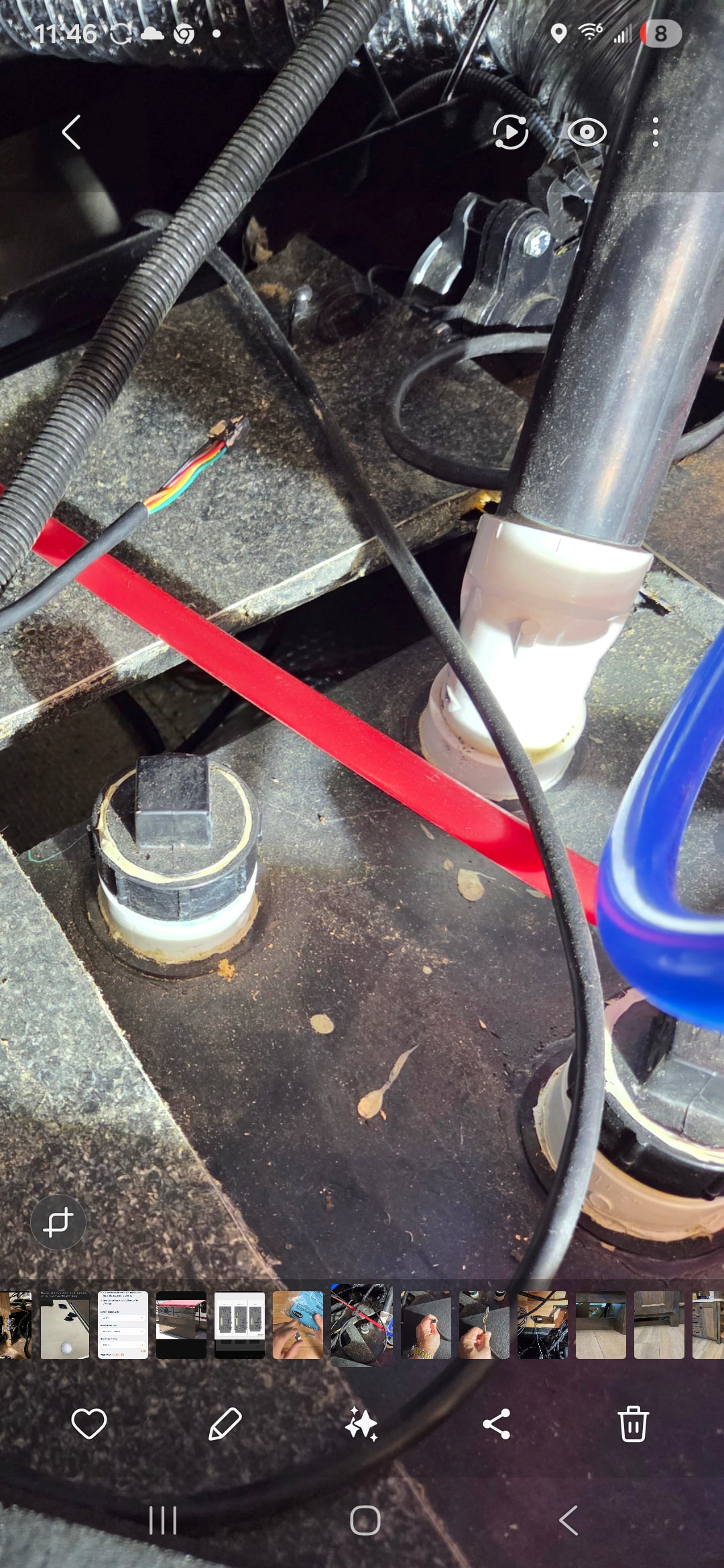

I have a 2022 Beacon FLB and I located mine. It is partially sticking up throught a cutout in the floor behind the passthru wall just inboard from the water heater. It was covered by a heating duct off the furnace

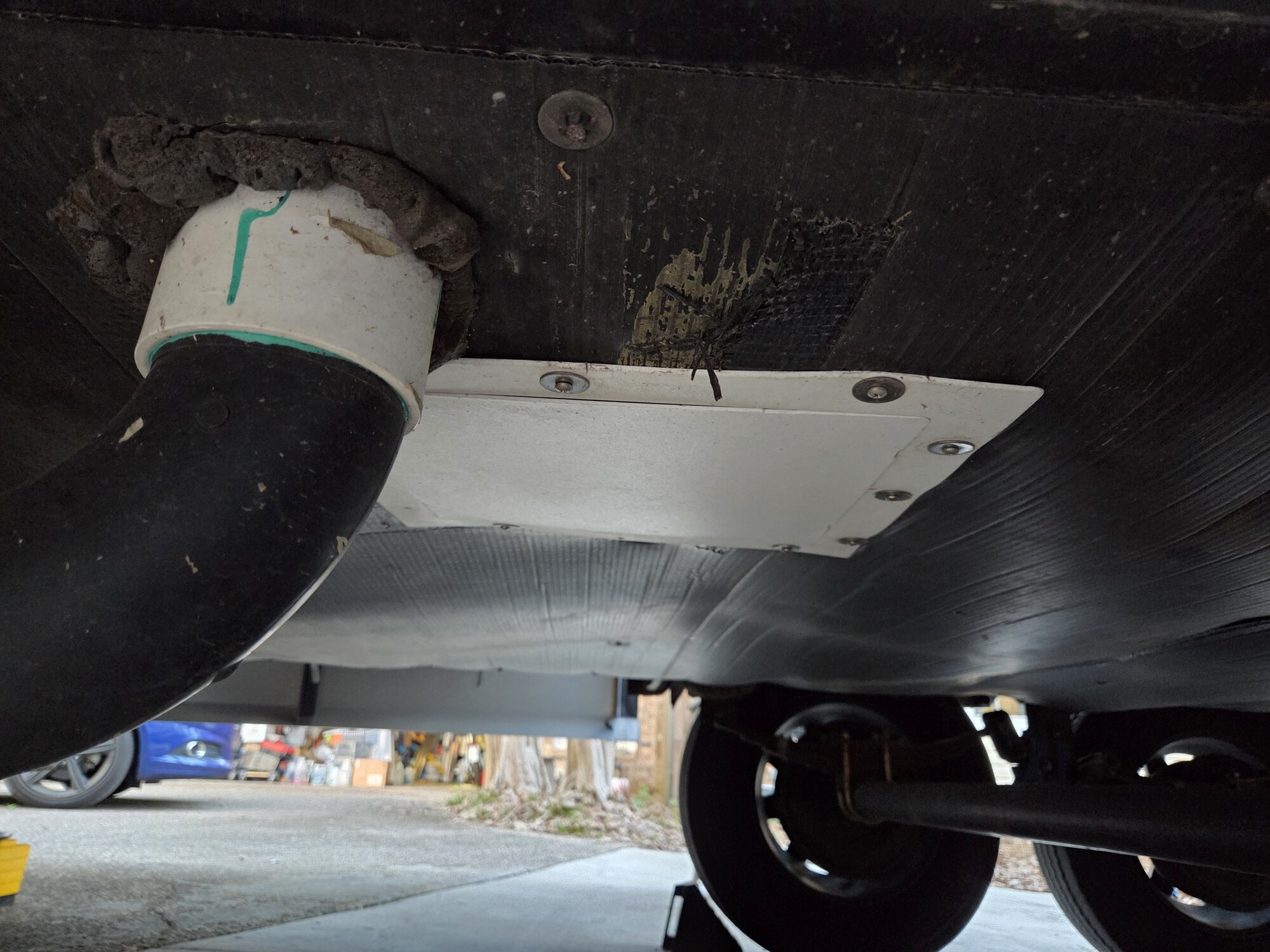

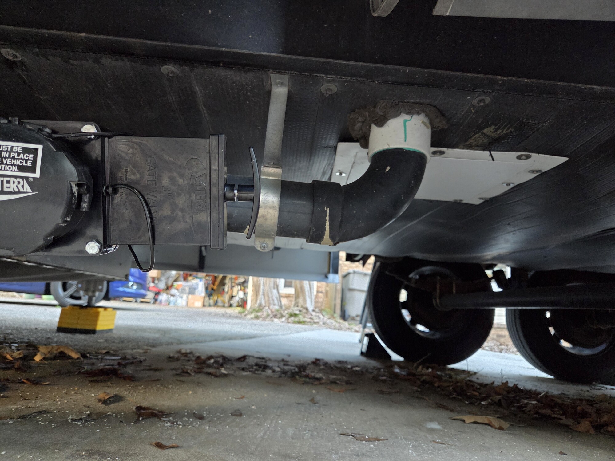

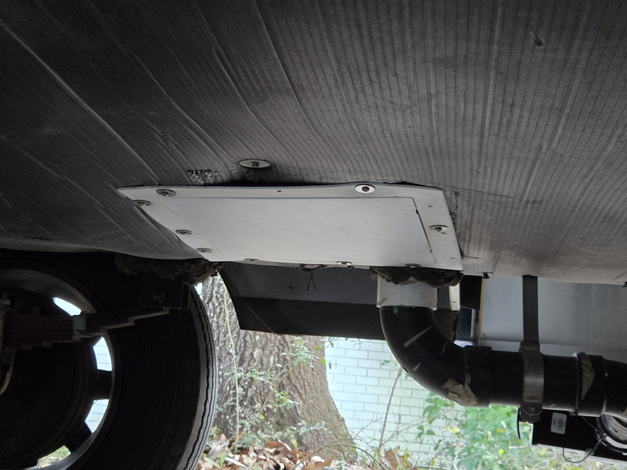

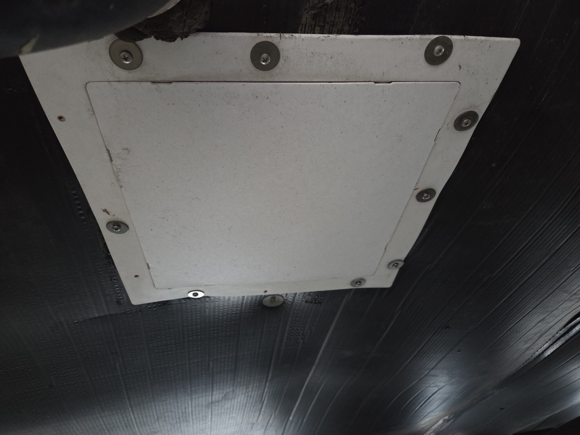

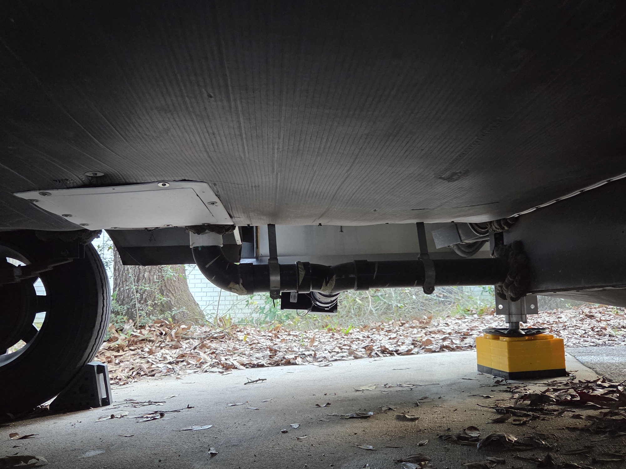

Ok so has anyone seen this before. This is a removable hatch/panel in the coroplast that is just in front of the front axle on the driver’s side of the rig. Could this perhaps have been installed to access the black tank valve when they are not functioning via the electric dump valve?
(attachments)
I think I may have found it. Just posted a new post but here is a preview!
Looks like you do have an access that somebody installed for your black valve. I am positive this isnt factory as I did factory tours about every 6 months at VL and as of mid 2022 they had not done any access in the underbelly for the valves.
I would like to see pictures when you open that up. That looks like street side in front of the tires?
