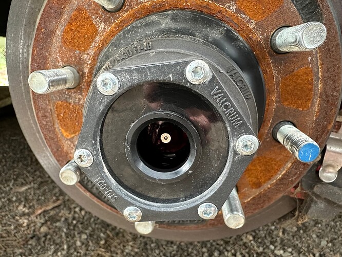

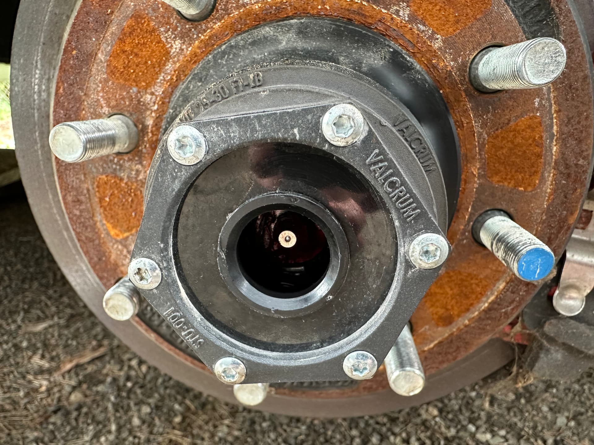

Thank you for the information. I did find that out after I dug in a little deeper. I was able to find the oil bath caps and oil seals on Amazon once I tracked down the right numbers. I completed the conversion over the weekend. I’m very diligent about keeping an eye on things. I routinely check bearing temps and seals for leaks while traveling. I’m still planning to inspect the bearings every 10k miles, but now I can easily change the gear oil annually versus repacking with grease. I’ll hang onto the grease style caps should I decide to convert back to grease.

I’ll provide an update on how it works out. We are retired and use our 5th wheel often, so I’m hoping it doesn’t become a problem. One thing for sure is the oil seals are much more robust than the grease seals. They are a two piece seal versus a lip seal on the axle shaft.
