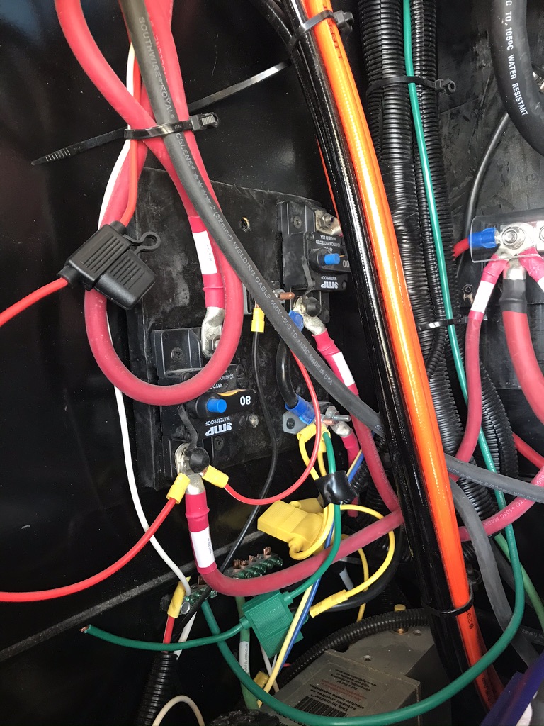

Since these are two different slide types hydraulic (galley & dinette) and schwintek (bed and vanity) I’m thinking it could be related to power and a tripped breaker. I’d check in the front compartment to see if any of the big breakers have tripped.
Front compartment breakers

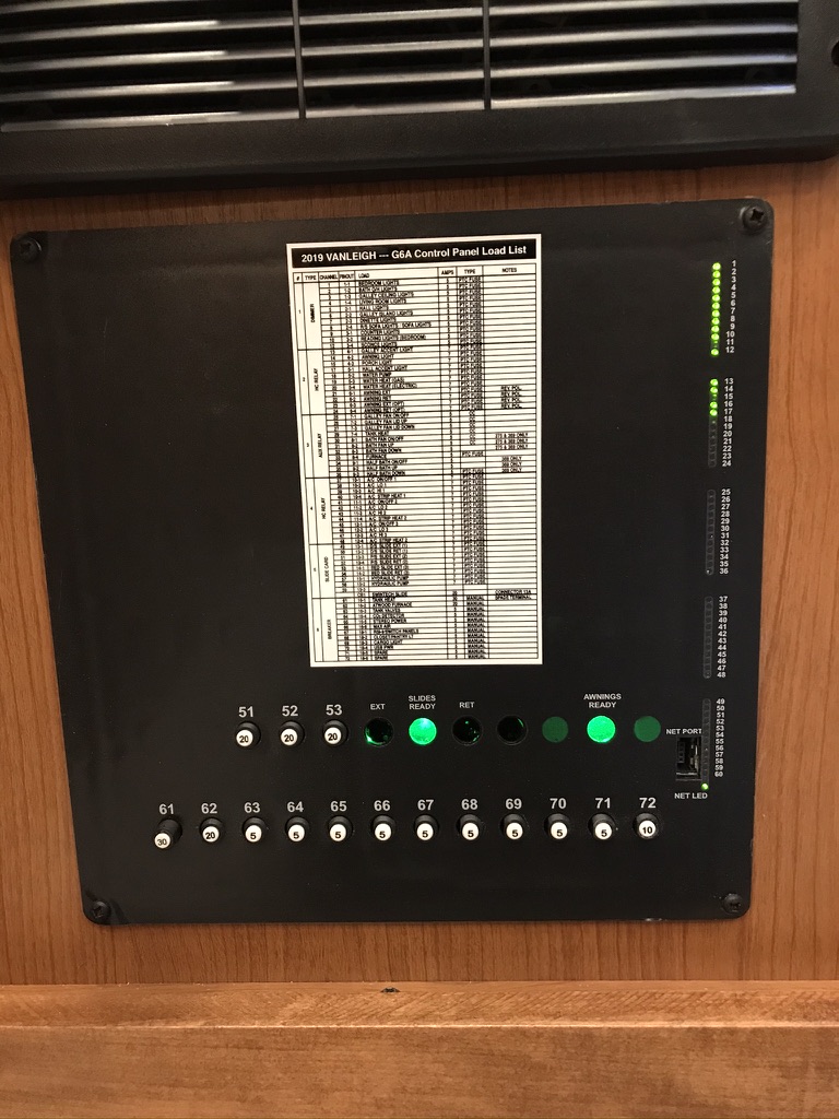

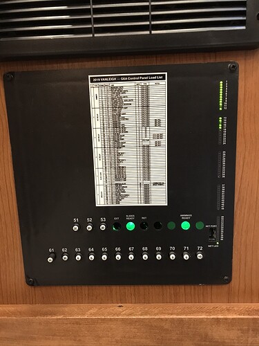

For the schwintek electric check the resettable breakers in the G6 panel.
