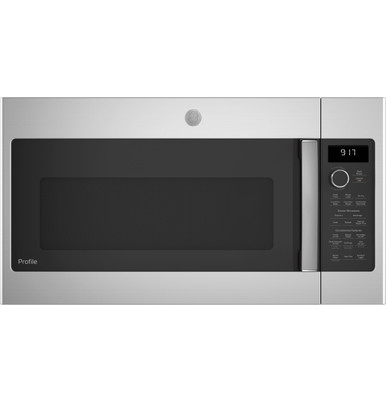

We had plans on putting the GE Profile unit (micro, convection and air fryer) in as it had good reviews and measurements matches. Another full time friend installed it in his Beacon and has been happy with it.

Plan was to go to the GE

My wife loves her GE Profile. After two Furrion microwave dying this has been a great replacement. She uses the convection oven exclusively. Does not like the Furrion oven. Easy to install too.
