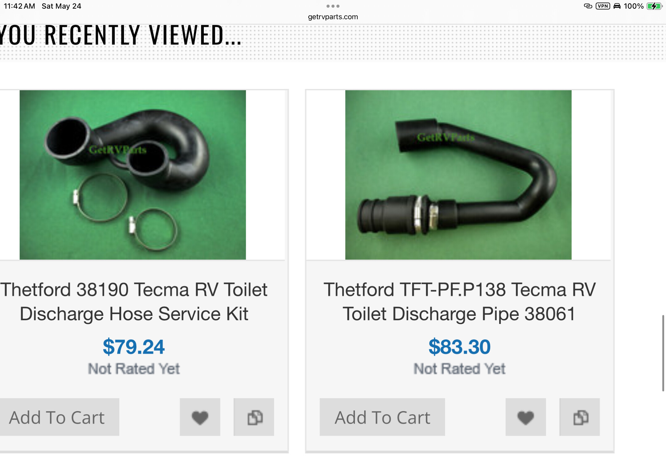

That helps see where the problem is. Does it look like it’s that hard looking plastic nipple device itself or where it attaches to the discharge hose? Wondering if where the leak is could be addressed with something like JB weld as a temporary solution?
Doesn’t look like that piece is called out separately, but might be included with the discharge hose service kit (P/N 38190) that is about $80 here PDX RV Team discharge hose service kit.

I followed your link and found the same issue as other sites in that the picture of the part doesn’t show the air admittance valve which is why I questioned if it’s even needed.
I did check to see where the water was coming from and it was coming out of the end of the nipple so the internal valve has a little leak by after the pressure in the pipe lets the spring relax (at least thats my guess).
I think part of the cost difference between sites is the part I ordered is only the discharge pipe and I think the picture I included earlier also includes the check valve as the lower right hand part of the picture (to the right of the 2 hose clamps).

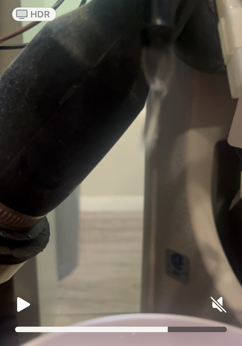

Same issue with Tecma toilet. In our RV it is located in the rear wall of the coach. Takes a real beating back there.
Called Tiffin & they suggested the solenoid Water Valve Vacuum part #38649., but that is not where the drip occurs.
Ordered 1 way check valves from Amazon & will report back.
Screen capture of dripping water from nipple.
