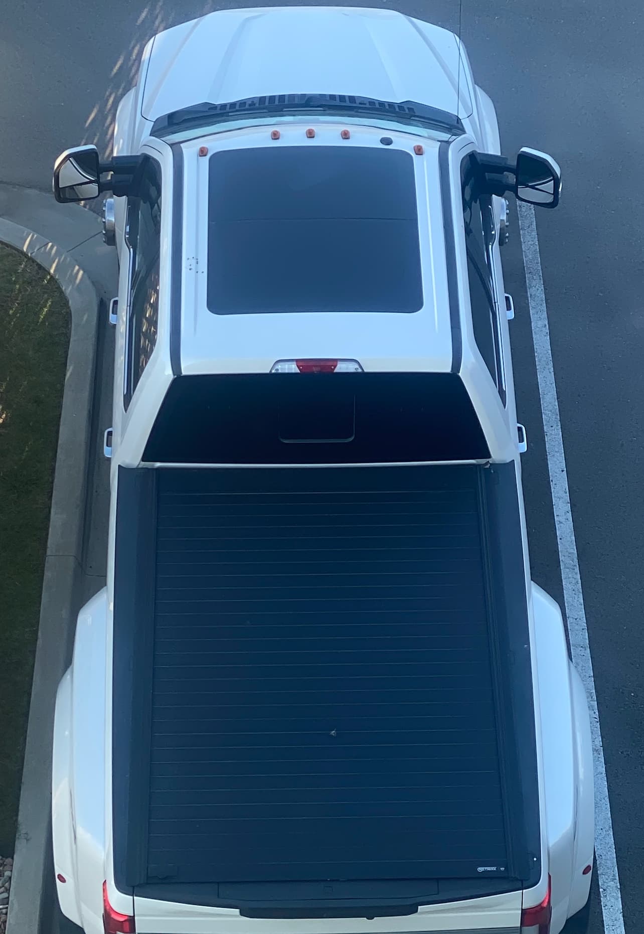

For those that own Fords with those nice large sunroofs make sure you are exercising and lubing your sunroof seals. We didnt open the sunroof on the F450 for a long period and when the button was pressed the lift arms / cables broke. This is my fault but could have been prevented if I would have lubed the glass seals last year. I usually lube with a 3M silicon paste.
There is a lot of plastic in the sunroof track and when the glass sticks to the truck the plastic breaks. Ford quoted me $5200 for the repair and found a smaller shop that would do it for around $4000. I was able to get parts from Sunroofdoctor.com and repair it for $300 myself.
If you are in any Ford forums the sunroofs are nice but are known for lift arms or cables breaking. Keep the seals lubed so you can avoid my situation and if it breaks don’t pay Ford what they ask for those parts.
