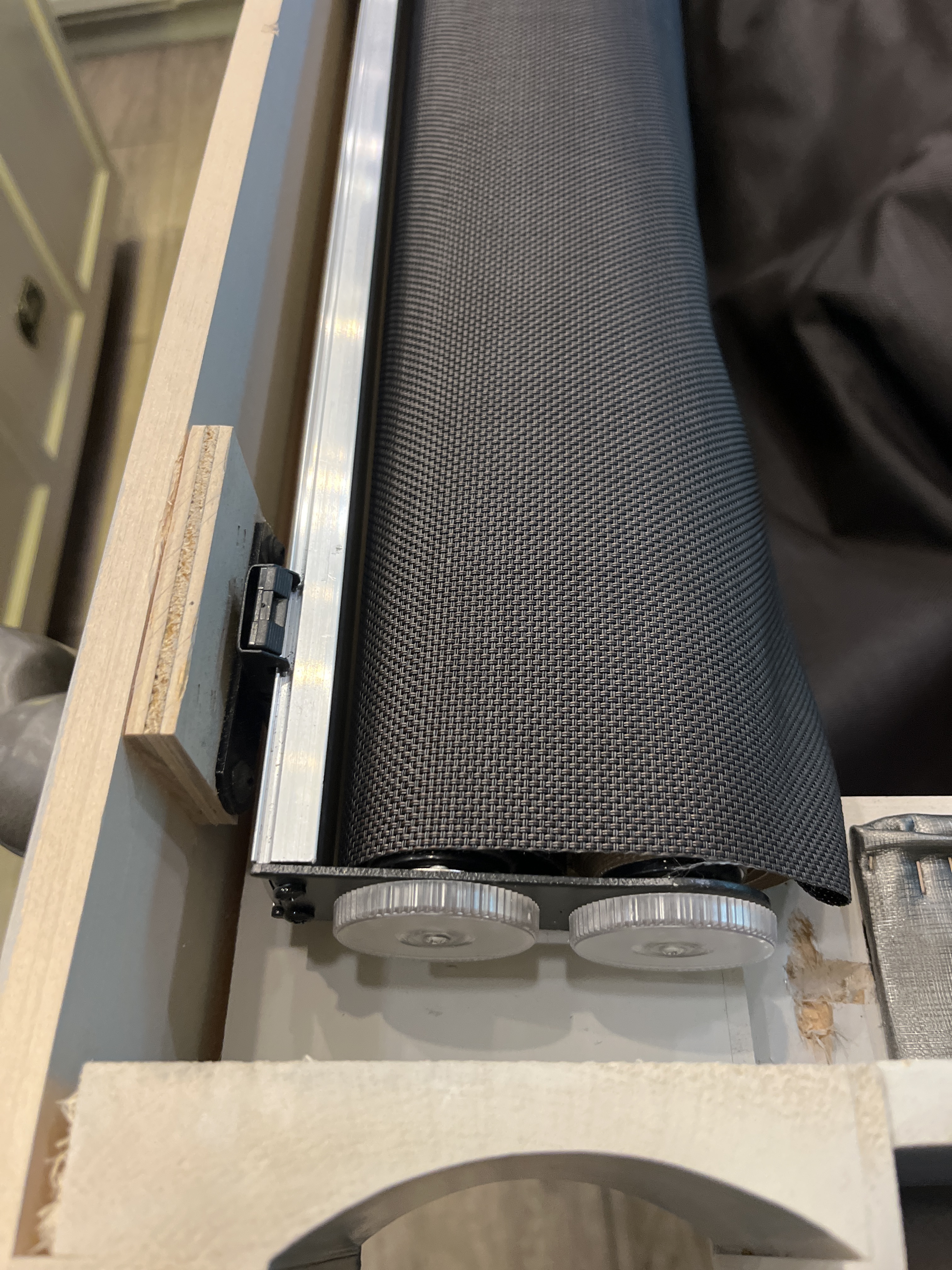

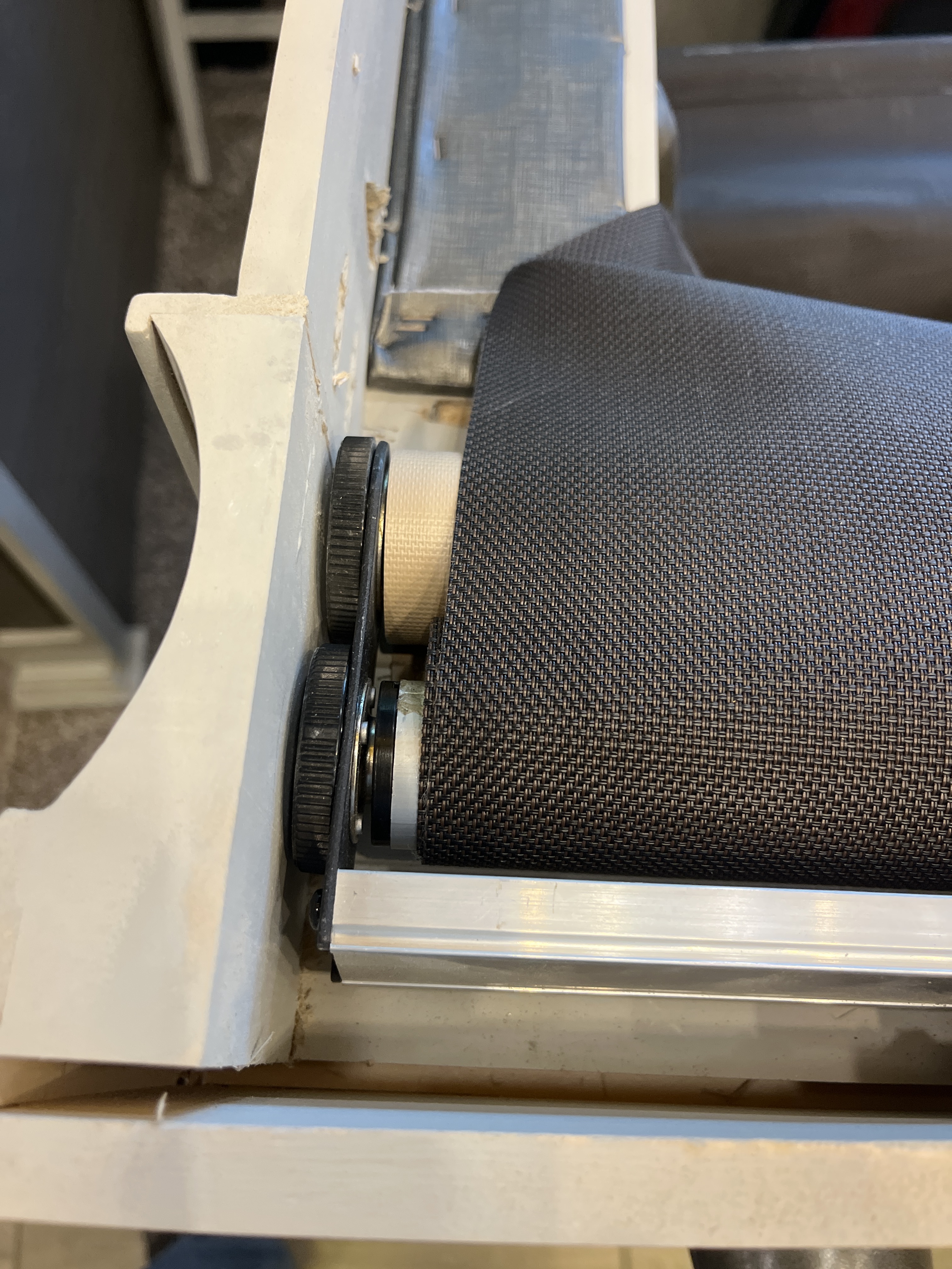

Right side wheels
Left side wheels

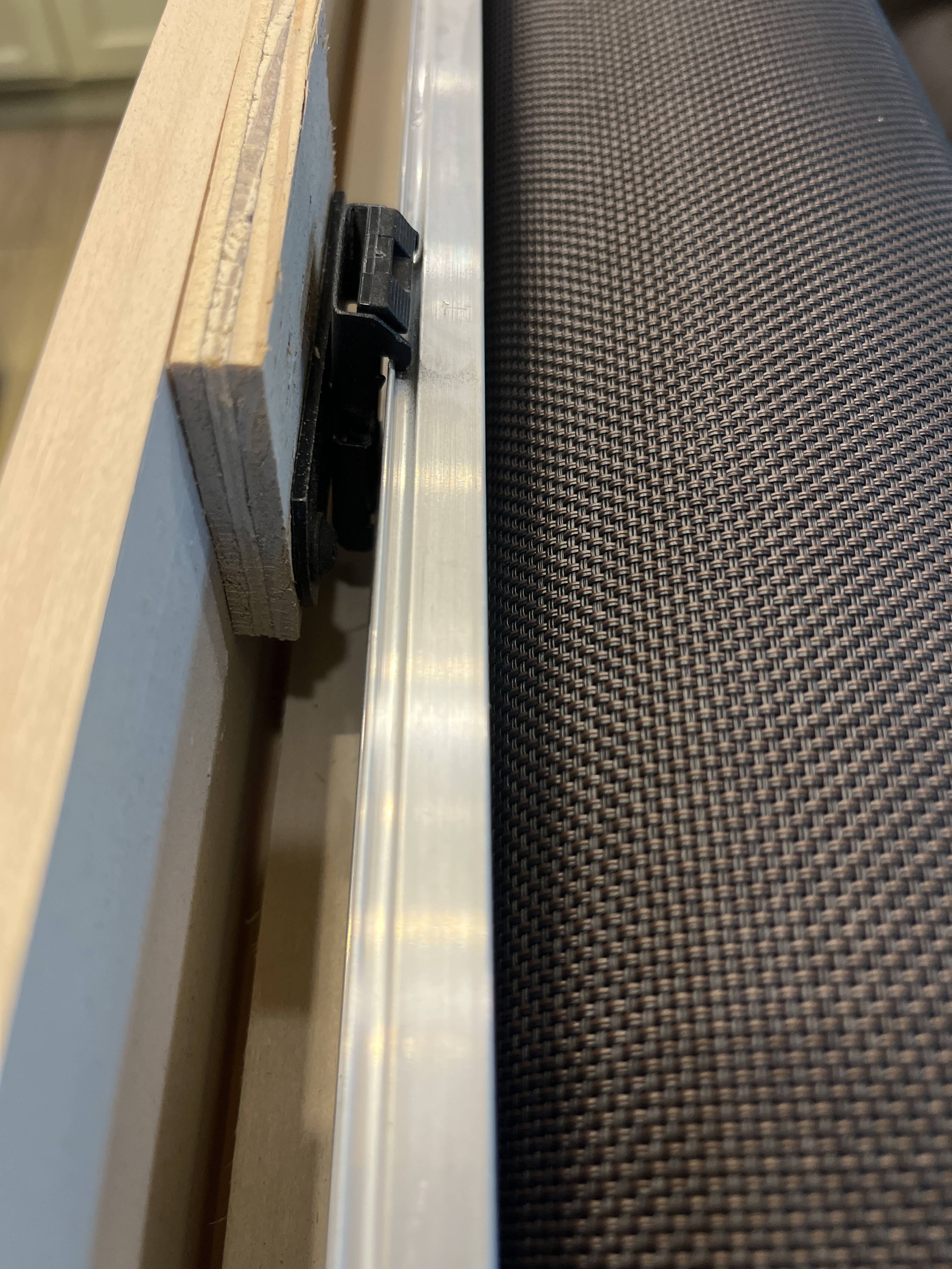

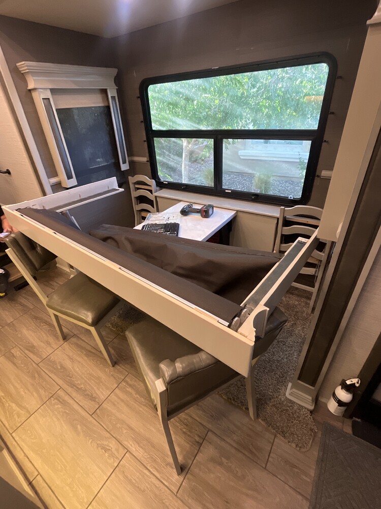

Valence removed
Clip that I can’t figure out

They have video tutorials on their site for adjusting the blinds and replacing springs. That clip will pop loose with a screwdriver. Those guys at Tish showed me how to remove the blinds without removing the valance - tight fit if you have bigger hands like I do but you may not have to remove the blinds the next time once you see how they work.

Like Ryan said the retract spring has broken on that shade. The side contains the limiting mechanism to adjust the height and retract speed / force.

Removing the smaller shades is easier as there are only two clips holding them in and can be removed without removing the valance as Ryan mentioned. The larger ones have either 3 or 4 clips holding them on and I found it easier than to remove the valance to access the clips. Made it easier to attach them back too.
What is the trick to release the clips? Must be a two or 3 person job since there are 4 clips.

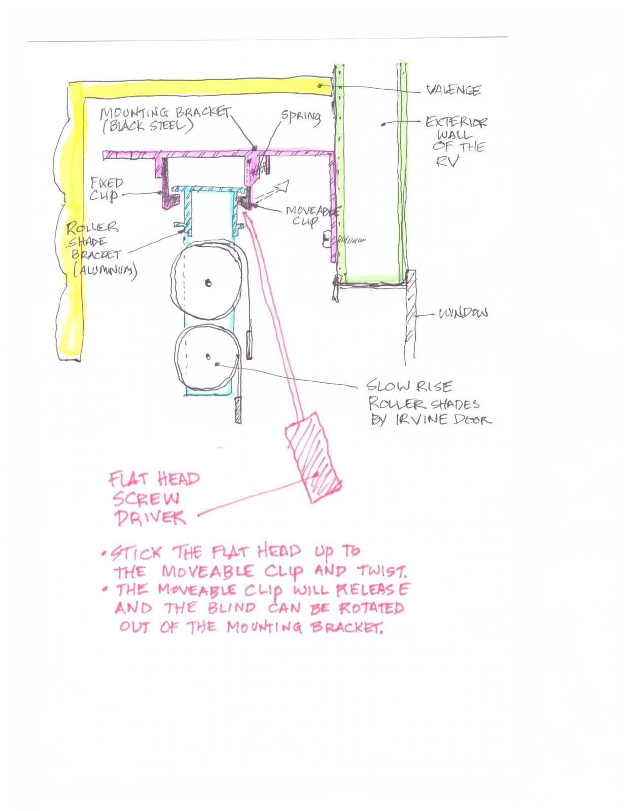

As you have found those clips are spring loaded. On both small and large shades I push the blind toward the wall and release the clip on one side using a large screwdriver to push in the clip and tilt the blind out of the clip and then work the other side. I did the same on the larger blind working my way down the clips.

The galley shade rail is 61.5” & measures 62” outside wheel to outside.

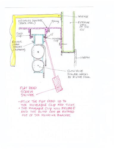

I found this drawing so will give it a try!
Good find on the drawing!

I took the entire valance and shade assembly down since I was also needing to replace the spring mechanism and just reattached the shade material and carefully rolled it back on to the tube. Seems to have held up so far too.

Stuart - How did you remove the valance? I am missing something.
There are several small screws that attach it to the wall
Look on wall & you will see the L brackets
Like TajMyHaul stated, there are a number of screws along each side of the valance structure. Once you remove those, the whole unit should come right off the wall.
