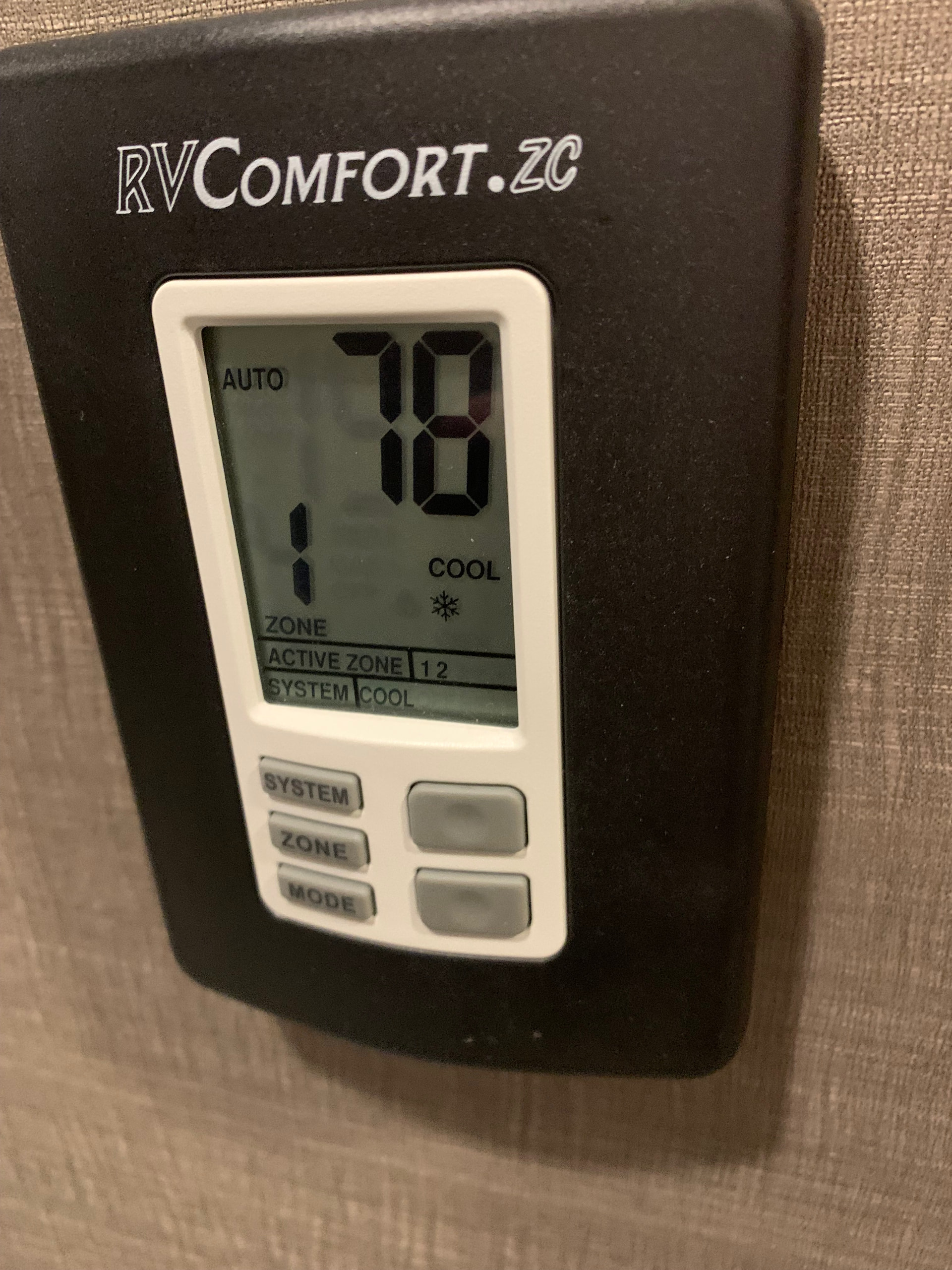

Thanks Stuart I will take a second look my control thermostat is a basic one also
Hi Stuart Im running both ac and the bedroom one sounds like it has 2 speeds of cooling and runs very well.'the problem one is the lounge which Im getting 68 degrees coming out of the vents and around 82 degrees outside. The lounge one doesn’t appear to have as much power or that higher speed of cooling.
I’ve also cleaned the thermostat and the sensors with an air blower any ideas could it be a failing capacitor?
Hey Tourusa - I’m not really familiar with that thermostat but to looks like a multi zone t-stat so it should control both AC units ( like front and rear zones or whatever location they’re in).
This website https://thecampingadvisor.com/how-do-you-use-an-rvcomfort-zc-thermostat/ has some info on the usage and troubleshooting. I downloaded the manual and saw some info that might help in the setup and functionality of each zone.
Thanks I’ll take a look see if there is a reset

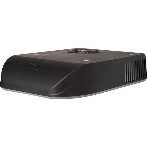

Hi guys after great amount of cleaning Im getting 64 degrees inside whilst outside is 80 degrees. Thinking for next season may be time to upgrade, would you know what btu my current unit is ?
Im looking for a ducted one same as the one I have after a quick search this one came up and is 18k btu . Furrion Chill Cube 18K Variable Speed RV Air Conditioner, Ducted, Black
Let
Me know your thoughts and have a great 4th July
Sounds like the temp difference between outside ambient and the inside is good. Typically RV AC units can cool the interior down to about 20° below the outside ambient temp.
Not sure what Vanleigh supplied on the Pinecrest models but think it would be the same Coleman-Mach 8 15K BTU units on the Vilano & Beacon models. Since it doesn’t look like you have the AC units integrated into a Spyder control and they use a standalone t-stat, you might be able to use any ducted RV AC as long as they’ll fit the standard 14" roof opening. Worst case you may have to swap out the t-stat to support the different brand AC though.
I replaced two of our AC units a couple of years ago (both Coleman Mach 8 units). Purchased through Dyers since they had a good price.
Thanks Stuart, I have the temperature probes and would only switch one to the furrion model as the bedroom one is working will currently. The furrion comes with a remote as I wasn’t sure if it’s plug and play to the current thermostat
