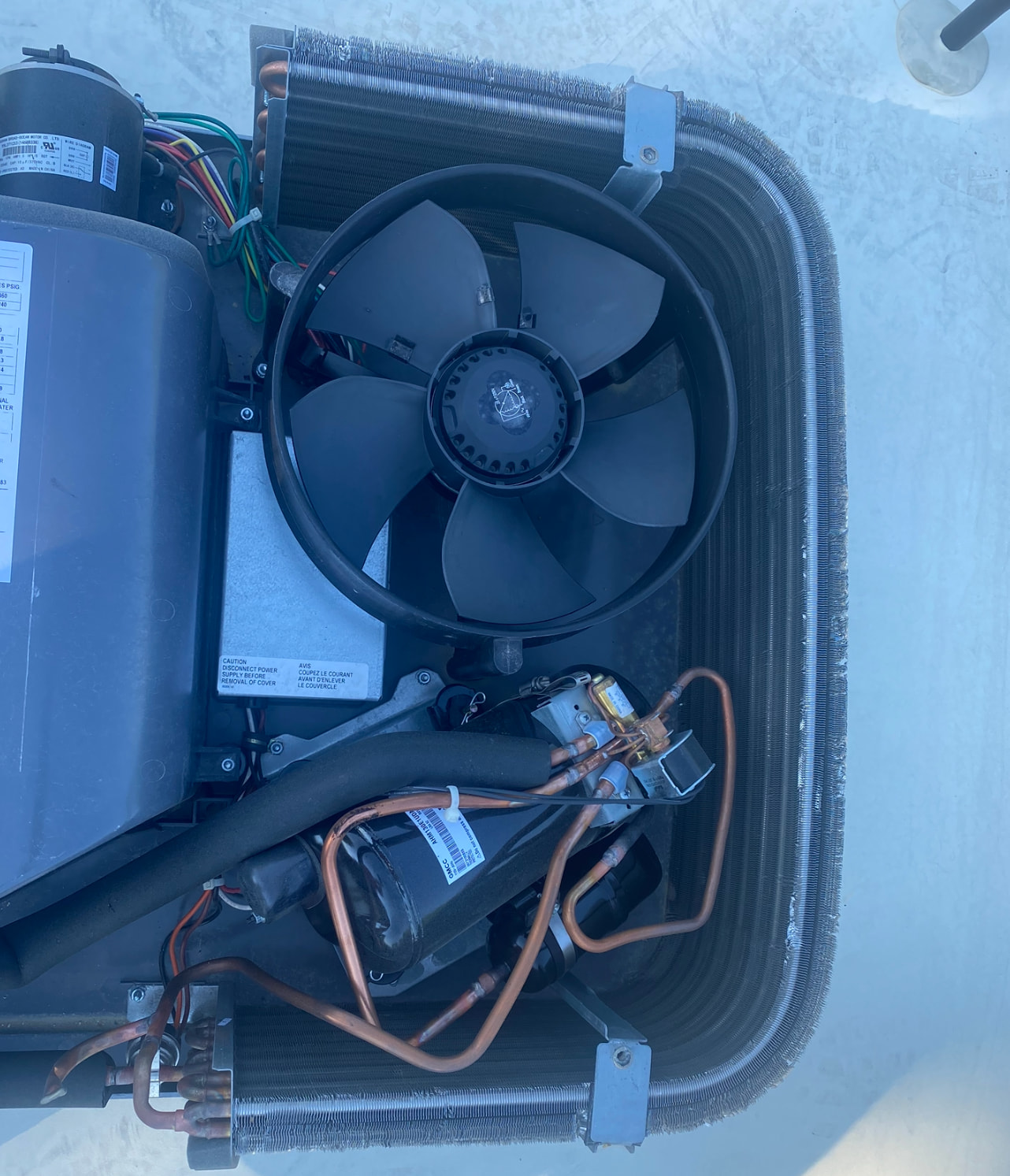

Okay you must be looking for the condenser fan shown in this pic of mine:
I did a quick google search for the model number of Coleman Mach on my Beacon (47004B679) and saw some posts referencing changing the fan assembly and the new upgraded 3 blade fan. Let us know what you end up chasing down. Good luck!
Many thanks Ryan, that is the one i was looking for, finally had some luck with Ebay found the complete unit which should be just plug and play, exactly as your picture, again thanks for the help.
