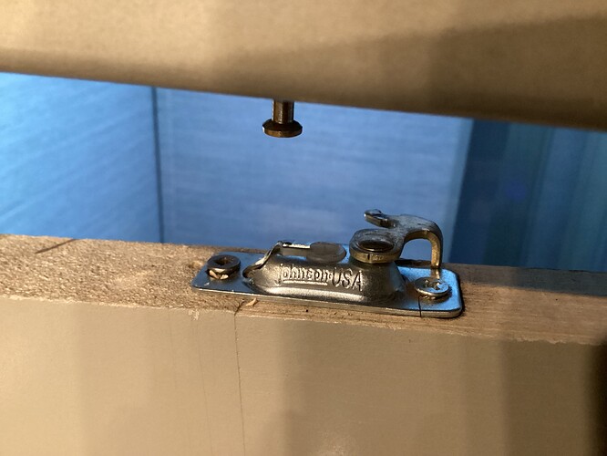

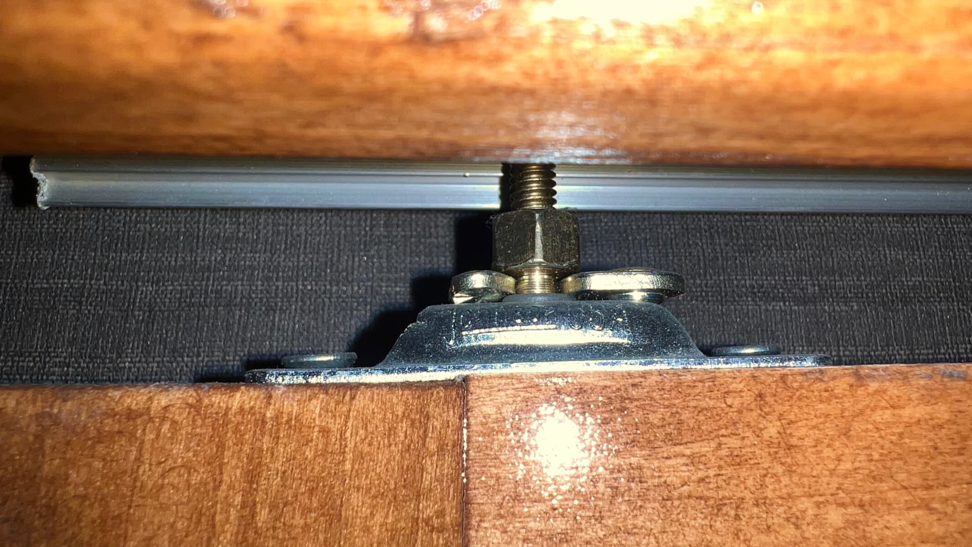

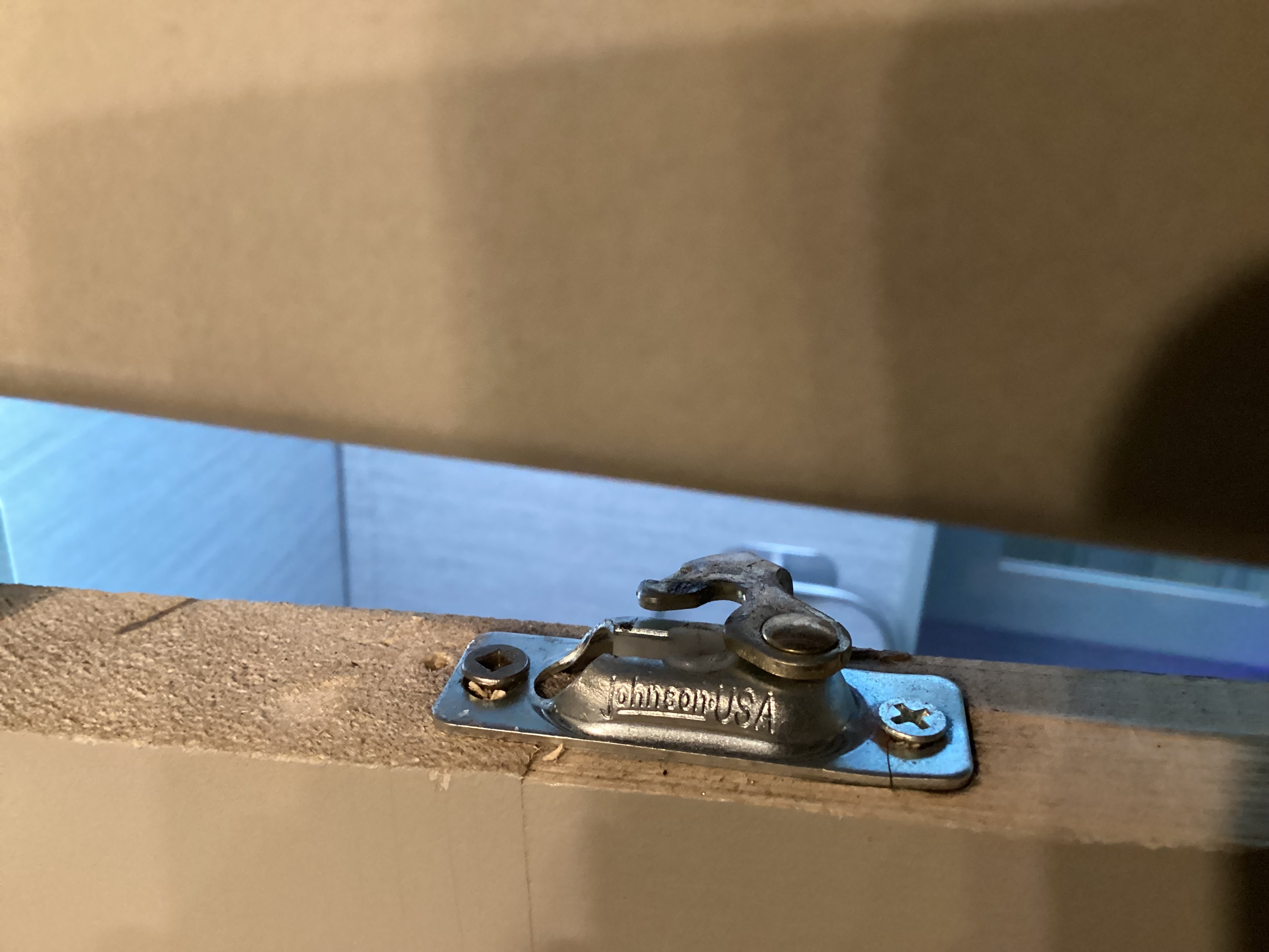

Assuming you’re talking about the pocket style doors. We have two of those in our 39FBB, for the bedroom and the main bathroom. On ours there are two clips on the top of the door where it attaches to the track rollers. If your is the same, you’ll need to rotate the clip out of the way to release the door from the rollers.
I’ll see if I can get a photo to better illustrate what I’m describing.
Thanks… that helps.

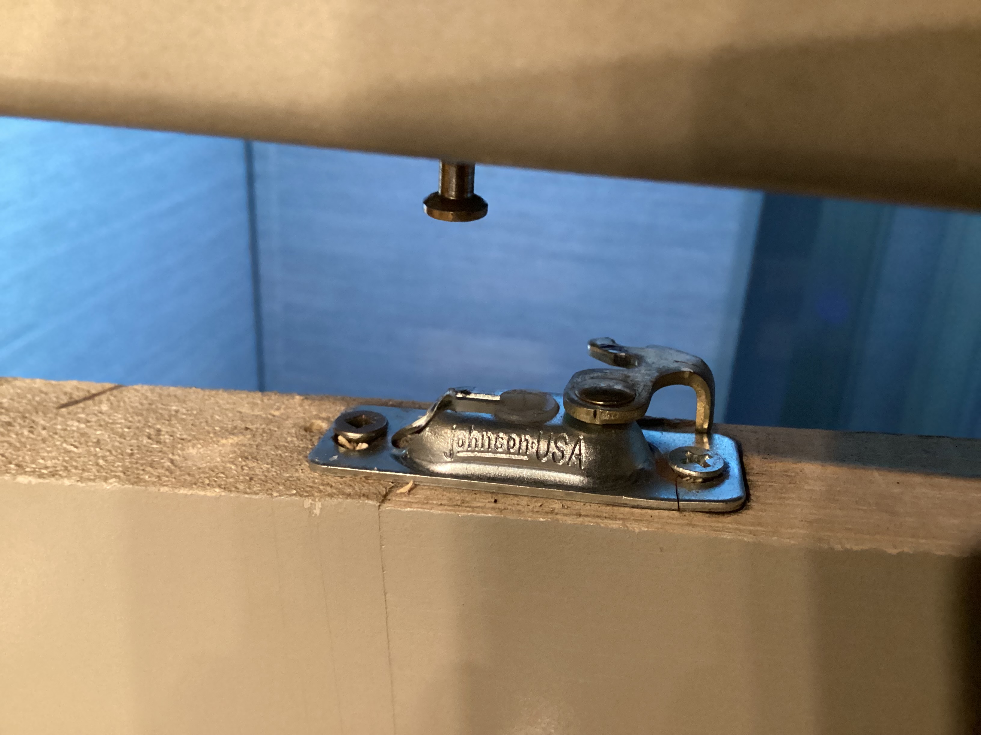

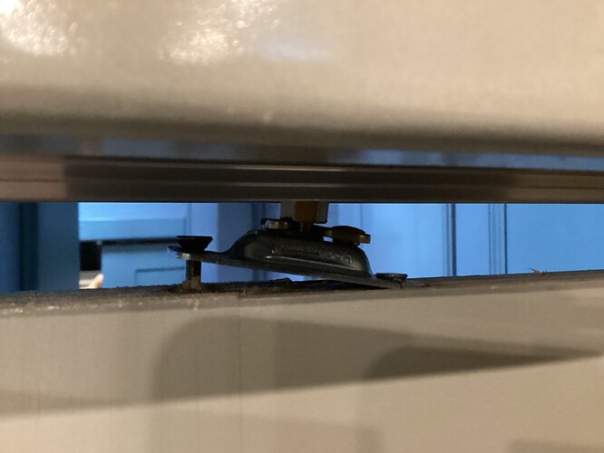

Screw that hols roller to door jiggled down. Will try to fit a wrench on brass piece to release it from the track to tighten the screw.
Moved brass CIP towards inside bathroom & slid roller out to access & tighten screw
