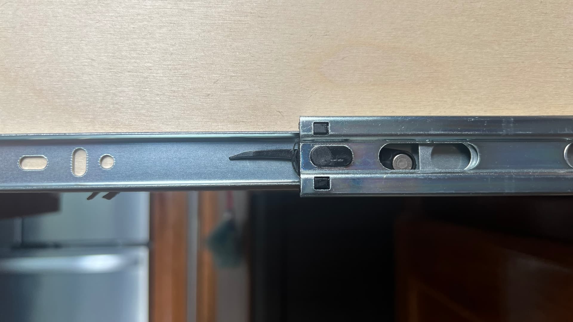

Hi Chuck - We don’t have the booth in our 39FBB, but they should use the standard drawer release mechanism, like the other drawers have. If you look on the side of the drawer slide you’ll see a black plastic release one on each side. You’ll need to press them both in (usually one side pushing up the other side down) and that will release the drawer to slide completely out.
Drawer slide lock release
Putting them back in, just line up the slide rails and insert the drawer rail and slide it back until you hear the release click back into place.
