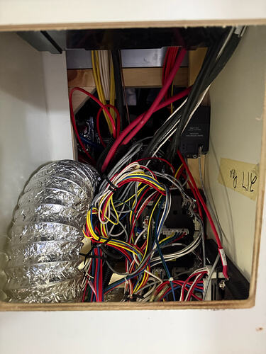

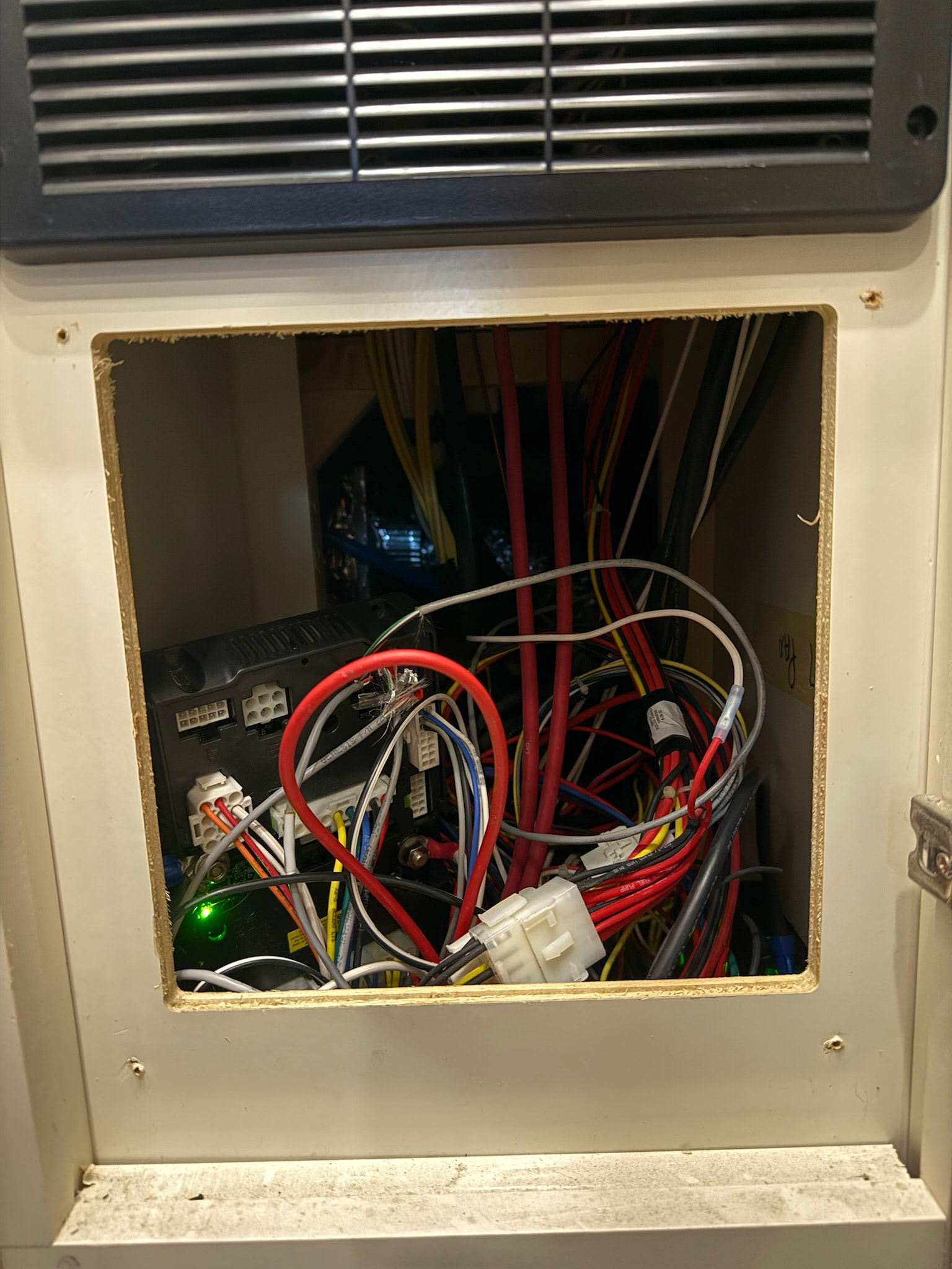

Wanted to close the loop on this.. Had a mobile tech I trust come out and tidy things up.. He re routed all the wires, mounted the modules to the walls etc.. Overall took about 3 hours and his knees and in the compartment.. (I could have done it but my back etc. would have regretted that position). See attached pics before and after. Please excuse the not great pics.
Jon thanks for the update.
I believe the first time I saw how the G12s were haphazardly placed into that compartment was when Eric posted his. The previous version (G6) made for a much cleaner install as the unit was mounted. Looks good.
I can clearly see your Mira mounted back there in the second picture. Do you use your phone app to control the system?
