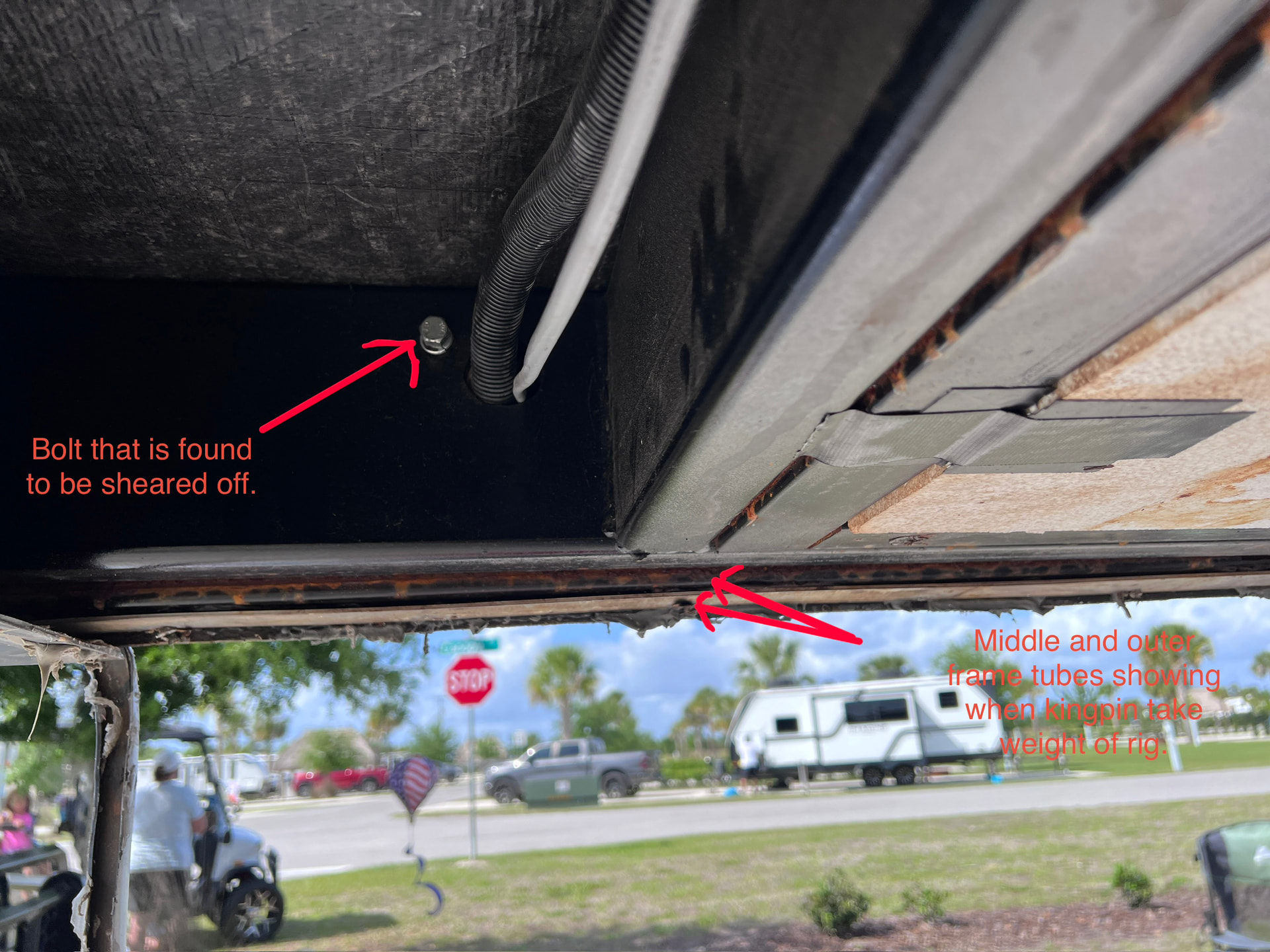

I’m posting to document a serious issue and see if others have encountered anything similar.
Unit: 2021 Vanleigh Beacon 39FBB with Lippert frame
Failure location: Front frame structure between the king pin and upper deck riser
Observed conditions:
  • Frame fracture on both sides in a non-welded structural section
  • King pin displacement upward of ~2 inches under load

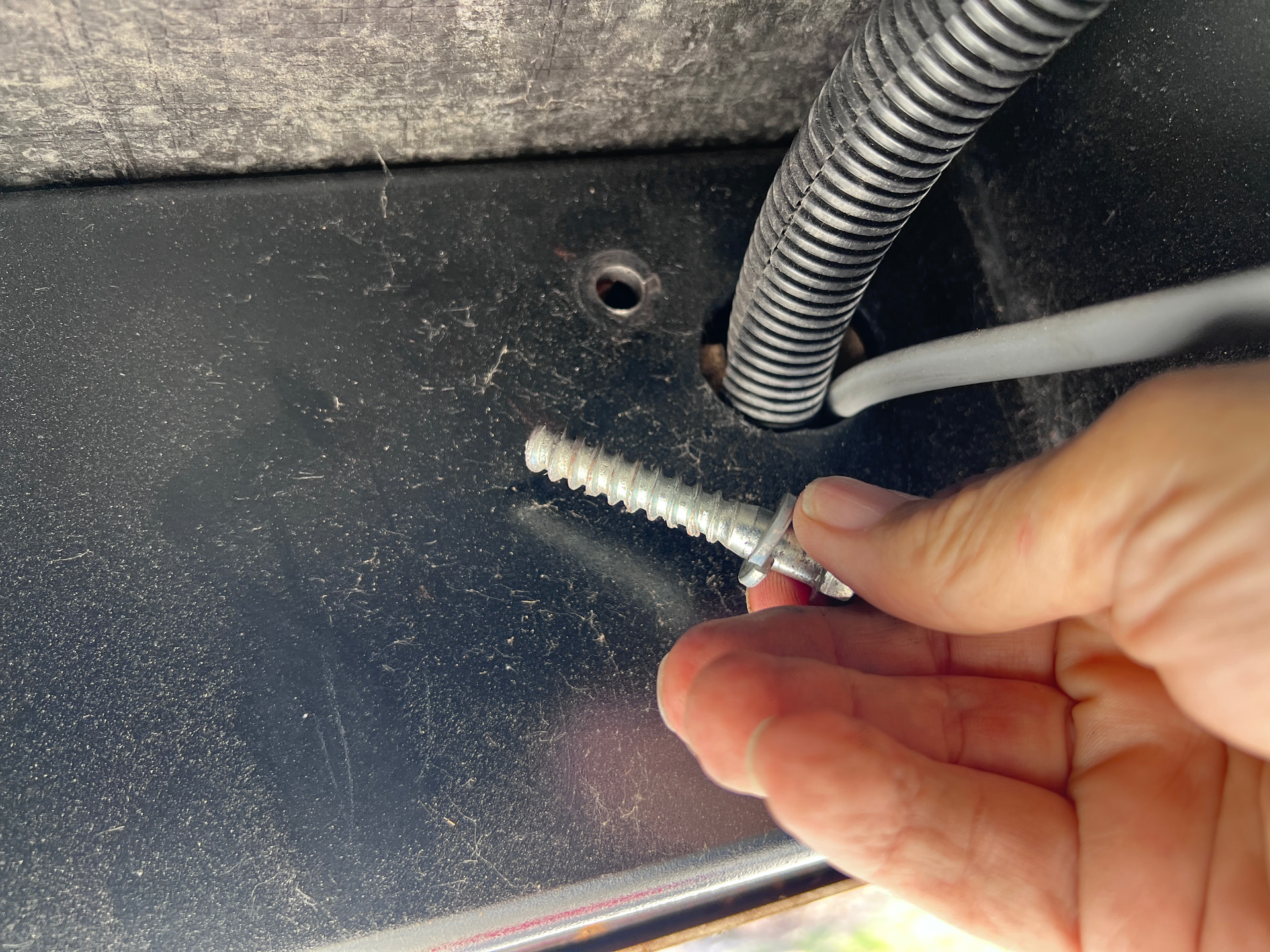

  • One structural fastener has sheared (not loosened or backed out)

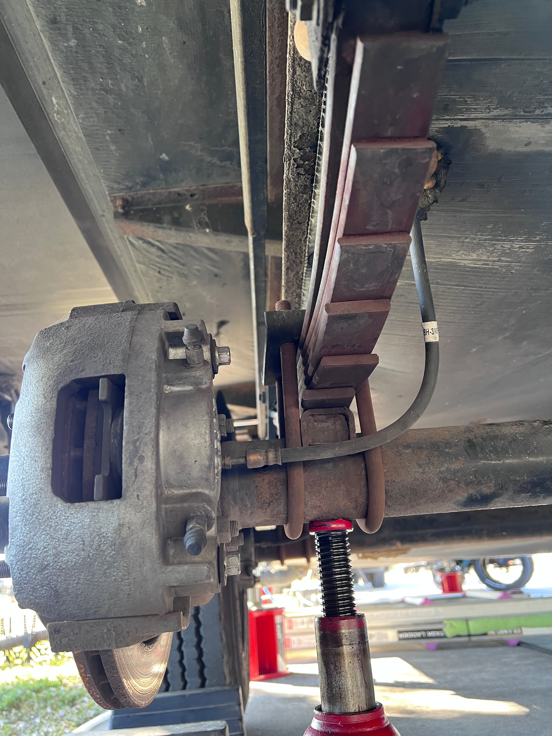

  • Frame members visibly separate and shift when hitched

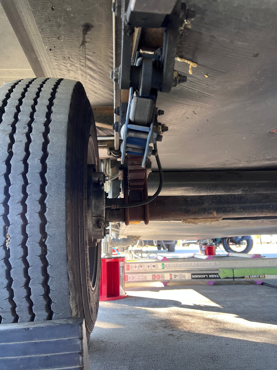

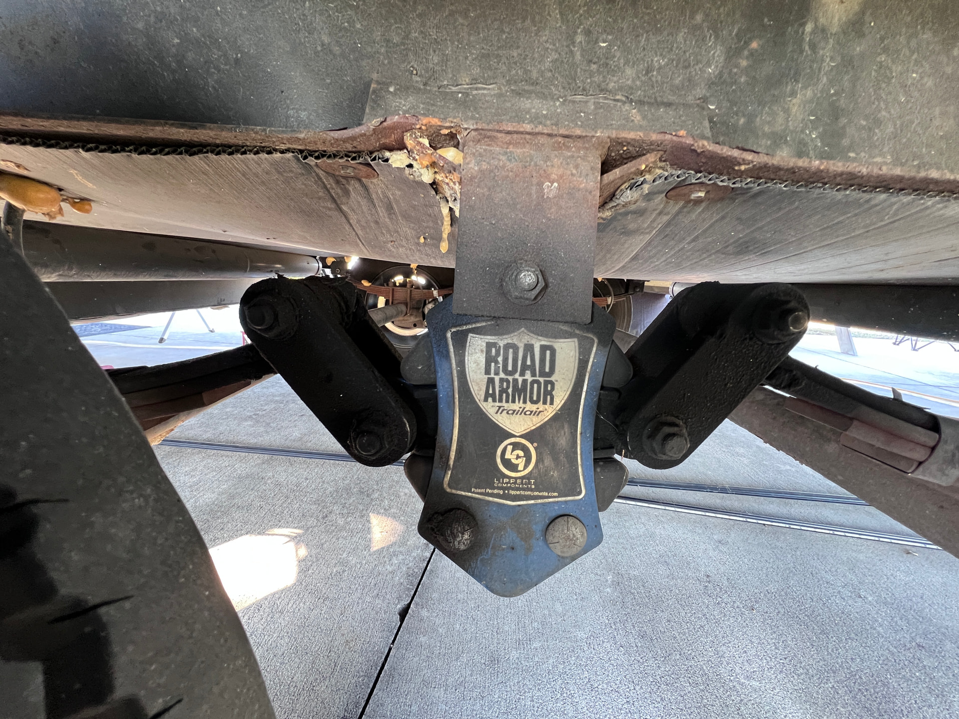

  • I-beam at suspension/equalizer area is bent outward and misaligned
Additional notes:
  • No accident or impact history
  • No evidence of overloading
  • Failure appears to have progressed to a point of load path disruption

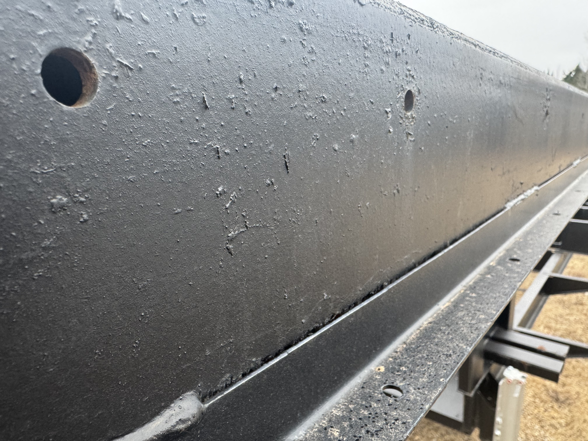

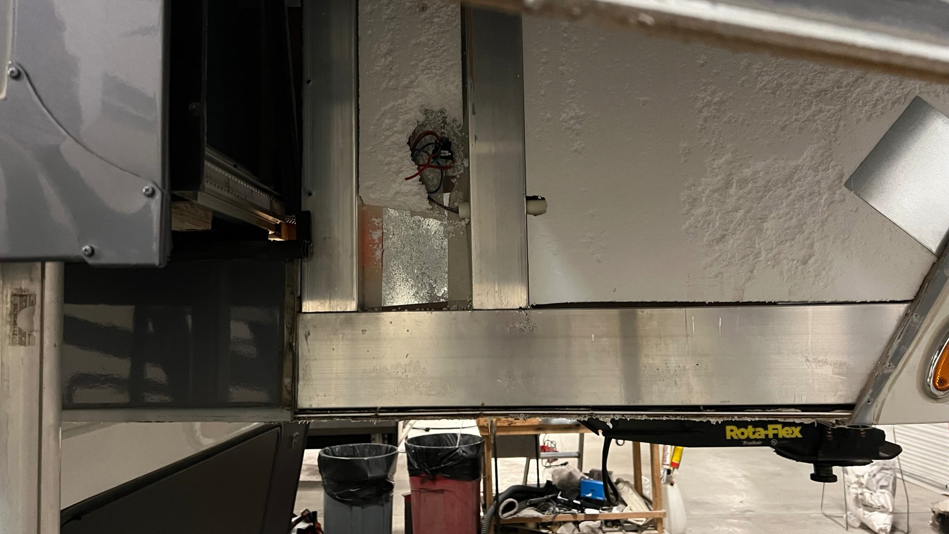

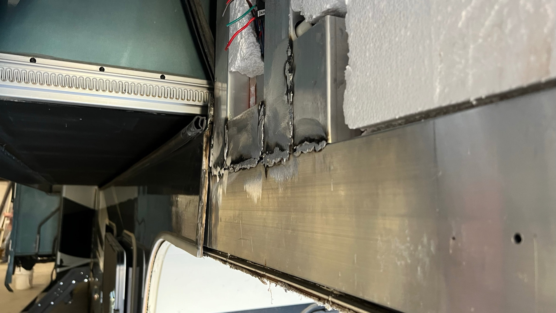

In your video the movement you are seeing is the walls separated from the frame and why the bolts that go into the wall from the frame are sheared. The angle iron that is tack welded to the steel tube of the frame and supports the wall has broken loose. The holes you are seeing are the tack welds broken free. This is happens often along with the typical flex issues.
My angle iron was also broke and had to be welded back. That angle iron is often missed in flex repairs and the wall is reinforced and the angle not secured causing the issue to occur again. That piece can take a new weld with the filon removed like you have it but the uncertainty would be additional breaks within the wall.
I know a Vanleigh owner that went through 5 repairs and on the 6th his insurance totaled the RV. There are several posts about flex in this forum in addition I have a video where we outlined our repair.
The first repair New Horizons. The second repair Affinity RV Group.

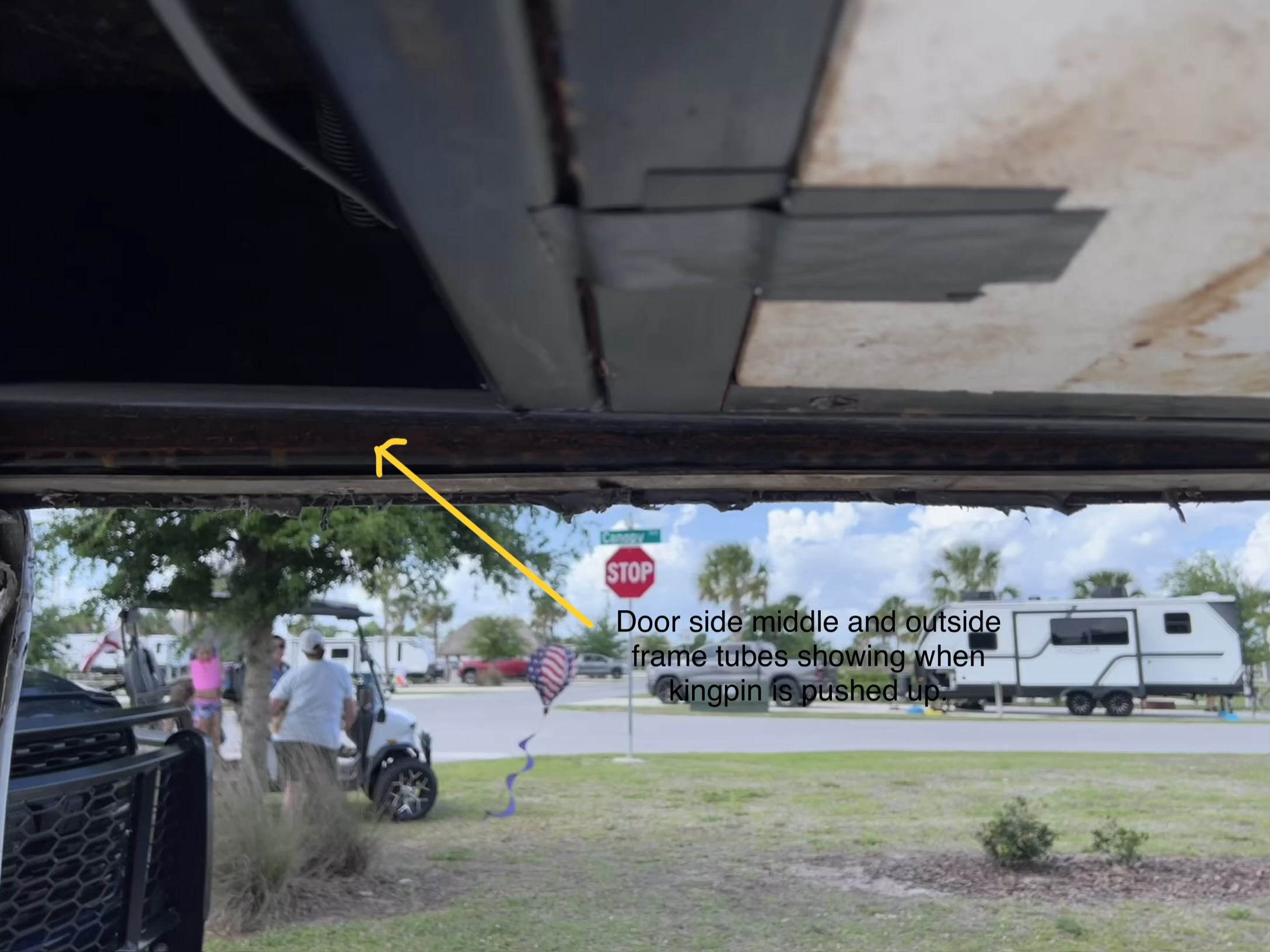

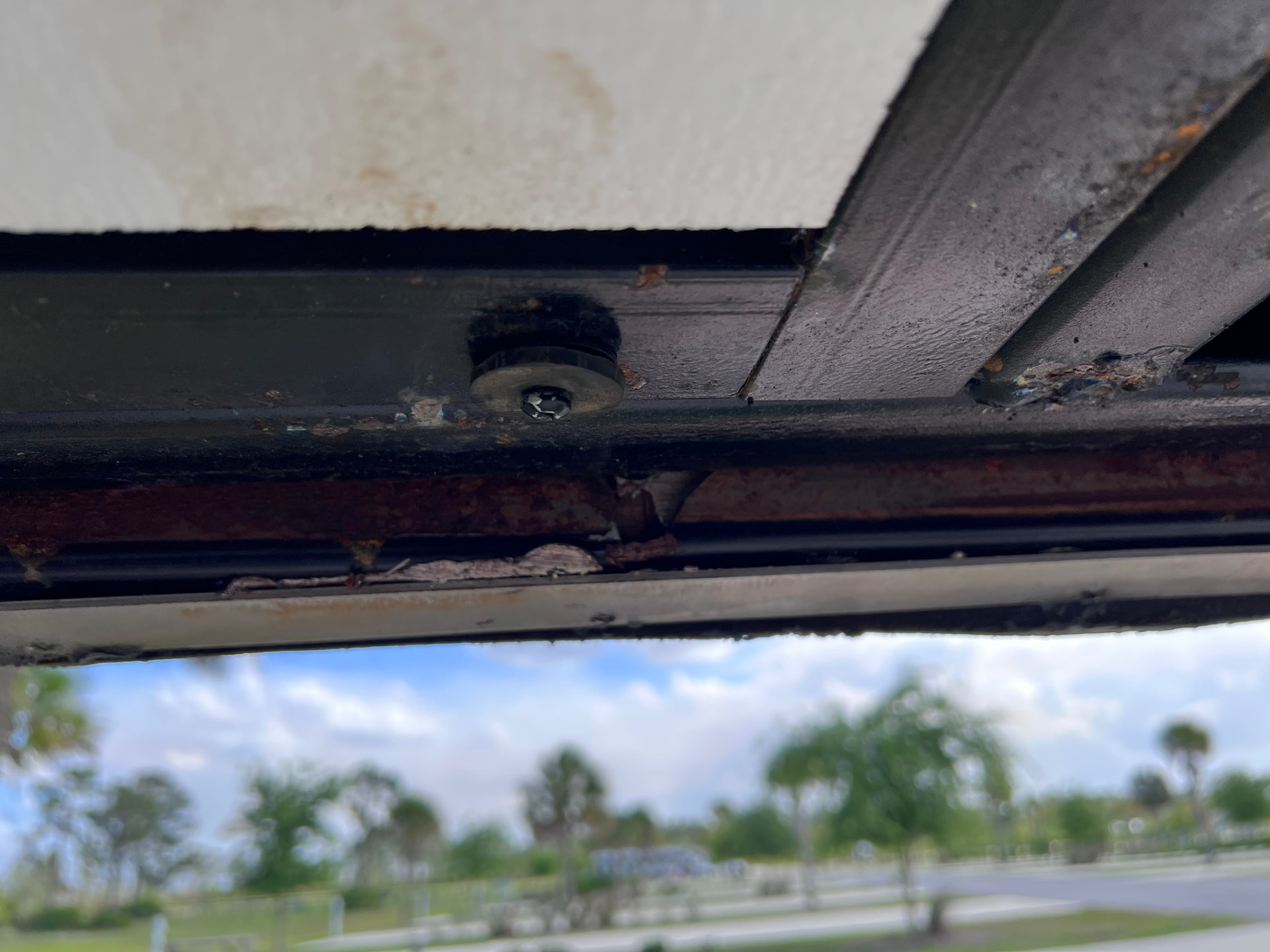

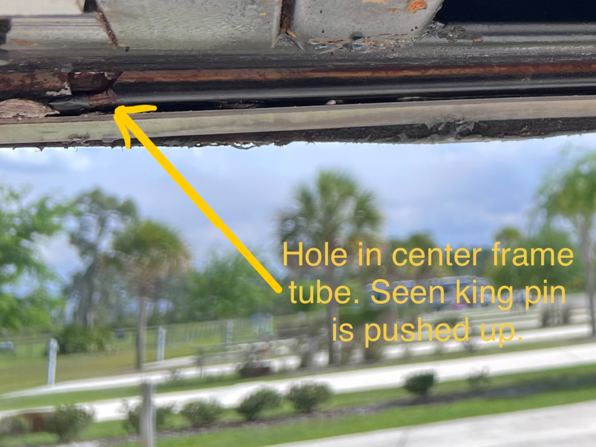

The current issue is related to the middle frame tube on the passenger (off door) side is actually broke in two places where the holes are at. I can actually move that piece by hand when the rig is not on the truck. I didn’t try it with the kingpin up but when it is on the truck that is when it comes down as in the video and slides down when it is off the truck. That is how I figured out it could be moved. I did not see any angle iron but was not looking for it either.
When the angle iron on the outside of the middle tube breaks that is usually associated with the flex symptoms and why I suggested contacting Affinity again.

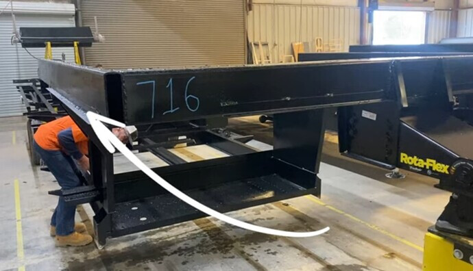

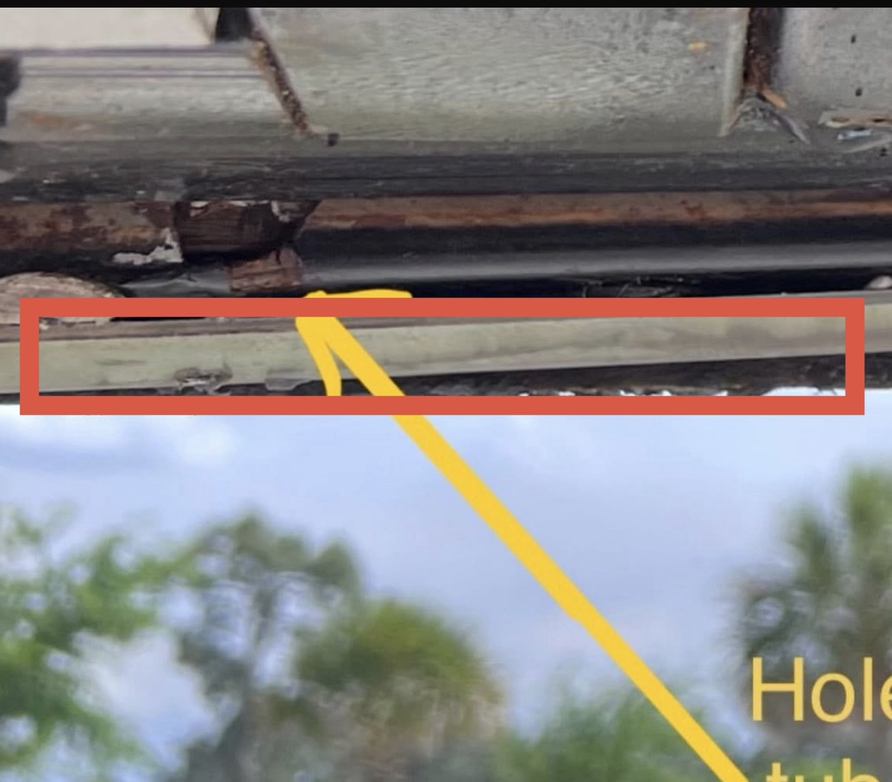

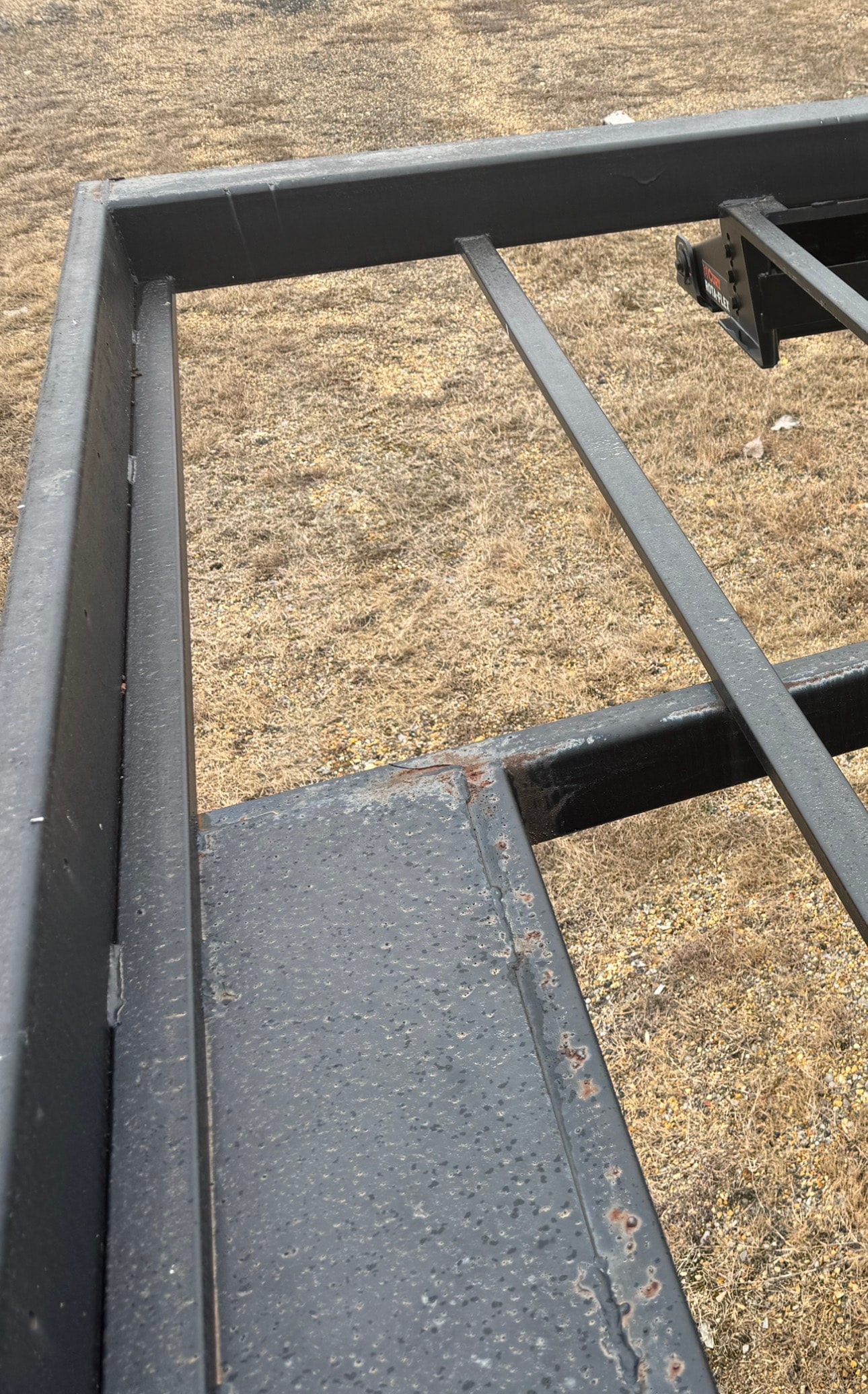

After reading your last comment and going back and looking at your pics / video I think I am seeing what you are referencing. I am not positive about the frame on a FBB but I have not seen any Vanleigh frames that have three curbside tubes - not even the heaviest unit produced being the Ambition. If looking from under the unit what you are likely seeing is the outer angle iron that supports the wall, the middle tube and then the inner support all sandwiched together. Does that seem correct?
The pictures below are pictures from a 320/34RLB frame demonstrating what I am talking about. The first picture is looking down showing that inner support (for perspective you can see the pinbox in the top right corner of the pic). The second picture is the curbside of the frame showing the tube and the angle that supports the wall.
In looking at your pics does it seem that inner support (top pic) welds have broken and you are seeing the holes into the tube which appears to be the middle tube?
This picture is what made me go down the typical flex direction. The long metal piece that I squared in your pic is attached to the angle iron and tube to provide spacing / protection between the screw heads that go up into the wall structure and protect the Filon wrap below.

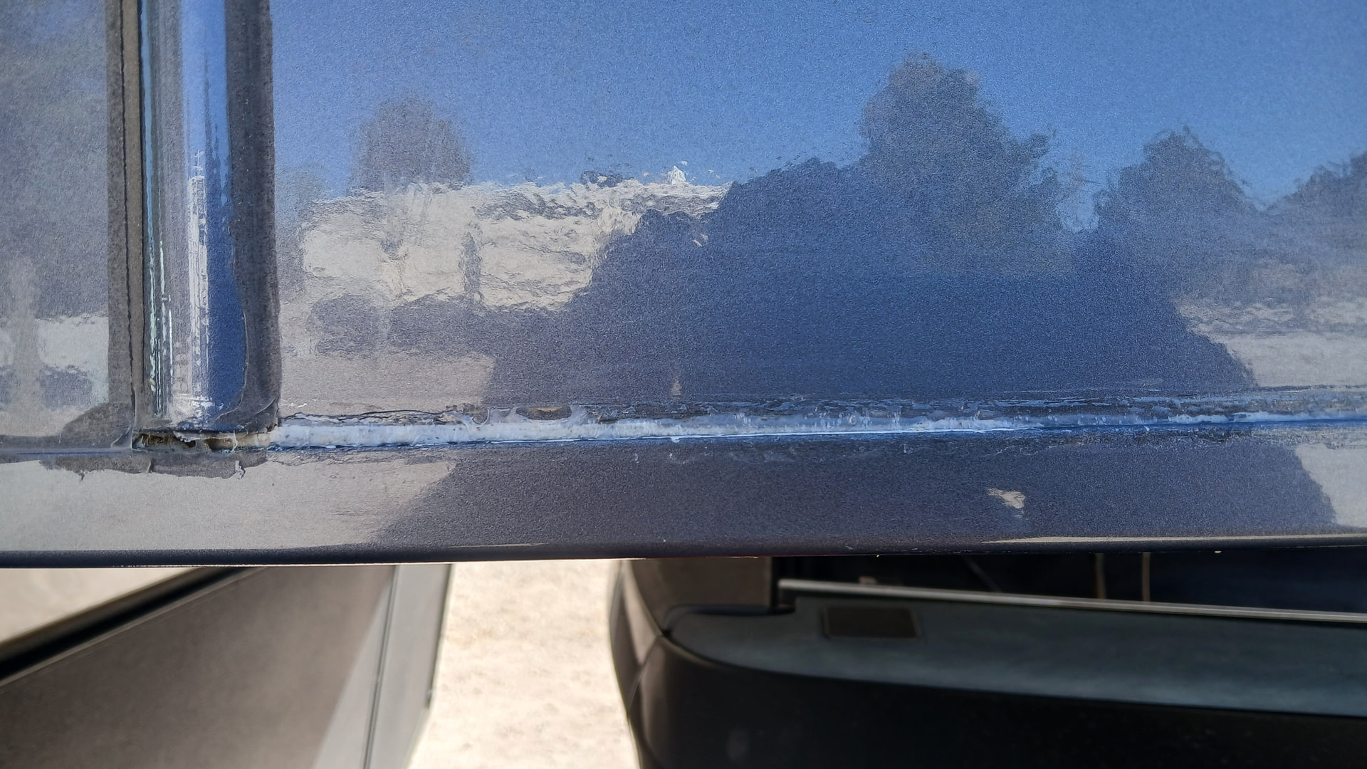

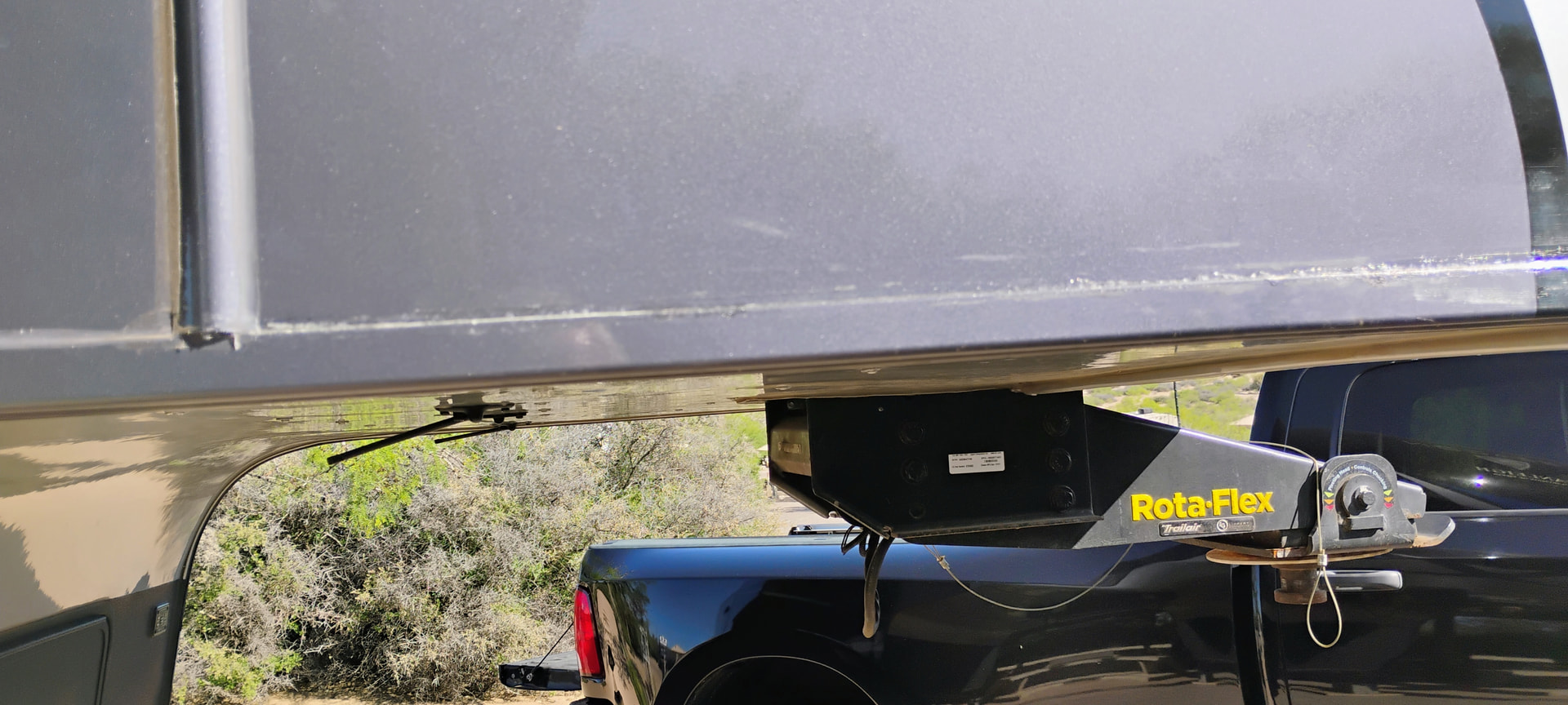

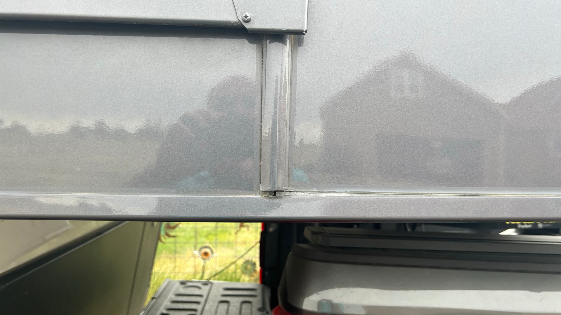

Not as bad as wererb but I think I am getting the start of a major problem, out here in Texas right now heading back to Georgia and noticed this when hooking up to truck, this is on a 39FBB on the trim piece below the closet on right hand side, when hooked to truck there is a 1/8” gap on trim where I can see a section of unpainted siding stretching the caulking out, is this something we need to worry about and call someone to look it over or can we continue maybe diverting down to Tish or Redbay to see if it is serious.
Hey Spud, that’s exactly what happened to our 39FBB.
The broken welds causing the separation and movement.
It was repaired in Tishomingo in April 2023 and is still good.

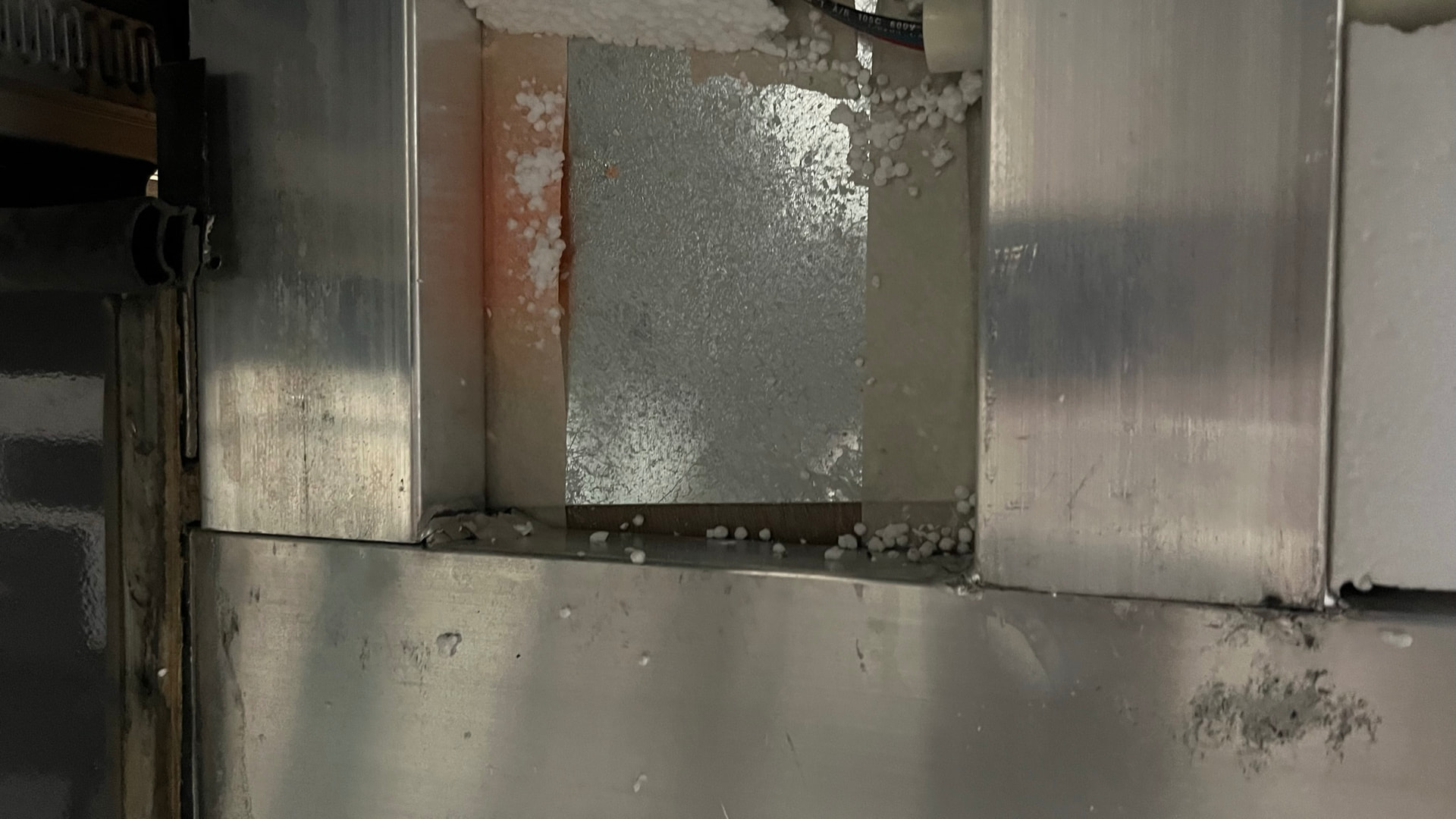

Thank you Ryan. With the pictures and explanation I see what you are saying. I am going to pull the wall down again and take another look. Thanks for the pictures Ang information.
