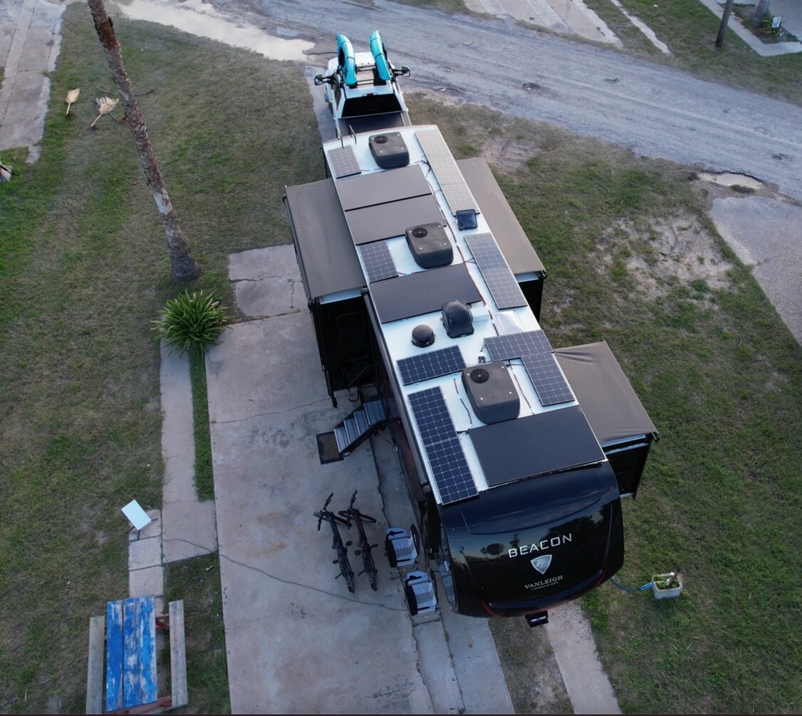

My 34RLB (Beacon version of 320) has 2700 watts up there and also had three ACs. It is all Victron with 2 Multiplus II inverters but nowhere near the battery bank that you had. We had 600aH but served us well. I am an ex IT guy so I have always been a bit heavy on power usage with gadgets I use and could have always used a bit more of a battery bank. We were primarily off grid with the last year being over 270 days without hookups and full time.
