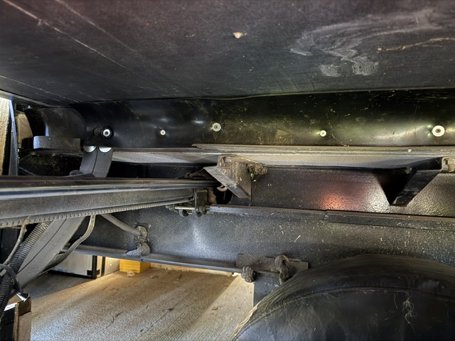

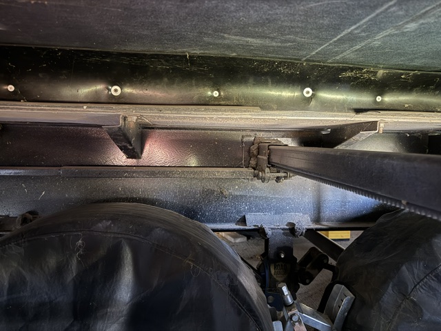

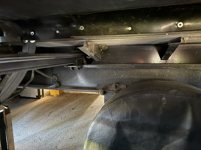

I have installed a 5” wide piece of neoprene rubber the length of the slide on the outside underneath the slide on my street side sofa slide. Before I could see daylight coming in from underneath the sofa while sitting in my recliner. I also rolled some sort of soft cloth and stuffed underneath the sofa slide from the inside to help with temperature control. The neoprene rubber works well with the sliding no problem yet. I have to remember to remove the cloth from the inside before retracting the slide. I have installed the neoprene rubber with screws and some finder washers to hold it in place. Link below for the neoprene rubber.

Could you show a photo of your 5” rubber installation? I would like to see how you installed it.
Hey Tman, I will asap, it is behind my skirting that I made. At the moment I have a water leak at or near the hot or cold water manifolds. Thank goodness for the water leak detection I have to get an early warning of a slow leak. Now I have to determine which crimp is leaking at a real slow rate.
Thanks for the photos. I may do that to my beacon.
