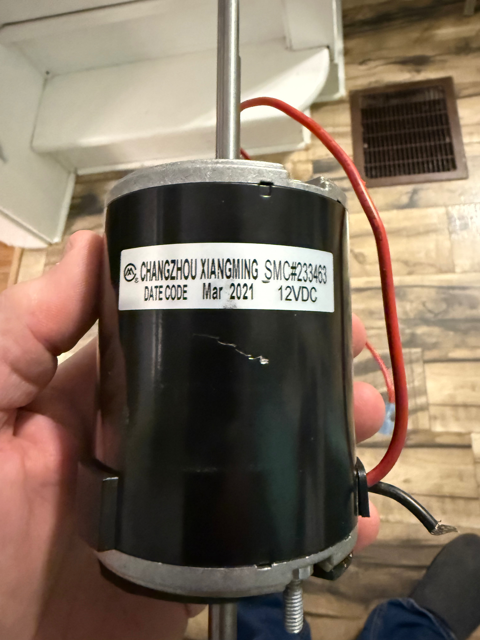

I ordered my motor from
They have a wide array of RV parts including The over temp switch, sail switch etc. They will verify your model number making sure you order the correct part. My motor was $99.00 with free shipping. I went with aftermarket because Suburban is using the cheapest they can find obviously it failed early.

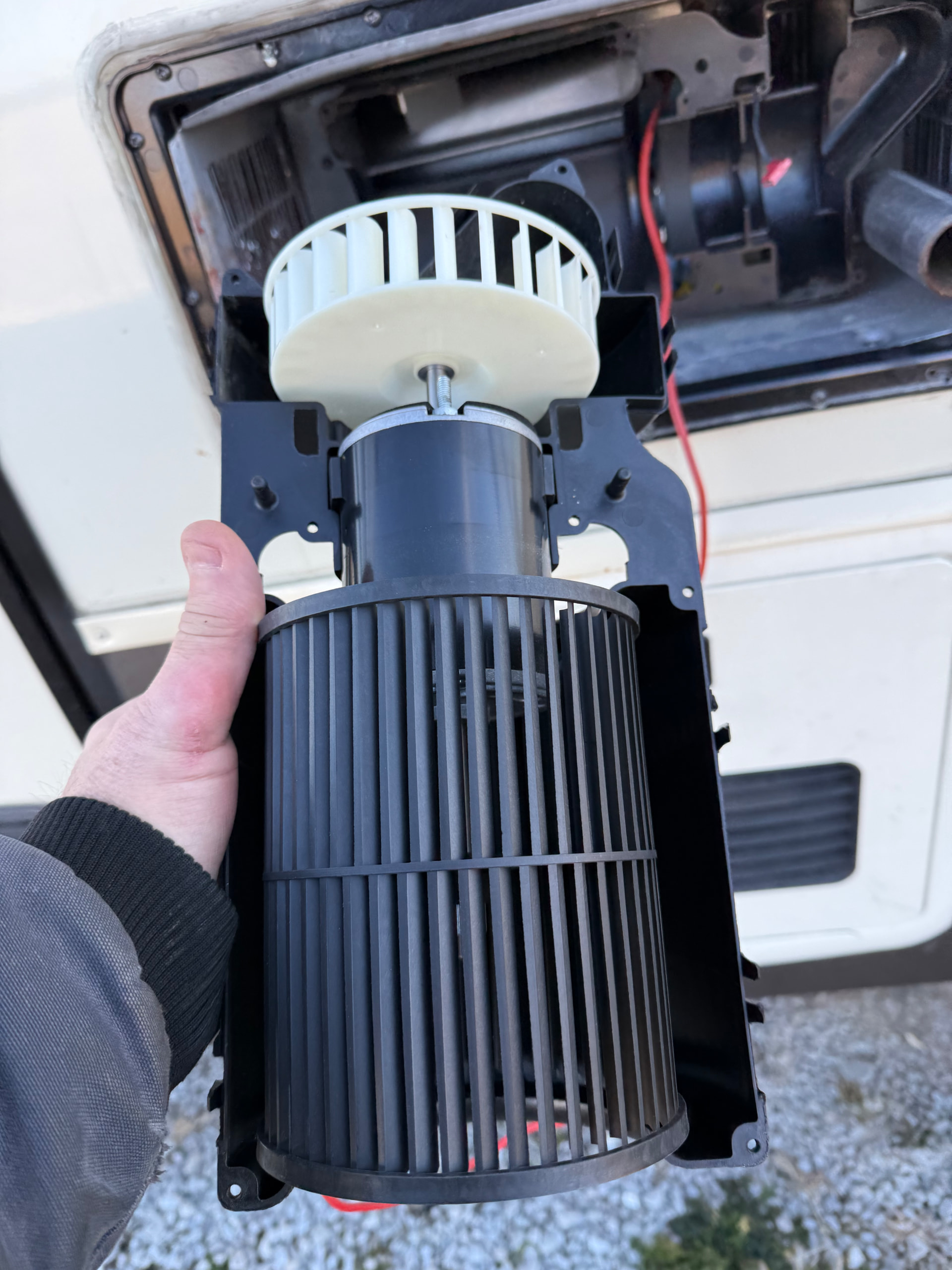

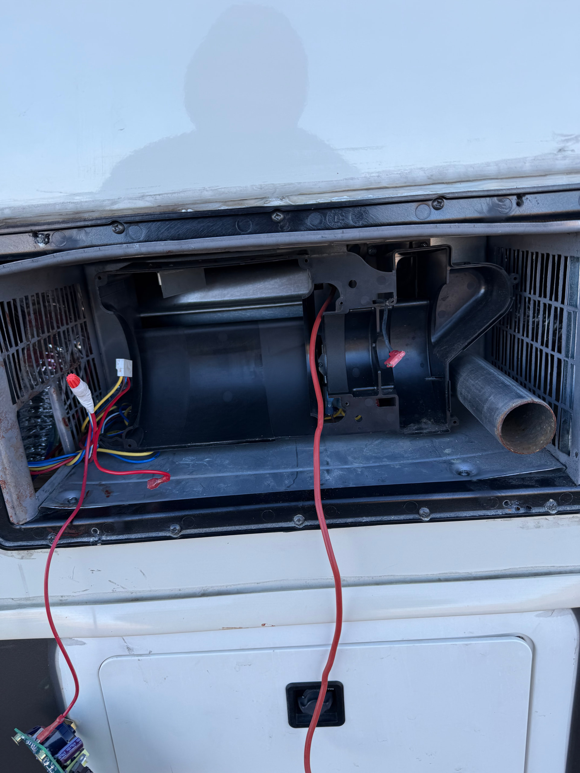

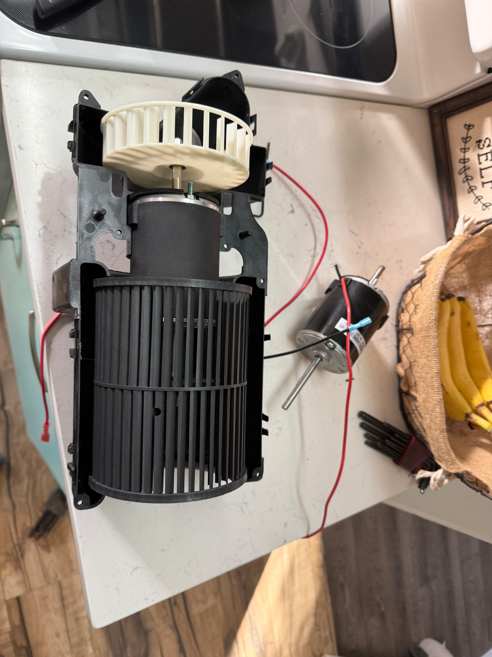

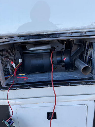

I removed the blower assembly today and replaced the motor. Furnace is working perfectly.
one note: The SF-35VHFQ blower housing only has 2 screws and then several plastic locking clips. The clips will likely break. All of mine did: Mainly because I did not want to remove the furnace from the RV and then remove the inner core from the case. If you do that you can easily get to the clips. That would have been a lot of extra work and its really not necessary. If the clips break: The good news is there are 5 unused screw holes from the factory to install screws. In fact, If you order a motor from Suburban they now include the 5 screws. I went with an aftermarket motor so I found some small screws in my stash and installed in the factory holes.

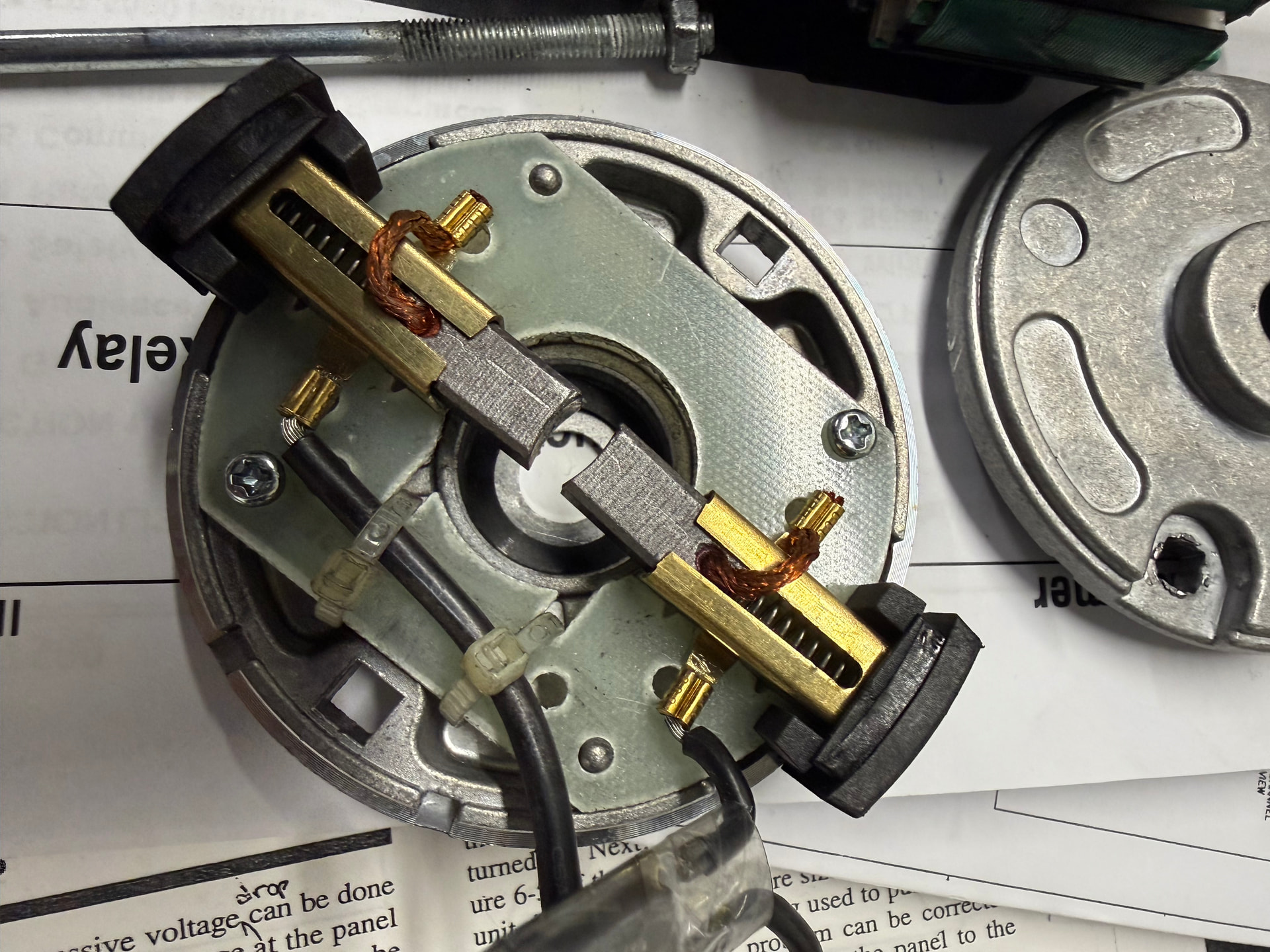

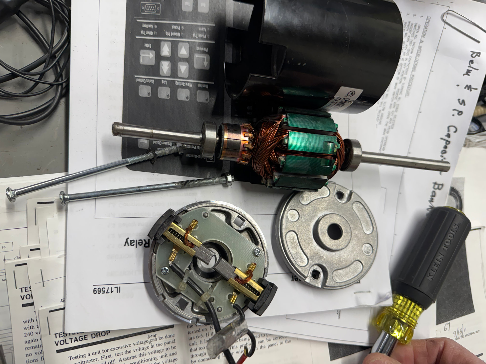

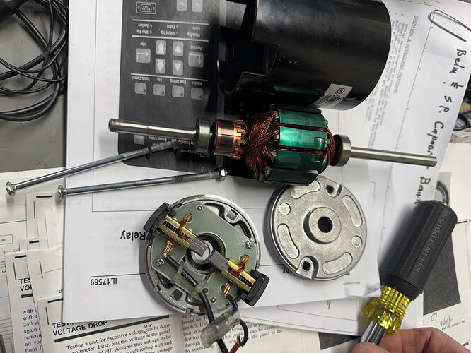

I took the motor to work today and disassembled it. I wanted to see what the issue was. As suspected the issue was in the brushes. The brush on the negative wire was stuck. Both brushes were not sliding free in the brush housings. We tweaked the housing just a little with a screw driver to make more room and put the brushes back in. We had continuity when we put the assembly back on the shaft. The windings are all ok. My electrician here at work loves things like this. He is going to carefully reassemble the motor and test run it for fun. There really is no reason it shouldn’t run. Basically the tolerance is too tight on the brush housings and as the carbon dust from the brushes accumulate the brushes bind and lose contact with the commutator surfaces.
If you look at the carbon brush on the left you can see a line in it where it was scraping the housing.
We fixed the motor. We soldered all the internal connections and opened the brush housings just a little for smooth action. It ran good when connected to battery.

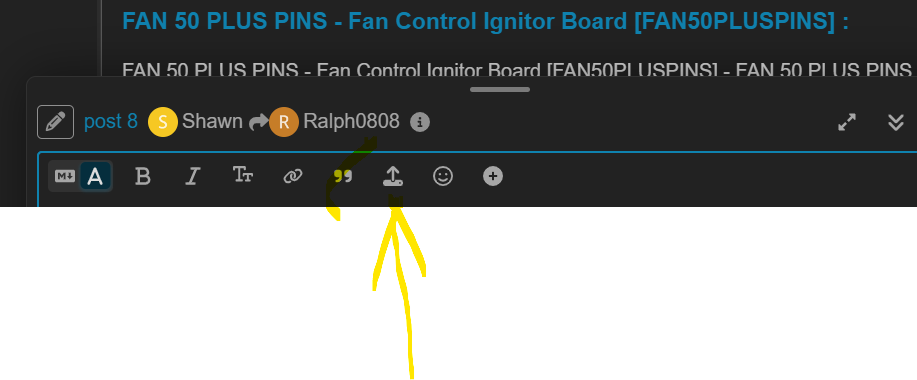

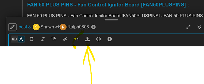

I also need to ask how to add photos to a post here on the forum?

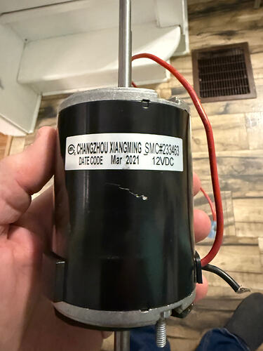

I ordered my motor from RV Parts & Accessories | 20,000+ Products In-Stock | RVupgrades.com I ordered the $98 aftermarket motor for my furnace I asked them to let me pay 99 for the motor to get free shipping and they did the price adjustment.
I did have to file the flat part on the shaft about 1/4” further down so the blower wheel would sit centered in the correct position. It was easy modification, But worth mentioning. I used a 1/8 inch cutting disk on my angle grinder and gently cut it back.

For photo uploads I see a icon with an arrow. See photo.
